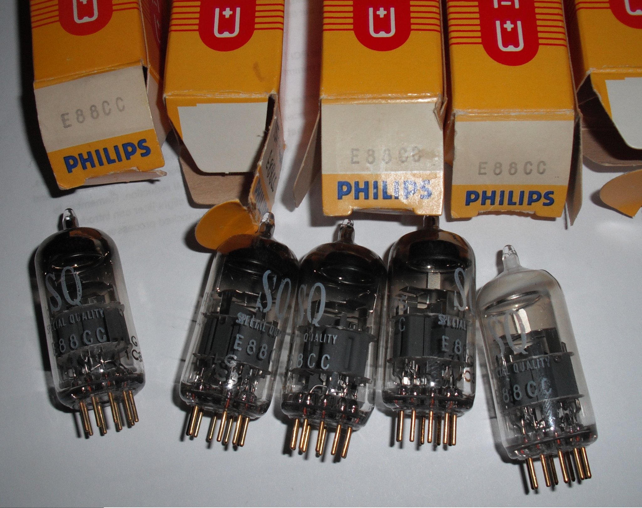

That is absolutely correct. I heard about this tube years ago and started to read up on old tubes, this one is special. At least the web is full of people that speaks highly about this tube.E88CC is the Special Quality (SQ) version of ECC88 which was meant to last 10,000 hours. Gold plated pins so bling bling too.
The Philips E88CC SQ is a tube that beats every other preamp tube there is. It lasts longer, has zero microphonics, its gold plated pins is for a reason.
Gold is bling, no doubt, but them pins are gold plated for a reason.
Gold don't corrode, loose connections will hold longer than other metals since gold makes good molecular binding even in a loose connection.
Audiophiles love this tube because it is amazing as an A.F. amp. ..funny thing is that it was never meant to work with audio frequencies at all.

I have 4 Philips NOS E88CC SQ in my collection.. 20 years ago, my boss told me to clean out the old electronic repair shop and throw all the tubes in the garbage. I did not. Got a box with 300+ Philips tubes and 30+ from other producers around the world. Was 5 E88CC's in the box but one had cracked glass and was destroyed. All white on top.
A lot of the Philips tubes was P-series that don't use 6.3 volt on filament, but higher voltage. Built a Marshall jcm800 preamp (I copied the original circuit) with ecc83 and a single ended output with a Philips NOS PL84. Those need 15 volt on filament and was meant to be working as A.F. in Philips TV's.

Old tubes can break your heart. The one on the right in the photo has gone gassy. Getter flashing has turned white. Some old tubes just go supernova and draw a lot of current, even if they don't go gassy. Shorts perhaps?
There's no guarantee an old tube will have low microphonics. I sold off a bunch of my USA Amperex 6922 tubes. I did tell the buyers they weren't suitable for phono stage use. They also sounded harsh to me.
If you want to experiment on a budget, get some NOS Tesla (not JJ) ECC88s. There seems to be lots still around. They kind of have the Mullard Blackburn rockem', sockem' vibe, for a whole lot less money and in my experience, tend to be non-microphonic. If you fancy the Philips Heerlen soft-ish sound try some JJ E88CC.

Yea, you are right about that. When I got these tubes I did not know much about the technology.Old tubes can break your heart. The one on the right in the photo has gone gassy. Getter flashing has turned white. Some old tubes just go supernova and draw a lot of current, even if they don't go gassy. Shorts perhaps?
All the E88CC tubes are brand new, they have never been in a socket after they left the testbench at Philips. I have no need to start experimenting with them. The one that have drawn gasses have a visible crack in the glass that cant be seen in that picture, but it came out of the box like that.

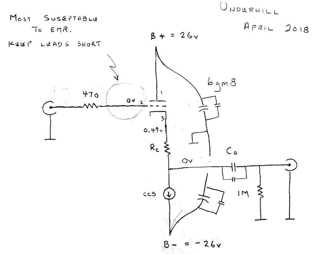

For someone building their first tube preamp / buffer , I highly recommend they see if they can find a ecc86 ( 6gm8 ).
This is a low voltage tube , that has a maximum plate voltage of 30 Vdc .
Any voltage above 48 Vdc , can be lethal , so tracking down 6gm8's may be well worth the effort .

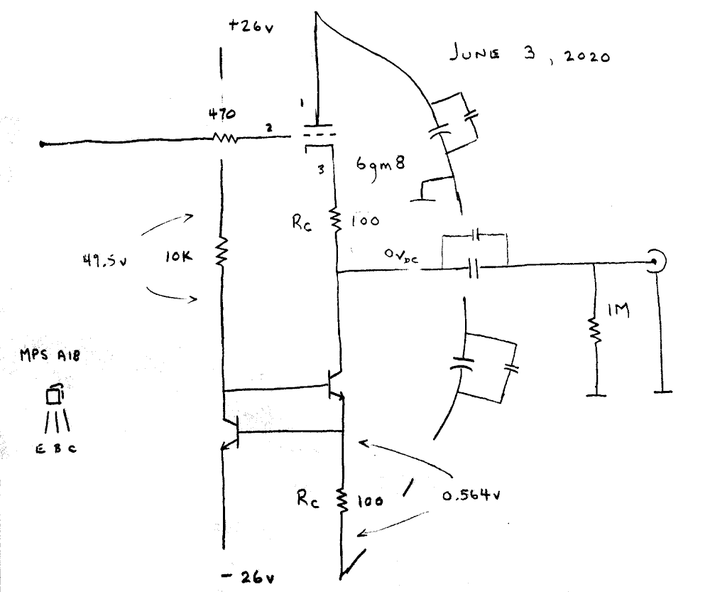

The concept I used is a cathode follower with a the CCS that sets the bias current.
The great surprise is how much the CCS affects the sonics. After building a number of versions of CCS,
my favourite by far is made by back to back MPSA18 's.
The one draw back to this circuit is that a tube takes about 12 seconds to warm up , and this is mixed in with transistors ,
so Vout hits one of the voltage rails until the triode warms up .
However, only 1 ecc86 ( 6gm8 ) is needed for both the L and R channel .
However, I haven't tried a tube CCS , but a pentode is required for this .
IMO where the Q point is on the load line , has quite an effect on the sonics .
Pushing an ecc86 ( 6gm8 ) with a plate voltage up to 26Vdc and I = 5.6 mA sounds pretty good .

So here is a load line calculator , which I highly recommend people try .
https://www.vtadiy.com/loadline-calculators/loadline-calculator/
For a 6gm8 , setting the plate voltage to 26 Vdc , using the load line calculator , a good bias current looks to be about 2.35 mA .
But the cathode follower circuit with a CCS sounds great when the bias current pushed up to 5.6mA .
Any ideas what is going on ?
Also recall , the small signal parameters for a triode change with the bias current .
Data sheets provide a graph of the small signal parameters for a ecc88 / 6922 ,
but I can't find a graph of the small signal parameters for a ecc86 ( 6gm8 ) .
