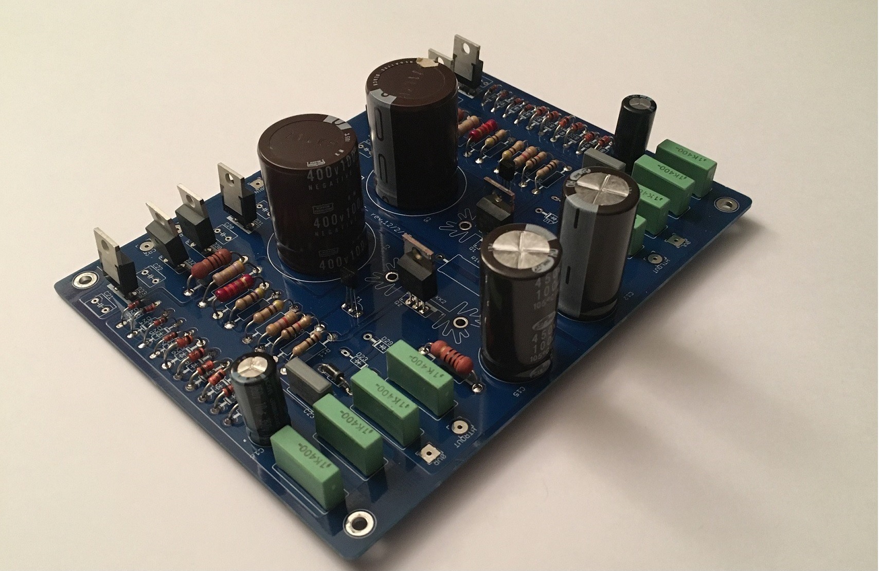

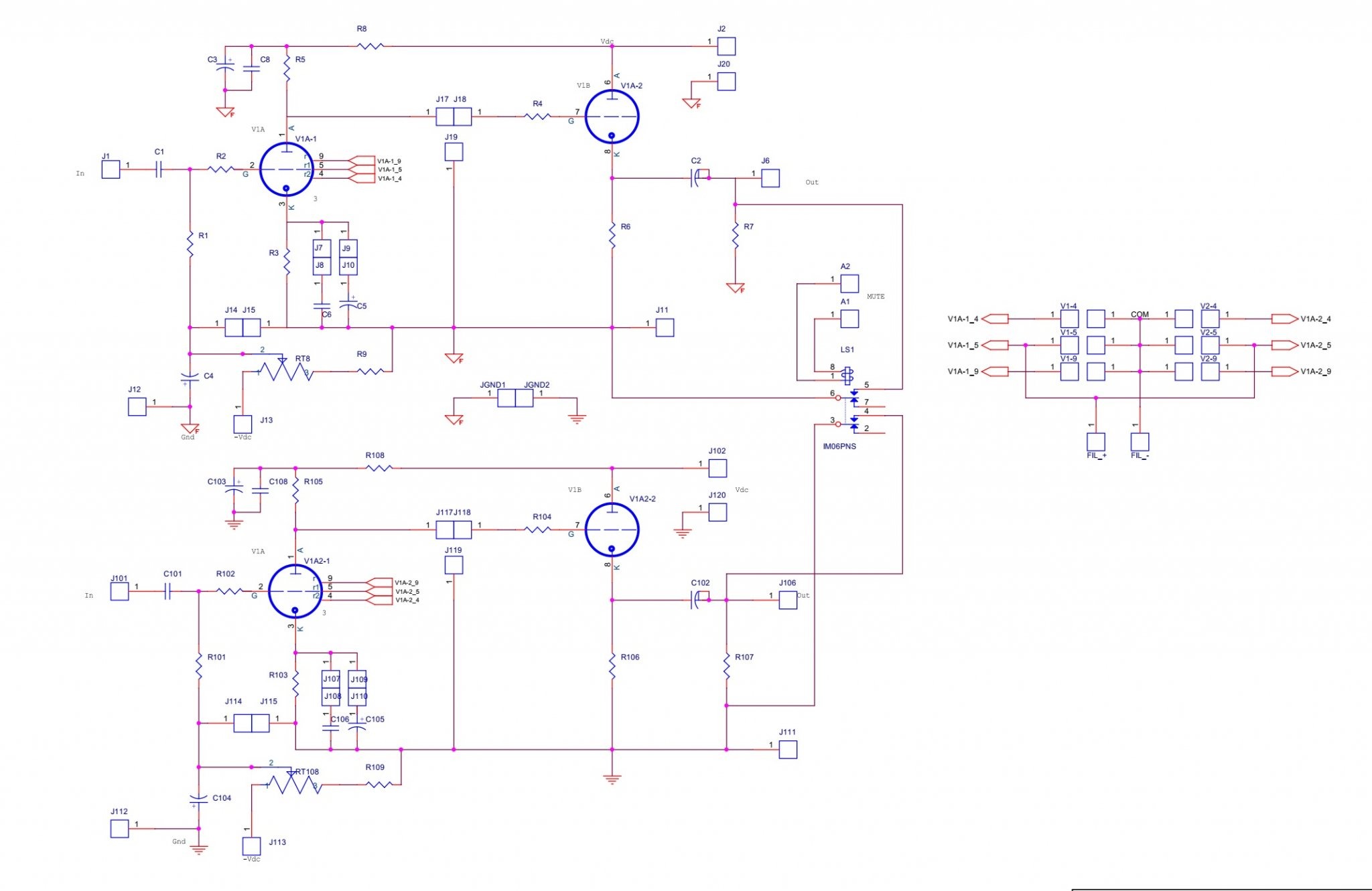

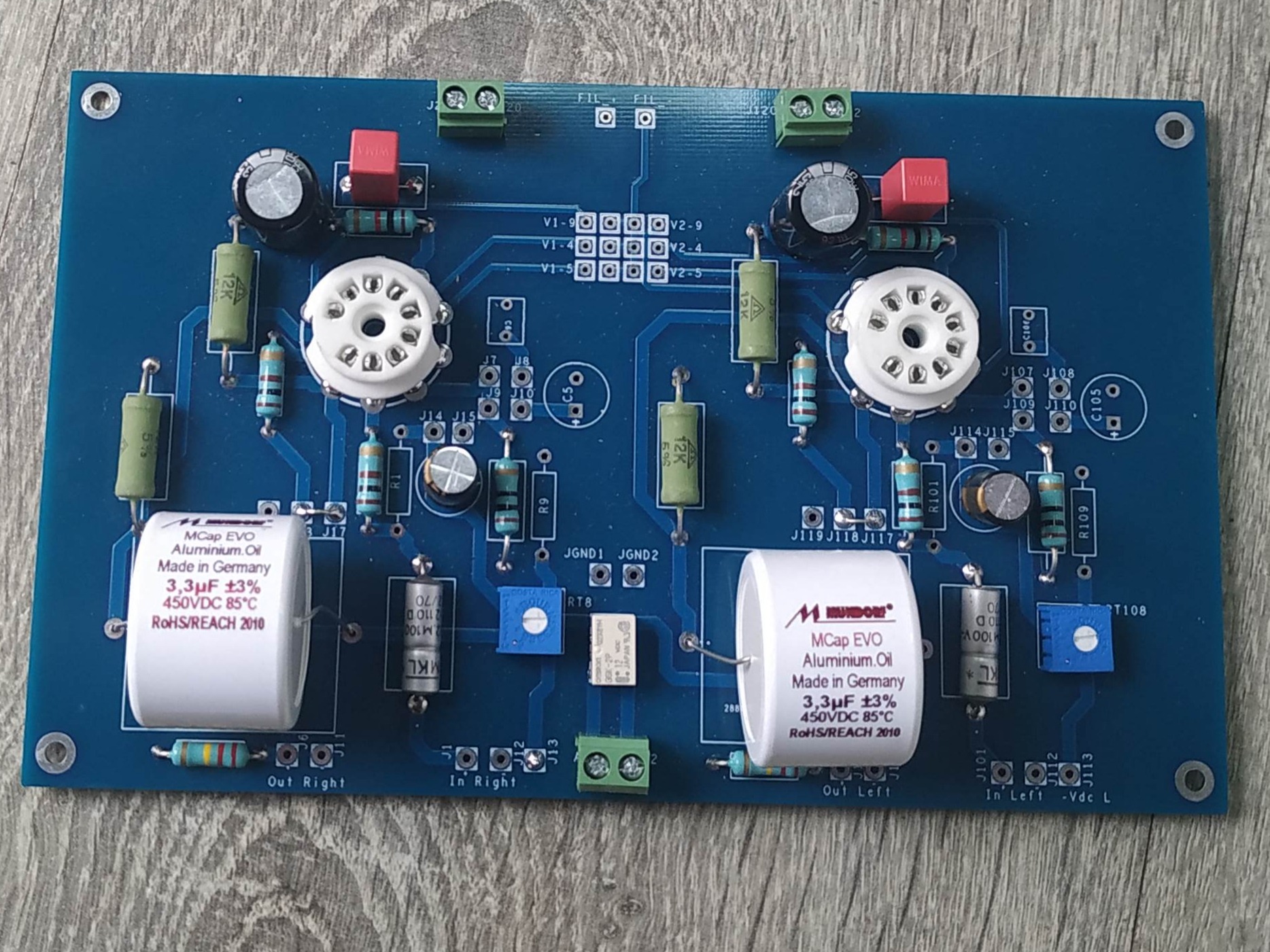

I have published a project of a line premap on Audioreview in Italy; it is simply but efficent
And I developped some pcb.
This circuit has some point where i possible to select fixed bias or autobias; in addition there is a matrix to change the filaments to use 6DJ8/6N6/6H30 or 12AU7/12BH7/ECC99; there is an option to insert also a tone control
In addition there is the possibility to have an HT ss stabilized board; it has two channel compeltely separated and regulated.

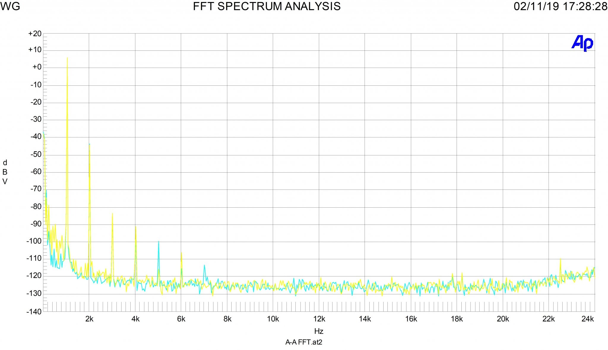

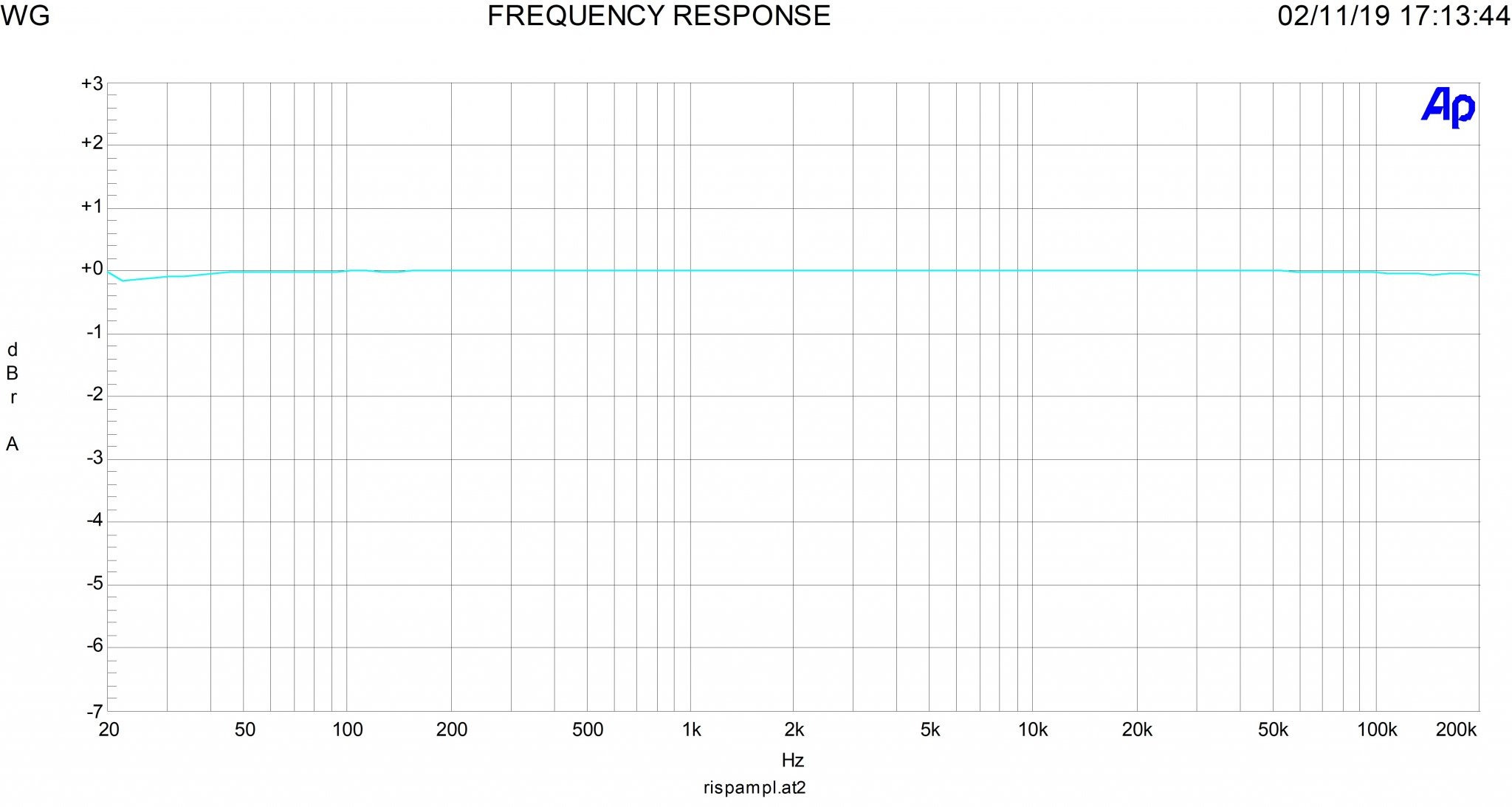

@waltube Could you please also share the schematic with values? Can this scheme used as tube preamp? What are the measurements for harmonic distortion %, typical THD at 1W, PSRR and input sensitivity and max output V rms? :)
It is a Line preamp with the possibility to use different tubes changing the matrix for filaments and just two resistors ( in case).
Alsom it is possible to use a fixed bias or autobias.
In attach the lab test
The freq. answer
The FFT

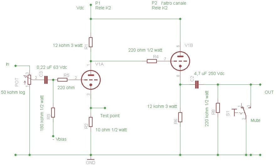

The schematic with 6N6 double triode and fixed bias
The Vout is 2 Vrms, The Thd is around -50/-55 dB depends on tube selection

Thank you! Do you have idea how to get these THD numbers lower? If I like to use 6DJ8 tubes then what values I need to change in this scheme?
Hi
At 2 Vout the THD is quite low; with 6H30 will be better
I check for ECC88 leaving the same R value and it works fine; if you use fixed bias you can play with negative voltage fixing a good point.

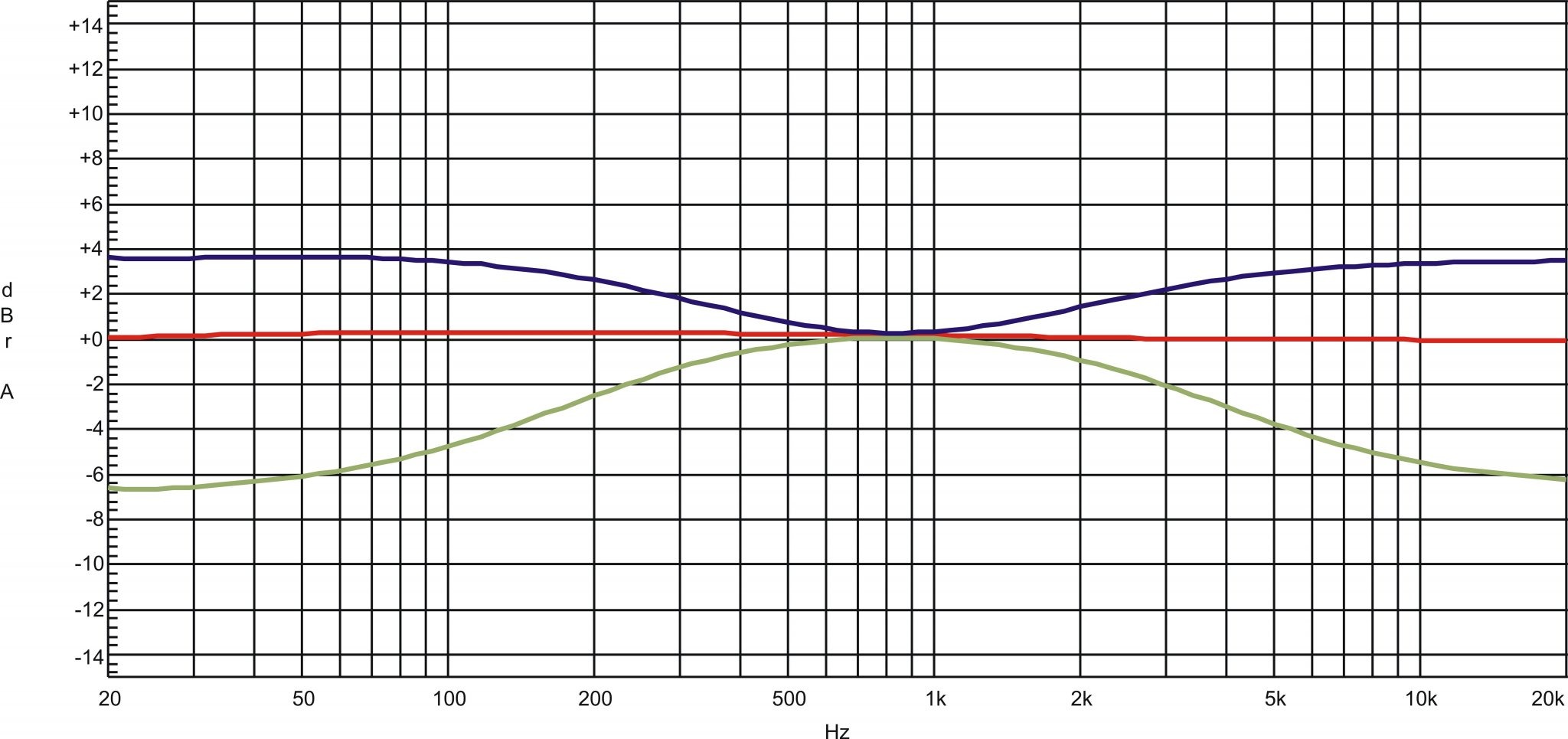

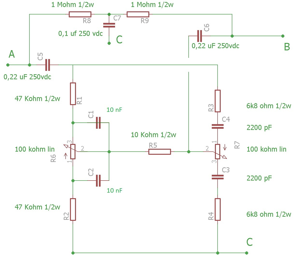

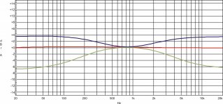

In addition is possible to insert a tone control just connectin 3 points/channel; I made a little pcb
