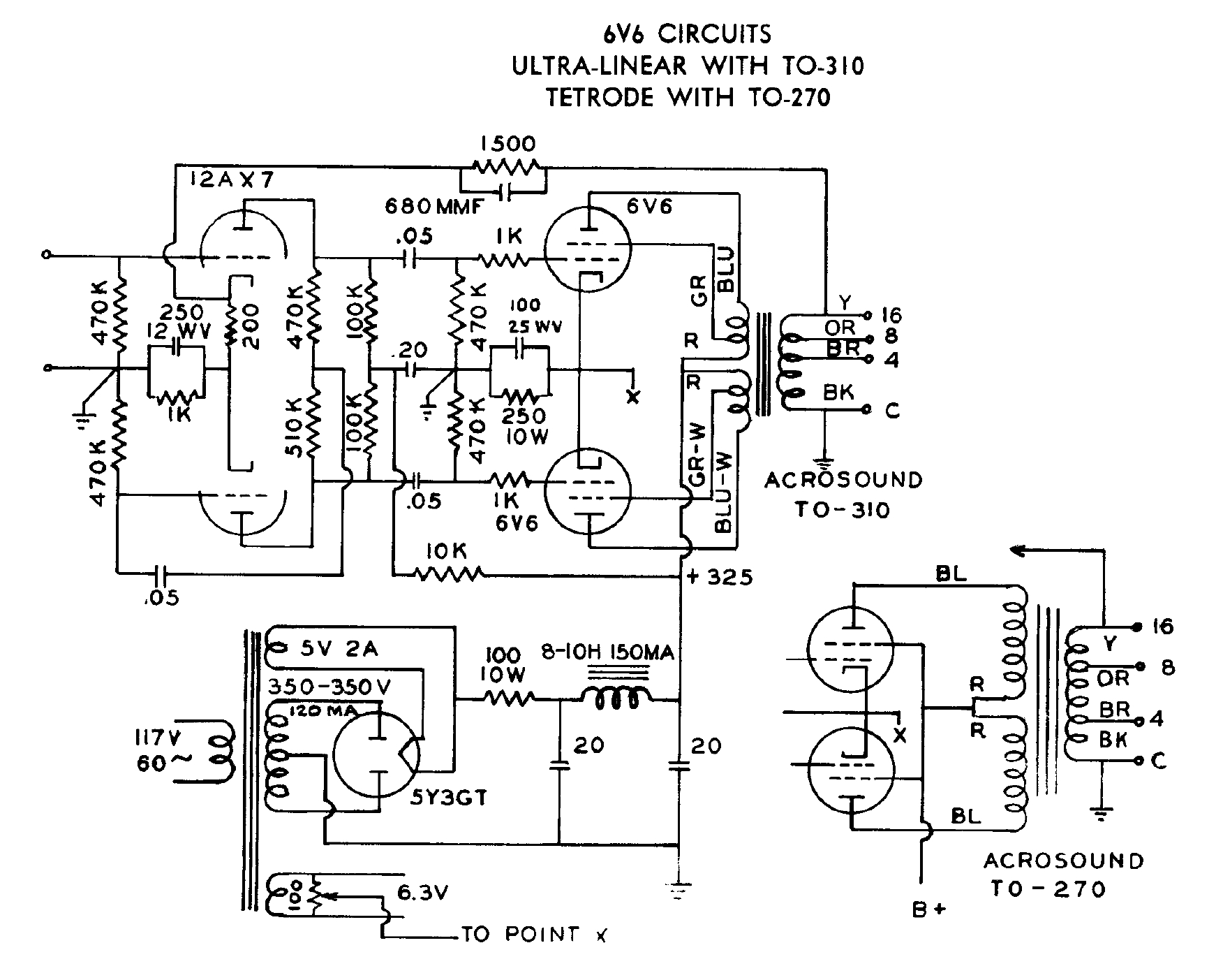

It gets more interesting. Remember that first amp I mentioned? Compare it to the 6V6 design below from an old 1950's Acrosound catalog. It appears in both cases the author retained the original circuit almost verbatim, with an updated power supply and only minor changes to the circuit - mainly 12V cognates and/or slightly different driver tubes. In hindsight, each one of those builds would've been a more enriching experience if it had been more apparent these were updates of proven designs (again, not an indictment, but I wasn't an "old-timer" in the hobby at the time).

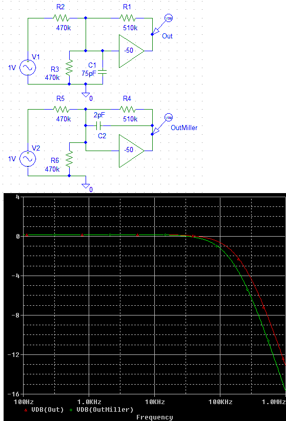

Post #24 schematic:
This is why I do not like "serial phase splitting" (or whatever it is named). The second grid (bottom grid in the schematic) of the 12AX7 is driven by 470k and 510k in parallel.
I estimate the gain of the 12AX7 triodes at about 50. The plate to grid capacitance is about 1.5pF, and with the miller effect, about 75pF. The 470k and 510k resistors and the 75 pf has a -3dB bandwidth of about 8.5 kHz (on the second 12AX7 grid).
That means for frequencies at and above 8.5kHz, the amp is effectively Single Ended. Negative feedback does not fix that. The lower grid is always driven by -3 dB at 8.5kHz (and worse as frequencies go above that).
.... -3dB bandwidth of about 8.5 kHz...
Negative feedback does not fix that. The lower grid is always driven by -3 dB at 8.5kHz...
NFB does fix that. Simmed twice. Both use gain of -50. Once with your 75pFd grid to ground, then to be sure a rounded-up 2pFd in the Miller position. Response is -3dB beyond 100KHz.
An alternate interpretation is that the 1.5pFd is in the same place as the 510K. 1.5p against 510K is 208KHz.
(I did re-run it with 39K series added to the outputs to emulate a 12AX7 plate circuit impedance. No change to 2 decimal places so I did not re-capture the plot.)
