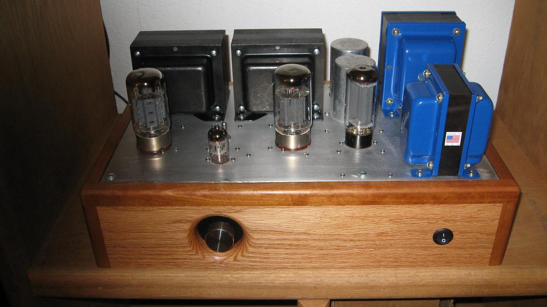

6550 SE Amp, Revisited
1) Try using fixed bias for the 6550 instead of cathode bias.
2) Run the 6550 like the data sheet suggests in pentode mode: 400 volts on plate and 225 REGULATED volts on G2. Use 3 0A3 regulator tubes in series ( or other VR tube combination) to get the regulated 225 volts for G2.
3) Improve driver as mentioned above.
This will give you an amp that will sound more to your liking.
Excellent eye! You know, I'd have to rebuild the circuit to see if that 470k resistor was the culprit. But to me it's just not worth the effort; there are much better designs out there with a similar topology.
It gets more interesting. Remember that first amp I mentioned? Compare it to the 6V6 design below from an old 1950's Acrosound catalog. It appears in both cases the author retained the original circuit almost verbatim, with an updated power supply and only minor changes to the circuit - mainly 12V cognates and/or slightly different driver tubes. In hindsight, each one of those builds would've been a more enriching experience if it had been more apparent these were updates of proven designs (again, not an indictment, but I wasn't an "old-timer" in the hobby at the time).
Boy, do I feel like a stooge.
That 12V6 amplifier sounded incredible though. I used OPTs from an old Heathkit AA-151 my brother found buried in an old junkyard. I wound up giving it to him as a gift years later.
