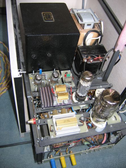

Speaking of pictures, I took one of the ‘standard’ 6336-SE before I started to modify it. I have long hesitated to do this as it sounds fine as is.
In the picture you see the following:
- one of the monoblocks
- the hoods for the iron and for the tubes areas are removed
- modular, three dimensional and open way of building. The classical two dimensional layout did not really fit in the cabinets (30 x 50 cm) that I have made near the speakers. The open structure allows for lots of air flow.
- because driver and output stage are mounted on aluminum, decoupled strips it is really easy to take them out/put them back and modify components
- all iron is decoupled with teflon strips/bitumen and isolated. The big potted mains transformer is a Bartolucci. The open one is for all heater currents. All capacitors and the OPT are below. Driver stage and output stage have their own power supply.
- all tubes have their own AC-heater
- the switch on is delayed: first all heaters are each passed by via a resistor. Without it especially the 6336 would ask over 12A/6,3V at switch-on. After 30 seconds resistors are switched off. After one minute B+ is switched on. First with a bleeding resistor to dampen voltage because of C/L/C loaded supply. Then the bleeder is switched off. The leds in the middle allow monitoring and switching to/from standby.
- all signal and DC wiring is teflon solid core (this requires care to double and tightly secure each wire end).
- right/front are clips to monitor all heater currents.
