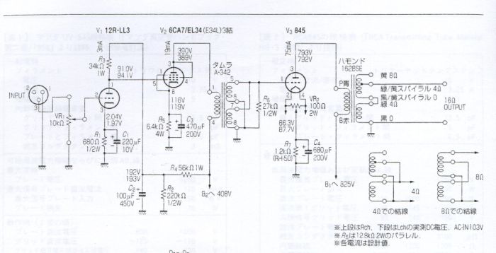

Hello,
Time to start with the first step to improve the driver stage as indicated in my last mail.
I found an example of how to connect an EL34 for the Tango interstage NC-14 interstage (5k, 30mA,1+1: 1+1). It is a schematic of the Japanese MJ-magazine of 12/2003. I attached the schematic. The plate of the EL34 is connected through the primary in series at 408V/19mA. The feedback part I will leave out for the moment.
The secudairy is wired in parallel for an 845. So this way I should have enough drive for the 6336A. Contrary to the direct heated 845 however in my case I will need a grid resistor to bias at some 90V. I will leave the original grid resistor and the cathode resistor of the 6336A for now.
One more interesting thing in this schematic is that the first stage with 12R-LL3 and the driver stage are direct coupled. This can be my next step in the experiment. Would there be any risk of direct coupling in my case? I wonder if I can substitute the first tube with something more familiar like a 6BX7. Have to look at the datasheet first.
Any comments before I start soldering?
Best, Arjen

Hello Ben, others,
The standard Mu-stage is easy to find. I have searched for a schematic of the Alan Kimmel's choke assisted Mu stage but was not succesfull yet. Could someone provide a link or a schematic (off list if necessairy)?
Best, Arjen.
vrhff04_@_xs4all.nl
Hello,
I did find a description of Alan Kimmel's choke loaded mu stage at the audioasylum site:
http://www.audioasylum.com/forums/welborne/messages/3763.html
In a next post of this thread by twystd (A) on January 05, 2004 the modification of the original version is described as: ‘First buy a pair of Lundahl 1668 chokes, I mounted mine on the sides of the wooden basses away from the signal part of the amp for EMI reasons. Then jumper pin 2 and 4 together on the choke (pin one being furthest from the mounting base, pin 4 closest to the mounting base). Remove R4 and replace with the choke, pin 1 on the choke going to the cathode of the 6AC7 and pin 3 going to the plates of the 6SL7. Remove C2 and replace with a jumper. Remove R6 entirely, then replace R7 with a jumper. That's all there is to it. You said you tried other mods, out of curiosity, what were they, and did they work for you? ‘
Allthough it is not a schematic yet one could work out one.
Best , Arjen

av-trouvaille said:
Hello,
Best, Arjen
I would use an easier to find tube in the first stage. If much gain is needed, a triode wired C3g would be nice. Any other high gm pentode with 3-4 watt Pa will do.
The direct coupling loftin-white-like is not safe. If the second stage comes before the first has reached it's operating point, the grid sees the full PS voltage. Nice firework and possible damage of the second tube.
I use a seperate negative supply for the first stage with an anode choke as a load. The anode choke is grounded, so in the worst case, the following grid has about 10 volts higher than it schould be. It adds cost, but i built only 1 amp and 40-50 euros is not an issue, compared to the total costs. Of course, if it's a commercial product, things change.
You don't need fancy tango or whatsoever anode chokes. Go to any transformer manufacturer and order about 2x4500 turns of 0,15mm wire on a dual EI84a bobbin (this is essential). Gap with 0,05mm per leg - enough for 15mA DC.
Even with the worst quality iron (max 1T) this will give you about 140 H with low exitation - 0,2-0,3Vrms and >160 for 5Vrms. Self capacitance is about 100pF (dual bobbin), that's 80Kohm / 20kHz, negligible for a valve with 3-4Kohm Ri.
I pay for a pair of these about 20-25 euros - depending on the mood of the winder. Tell the winder to put isolation every 4-5 layers, otherwise it will "sing". The small local business usually do not impregnate transformers 🙂
A nice side effect is that you now need to drop only about 25-30volts with your cath0de resistor of the EL34- 2watt less heat.
By the way: EL34 is overkill. A 5687-6N6 is enough and has more gain. The only problem i see, is that you need at least 60-70H pri. inductance in the IT, but with ca 8-10mA DC.
Greetings
Konstantinos
PS. The direct coupling with a choke as an anode load was described in Glass Audio. I can't recall the issue, but the title was something like "safe loftin-white".
The anode choke i described is exactly what i use with 5687 and the like valves (Ri about 3k, current 10-15mA) and the values of inductane and capacitance are measured, not estimated from the formulas.
I forgot to write that with the mod i proposed, you have to use a 300v supply instead of 400 for your EL34 to stay with the operating point of the schematic .
This doesn't mean that i think 270v/20mA is a good operating point for the tube- quite the opposite. But the design is compromised. A better op. point would be not practical - higher PS voltage, more heat dissipated from the cathode resistor, recalculated op. point of the first stage - possibly a worse one, etc.
Of cource, wenn i say that the EL34 is an overkill, i mean for your output tube, not for the 845 of the japanese circuit.
Regards
Konstantinos
