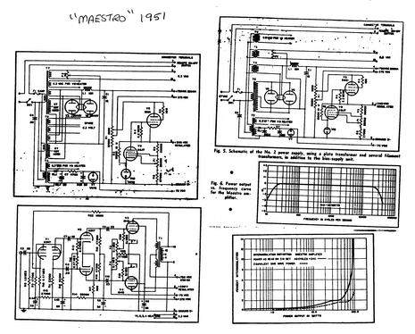

I just came across the attached schem. Simple 6146 pp from 1951. It looks like just what I had in mind when we started this thread.
Have a scan and let me know what you think, please.
Do either of you think that the trafos will be hard to get, or will std Hammonds work here?
It is far higher power than I was after but I have never been sorry for having more power 😎
Cheers
Jess
BTW: I had to resize (shrink) the original schem to attach. If you would like the full sized one, email me and I will send it along

This should work well with modern transformers, if you can find a combination of off the shelf transformers that can provide the necessary voltages. I can't quite read the details, but do you have the impedance specs on the output transformer?
In any case DO NOT install the capacitor shown that connects one side of the power line to chassis ground. That used to be common in the past, but 55 years of shocking experiences have told us that it doesn't work. Use a 3 wire cord and ground the chassis.

Doesn't seem to be any trafo specs that I can make out. OPT seem to be ct primary, 3-tap sec - pretty normal. The plate DC on the schematic is 750V, with B+ at 375v
As said, I have the detailed hi(er)-res pix if you want it.
:cannotbe: Got it! Actually, I have a lot of listening to experienced fellows like you before I begin to build something like this.
BTW: is that a REGULATED ps?
The plate voltage is not regulated, but the screen voltage is. This is exactly what you need with these tubes.
Lacking impedance data on the transformer in the original design, you are going to need an educated guess. The plate voltage of 750 is the max for this tube with this voltage you would need an 8K ohm transformer and get about 100 to 120 watts. Hammond does not make this transformer, although it could be found. If you don't need this kind of power I would use a lower plate voltage, and get a lower power output. Your tubes will last longer.
At 600 volts you would get over 90 watts with a 6K ohm transformer and 80 watts with a 7K ohm transformer. The higher impedance transformer offers slightly lower distortion to go with the lower power.
At 450 volts you will get 60+ watts with a 4K ohm transformer, and 50 or so with a 6K transformer. Same story with the distortion.
So you need to pick a desired wattage, or a close guess. The higher power requires more money in transformers, and power supply parts. Then you can pick an output transformer.
Hammond lists 3 transformers for use with a pair of 6146's. To squeeze the most power from a modest power supply, use the 1650N (4300 ohms) run it at 500 volts or less. The 1650P (6600 ohms) would offer less power in the same amp at lower distortion. It could also operate at up to 600 volts to get more power. If you have the space and the money the 1650R (5000 ohms) would provide the most power and could provide 75 watts at 500 volts.
If this was my choice, and a first amp. I would use the 1650P and set up the power supply for something between 425 and 465 volts using 500 volt capacitors. Any higher voltages get more complicated quickly. You could expect 50 watts or more from this combination.
Hammond only makes one transformer that has the power capability to adequately support both channels drivem to full power. That is the 278CX. It does not have 5 volt windings. You could use a SS rectifier, or extra transformers. The voltage might be over 500 with SS, you would need HV caps.
If you don't plan to run the amp at full volume a lot (I don't think so) you could use a smaller transformer. The other possibility is a seperate power supply for each channel.

As stated, raw power is not a priority. 50-60w is PLENTY! But, I am not clera on the relationship between trafo impedance and distortion. Do you know of a reference on the subject - or a reading list? This interests me.
