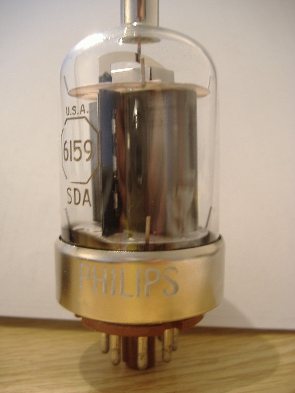

6012 ---6146---EC360
Hi Folks,
On my previous msg I planned to built 6012 SE but sadly this tube asking a verry big Current 230mA/ch on 250V since I don't have any stock of big current the Power Trafo, I decided to change the project to reBuild & Improve the EC360 SE due to this "Real triode" power tube is so cheap in my local shop(only $20 each) & Now already got the final schematic with choosen components to get the pleasure sound, my SE now ready for 4x EC360(2 tubes each Ch paralel config for higher POut) & Driving my dummy Jamo Bookshelf 86dB with easy.
For Jess, sorry on my Schematic I used 2.5k primary trafo actualy that's my test trafo ex.300B/2A3 it's not recomended, You should use the higher impedance for safe operation (4K at least, see the attached text from tubelab for detail). Also the Rk you better use 30W at least.
Thanks & regards,
Ado
6146 tubelab.com
The plate voltage is not regulated, but the screen voltage is. This is exactly what you need with these tubes.
Lacking impedance data on the transformer in the original design, you are going to need an educated guess. The plate voltage of 750 is the max for this tube with this voltage you would need an 8K ohm transformer and get about 100 to 120 watts. Hammond does not make this transformer, although it could be found. If you don't need this kind of power I would use a lower plate voltage, and get a lower power output. Your tubes will last longer.
At 600 volts you would get over 90 watts with a 6K ohm transformer and 80 watts with a 7K ohm transformer. The higher impedance transformer offers slightly lower distortion to go with the lower power.
At 450 volts you will get 60+ watts with a 4K ohm transformer, and 50 or so with a 6K transformer. Same story with the distortion.
So you need to pick a desired wattage, or a close guess. The higher power requires more money in transformers, and power supply parts. Then you can pick an output transformer.
Hammond lists 3 transformers for use with a pair of 6146's. To squeeze the most power from a modest power supply, use the 1650N (4300 ohms) run it at 500 volts or less. The 1650P (6600 ohms) would offer less power in the same amp at lower distortion. It could also operate at up to 600 volts to get more power. If you have the space and the money the 1650R (5000 ohms) would provide the most power and could provide 75 watts at 500 volts.
If this was my choice, and a first amp. I would use the 1650P and set up the power supply for something between 425 and 465 volts using 500 volt capacitors. Any higher voltages get more complicated quickly. You could expect 50 watts or more from this combination.
Hammond only makes one transformer that has the power capability to adequately support both channels drivem to full power. That is the 278CX. It does not have 5 volt windings. You could use a SS rectifier, or extra transformers. The voltage might be over 500 with SS, you would need HV caps.
If you don't plan to run the amp at full volume a lot (I don't think so) you could use a smaller transformer. The other possibility is a seperate power supply for each channel.

6146 is a gorgious tube
Use it in PPP with a 3.2k opt, 600V on the anode, groundreferenced 345-350V regulated on g2 (50%Ultralinear) , around -80V on g1 (adjust to a Ia of 26mA) and you will get 35W of EXCEPTIONALLY CLEAN high efficience output!!!
Offcourse there is a downside, needs around 320Vp input on the grids, floating low capacitance powersupplies, heatertransformers a.s.o...
In this configuration really hard to beat in ANY RESPECT WITH ANY OTHER TUBE!

Hi JesseG
Sorry I have no scanner, but it is simply a kind of "circlotron" with the opt in 50% ultra-linear connection by connecting g2 of the tubes to a regulated voltage-source with 340-350V. It also needs a regulated, seperately adjustable g1 "fixed bias" source of -78V +-20%. The driver I used was my "universal-driver" wich can swing almost +-400V with 1kV Ub. But used 4 tubes in cascade working into a kind of White cathode-follower with also 4 cascaded tubes to drive finally 8 paralelled 6146 per side working into a 420ohm autotransformer with a load-depending voltage stepdown of either 7:1 or 10:1 (6 layers in serial with 6x1.5 layer in serial with 6x1.5 layers in parlell for 8ohm load or 9 layers in serial with 9 layers in paralell for 4ohm. A rather expensive driver because it had a total of 4xE288CC and 4x6BX7.
This driver is certainly overkill if you use only a pair of tubes on the output and settle for higher distortion you can use a simple much simple cascade with anode-resistor loading, or even only a selfbiased 6BX7 running at about 400V on the anode and resistor loaded (but the distortion of the driver will be higher than that of the outputstage)
It all depends on the goals you set, mine was lozza power with good efficience at the lowest possible distortion, complexity or cost of the circuit where no object, neither was "easy building" or "safety" like there would in commercial projects.

hi jesse
In a circlotron half (50%) of the load is in the anodecircuit and the other 50% in the cahode circuit. Look at g2 (g2 works really like a "quasi-triodes" anode) referenced to the cathode. Can you see that this "quasi-triode works as cathode follower? Thats why this
circuit needs high drive voltage.
But you also get a cathodefollowers low distortion and low output impedance + almost double power and almost doubled efficience because the high impedance anodecurrent is added to the low impedance cathode cicuit.
Further more, the "quasi-anode" g2 needs almost no power (at comparable lower voltage) and can be easely stabilized, giving you almost the same benefits than a fully stabilized power supply.
As to the sometimes stated 43 (or what ever) % connection for UL, this is always stated for a specific tube under specific conditions. In this amplifier, the g2 voltage and load impedance is choosen to give the best results with the naturally occuring 50% connection. Not all amplifiers have the freedom of choosing the g2 voltage and therfore they have to jiggle the tap on the opt. Anyway, in this amplfier the anode does NOT have to swing below the g2 voltage (like it often does in amplifiers with Ua=Ug2). A further advantage. Did I mention the opt?
1 quarter impedance, no cross-over distortion possible, dc loaded only by Ig2 (wich gets slightly LOWER at full load).
NO?
This is the to my knowledge the best topology for a beam-tetrode pp amplifier. Some migth think that a lower voltage version could be improved by turning it into a full CF by referencing the drive voltages to the anodes. I would have done that if it would bring anything worth the higher drive voltages, but it is not worth the effort. In a OTL things would be different, I wish I had a dozen of 13E1 at hand, lol
