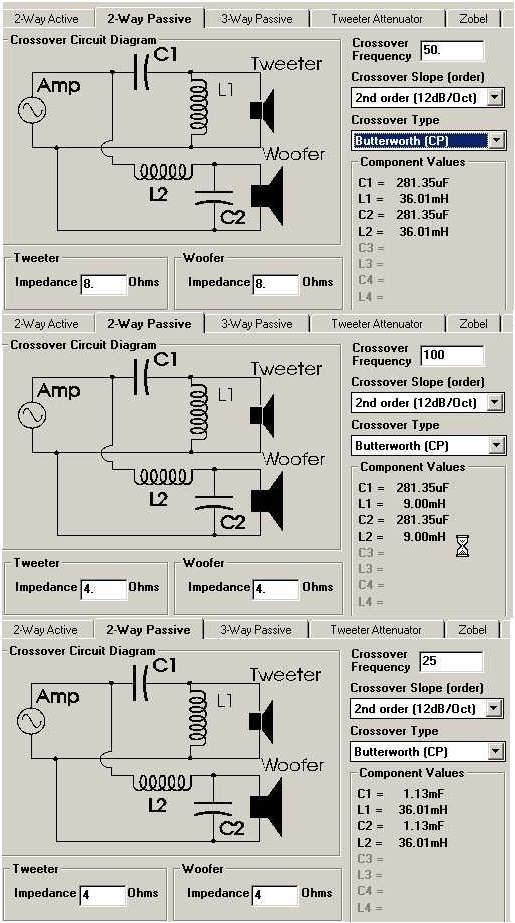

Can you post a schematic on the passive filter that's in there?
no idea ???
If this is representative:Can you post a schematic on the passive filter that's in there?
(2) 75ufd NP,
(2) 100mfd NP
(2 ) Coils ( oriented less than optimally )
About as cheap as it gets
(2) 75ufd NP,
(2) 100mfd NP
So it's a 2 channel (probably meant for a dvc sub) 12 db @....something? From the size of those coils probably over 100 hz.
Are the 2 drivers that you put in that horn different drivers, 60ndown?
I'm guessing ( based upon specs of the similar units ) that the sub has a 12db rate and the satellites are 6db 1st order ( series cap ONLY )So it's a 2 channel (probably meant for a dvc sub) 12 db @....something? From the size of those coils probably over 100 hz.
your right, as cheap as it gets,12db and 6db, and it gets worse (or better),
the x over is intended for 8 ohm subwoofers, im using 4 ohm.
from other questions i have asked, using 4 ohm drivers with an 8 ohm *intended* xover, makes the slope and the x over point different, im guessing the subs are actually crossed over about 80hz and maybe 18db slope?
but as with all my audio projects, there is a lot of guessing, and a lot of fun.
there may well be a hole from 100-150 hz but i cant hear it.......
i decided to build is as my HT sub, something that would get really low (its tuned at 25hz) without having to be loud.
i noticed yesterday i could be talking on the phone and still have bass shaking my liver without disturbing the call
tonnes of fun 🙂
The xover frequency will be different, but a lower impedance requires a larger cap for 1st order HP....from other questions i have asked, using 4 ohm drivers with an 8 ohm *intended* xover, makes the slope and the x over point different, im guessing the subs are actually crossed over about 80hz and maybe 18db slope?
http://www.the12volt.com/caraudio/crosscalc.asp#ccc
The slope rate will be essentially the same.

The xover frequency will be different, but a lower impedance requires a larger cap. The net effect will be to shift the fc upward, not down by an octave.
Passive Crossovers, Capacitor and Coil Calculator
By doing a little "jammin" for a classic textbook topology:
it would appear that an fc of 200Hz was the original intent of the 8 ohm xover.
The 100mfd for the 6 db HP for the satellites
The sub 12db LP using a 9mh coil using 70mfd ( close to 75mfd standard value )

A quick and easy way to see what the xover will do is to use a simulator, this one is from Boxplot (look at the woofer sections):
Wouldn't it be nice if a loudspeaker was similar to a resistor, then passive crossovers designed using a single value resistance would actually work properly.
I have yet to see a stock passive crossover acoustically do anything remotely like the predicted curve and crossover frequency it nominally is rated for.
To add to the fun, both of 60ndown's speakers loaded in his TH have different parameters, so each will have a different acoustic crossover . What the combined response is, is anybody's guess.

Filters ( 2nd order and above ) are combinations calculated for a particular "nominal" load....To add to the fun, both of 60ndown's speakers loaded in his TH have different parameters, so each will have a different acoustic crossover . What the combined response is, is anybody's guess.
The inductor values go up with increasing frequency; the reciprocal of caps whose values go down with increasing frequency. So impedance change is not being correctly compensated.
The transfer function could be determined by a sim program like Pspice.
