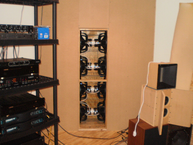

Here's the idea, but, just use the 2x 15" I mentioned, so Imagine 1/4 of what you see here. The drivers' forces cancel each other and the acoustic outputs load into the "manifold". The opening to the outside world must be at least 2 times the SD of one driver. Size it as you wish, but remember as the dimensions approach 1/4 wavelength of the highest frequency in the band pass, you'll start to get reflective resonances. The fact that this is essentially a 4 ohm load allows you to buy more inductor value for the buck, but a system like this is really much better served via an active crossover- but you established a budget.

Not the best example
very hard for me to understand that box from the photo?
all i see is some motors and a large sheet of mdf 🙂
Sorry, that was not the best example. It's simple really, just fire the two drivers in a common cavity, just large enough to house the 2 woofers physically, BE SURE the opening to the outside world is 2x the effective cone area of one driver. Another option is turning one of the woofers around by 180 degrees, effectively "humping" the other driver, sometimes referred to as PPSL.
