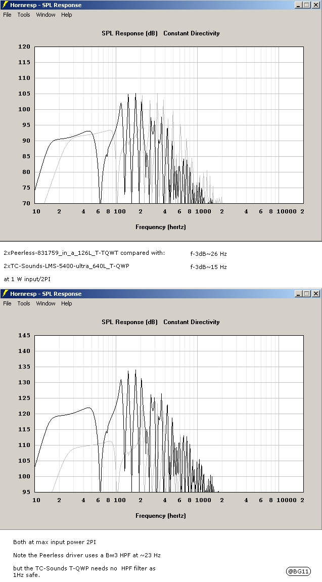

TC-Sounds LMS 5400 ultra

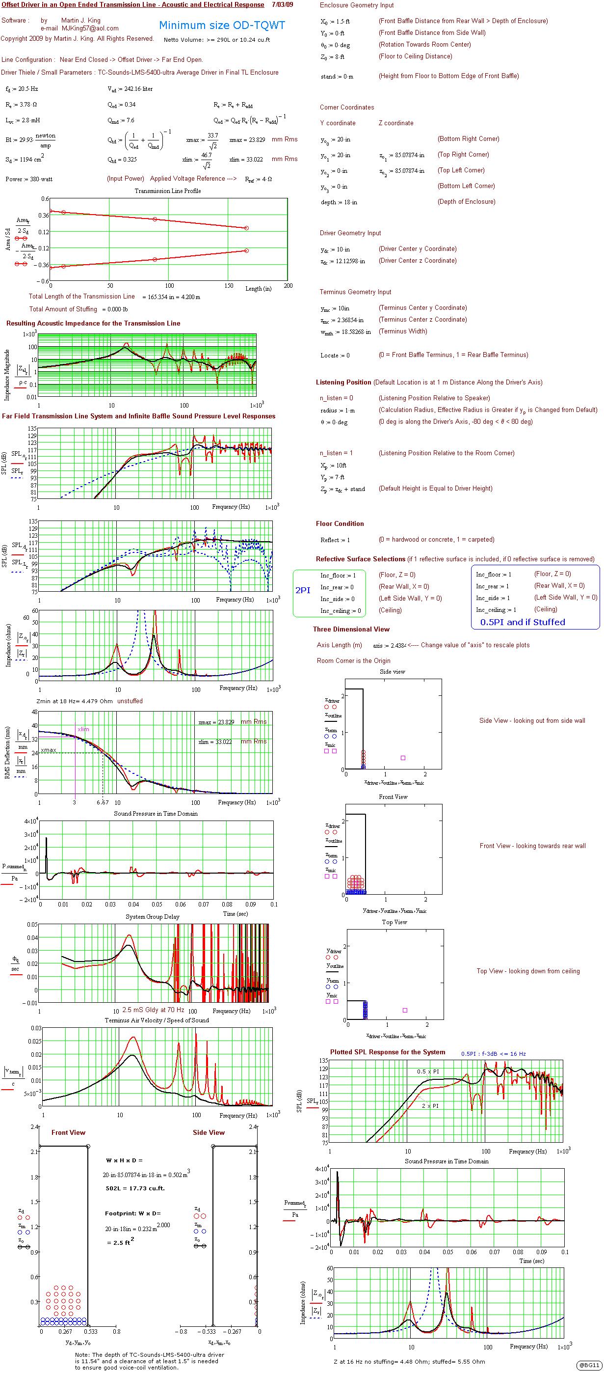

FYI:
Prior to design a T-TQWT enclosure: Testing the TC-Sounds LMS 5400 ultra in a corner(Home) placed minimum size OD-TQWT:
b🙂

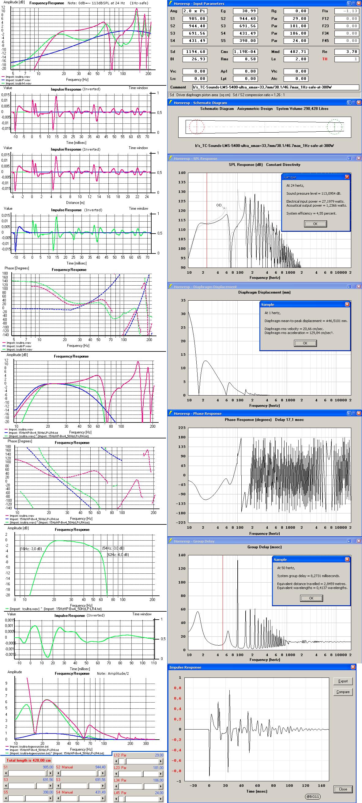

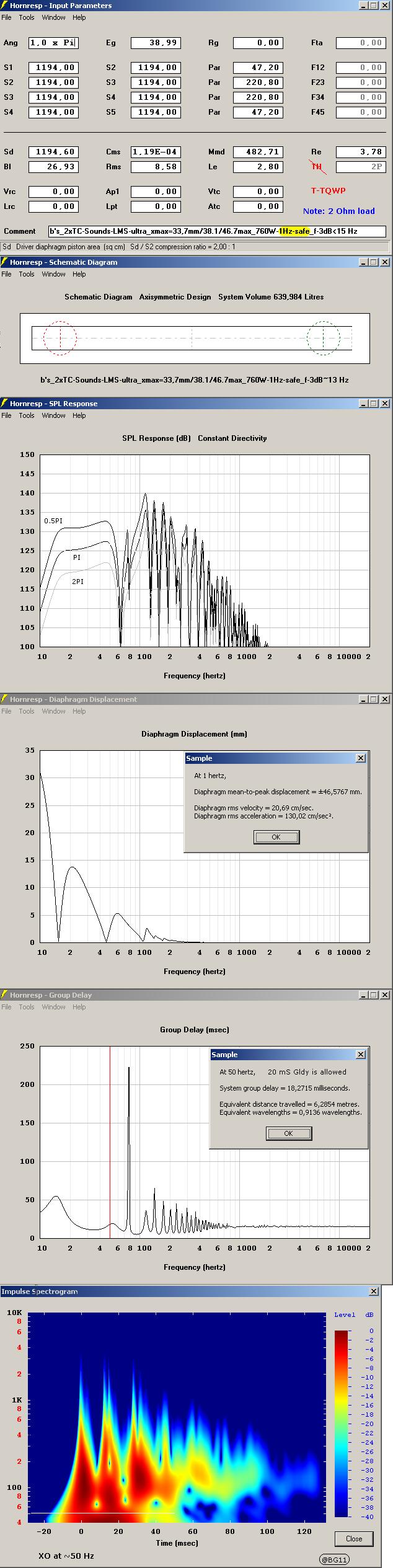

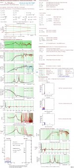

My previous last posted picture converted into a 'small' :xfingers: T-TQWT and a somewhat larger T-TQWP.
b🙂
