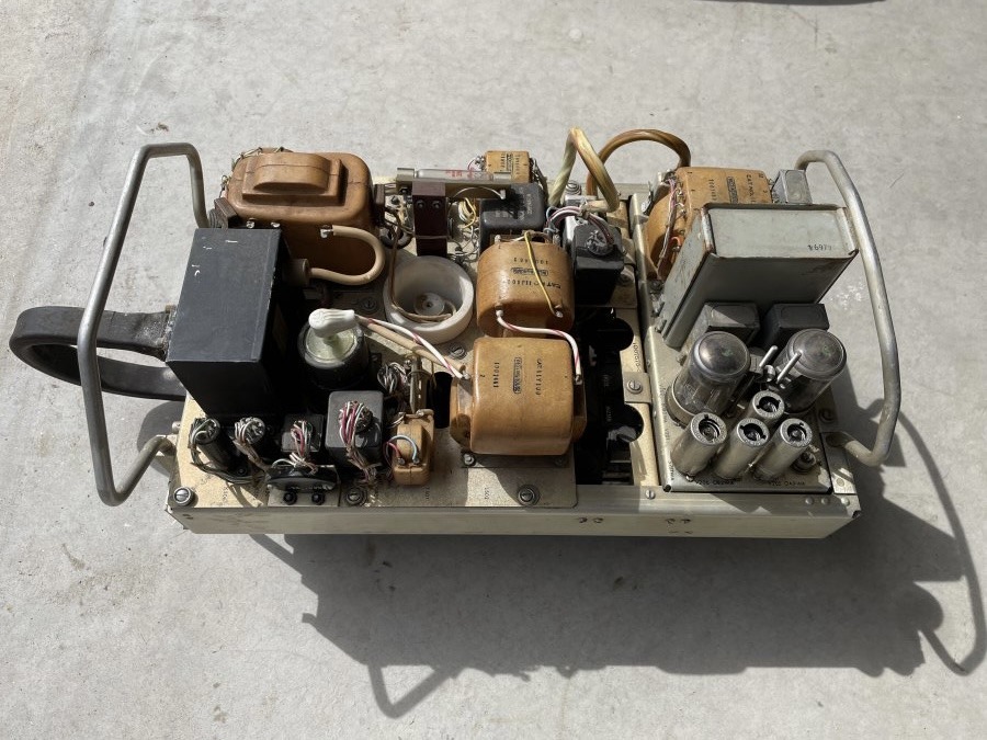

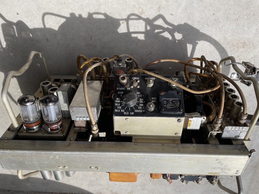

Ok, I decided to build the 4S Universal tube preamp. Here is what I have to work with. Hopefully I can use some of it.

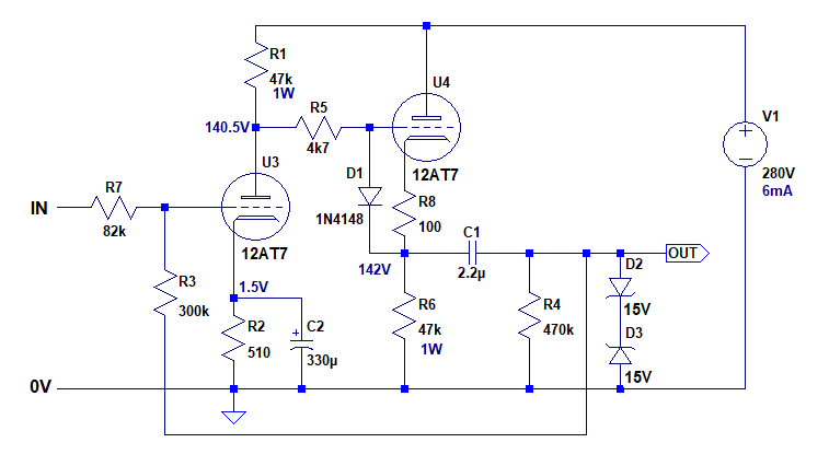

I built something like that 4S Universal Preamp, complete with volume control on the output, a few years before the commercial internet came into being. I built it using a 5687 so it would have a decently low output impedance. The problem was that the volume control on the output meant the tube's grid was always seeing the full blast output from the source, so distortion was always high, even at low volume settings. It sounded nice and tubey that way, and the volume control attenuated most of the noise. But I eventually got tired of that kind of sound.
I would redesign that 4S preamp to put the volume control at the input (where it belongs) and add a cathode follower on the output so it can drive cable runs and solid state amplifiers. I would use a negative feedback loop to adjust the gain as needed.

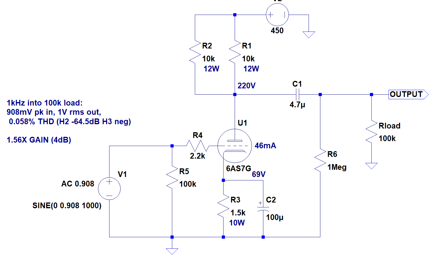

If no negative feedback can be tolerated then a fully bypassed 6080 common cathode amplifier should do. It will have low gain and low Zout, but will require a lot of plate current (40mA or more per channel) and a lot of heater current (6.3V 2.5A).
I threw together this simple common cathode 6AS7 in a simulation and it looks like it would do the job.

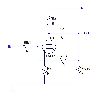

If an entire preamp or device has only one gain stage and you wrap feedback around it or take from output to the input, why can't you call it GLOBAL negative feedback?
This is not a power amp with output transformer. Of course I highly recommend using output transformer to be driven by cathode follower to step down the gain but without the transformer in the feedback loop if feedback is used at all.
For NFB around a single-stage amplifier you could call it 'global', but that would not follow standard practice. In general, 'global' negative feedback means NFB applied around multiple stages, while 'local' NFB means NFB applied around a single stage.
If you take a single common cathode amplifier and put shunt NFB from plate (output) to grid (input) then I'd call that 'local' NFB.
If you put a buffer on the output of that common cathode amplifier (either a cathode follower or a source follower) then are you buffering that single stage or is that a 'second' stage? I'd just call the buffer a buffer, meaning it's still a single voltage gain stage amplifier. If I then wrap NFB from the output (cathode) of the cathode follower buffer back to the input (grid) of the voltage amplifier (common cathode) stage, then I'd say it's still 'local' NFB. Like this:

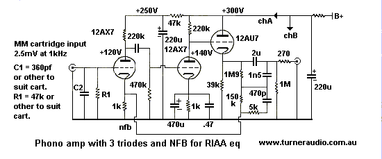

For a global NFB design, I'd be thinking of something like the 'ring of two' or the 'ring of three' circuits, in which you have two cascaded voltage gain stages with NFB from the output to the cathode of the first voltage gain stage. This is a phono preamp in the 'ring of three' topology:
Note that there are two voltage gain stages inside the feedback loop. I'd call that global NFB, although of a minimal sort.

I was NOT referring to the cathode degeneration feedback I suggested to DJN and that is NOT global feedback. That has nothing to do with our discussion. I was referring to your quote in the post and the circuit you included in below.
1654346392925-1-png.1203545
Again, if you wrap feedback AROUND the entire device from output to input I call it GLOBAL feedback and that's what the above circuit is to me.
Again, does feedback needs to be more one GAIN stage to be called global feedback?
P.S., Please keep in mind the OP has TWO circuits to deal with: the 6080 circuit has not enough gain and the universal 12A*7 circuit has too much gain. We will end up barking the wrong trees. My point is that wrapping feedback to reduce gain (the 12A*7 circuit) from output to input via a cathode follower and cap is global feedback.
The reason I brought up cathode degeneration is that you posted it as an example of local feedback, but then posted that shunt voltage NFB around a single stage is 'global' feedback.
As I posted earlier, it is possible to have a local voltage feedback loop, but that requires a loop of signal from the output of the inverting gain stage back to its input. If I understood you correctly, you stated that this is an example of 'global' NFB because it goes around from the output back to the input. I disagree with you, and I'm explaining why. Therefore, cathode degeneration has everything to do with the point I'm trying to make here.
Yes.
NFB around a single gain stage = local NFB
NFB around cascaded gain stages = global NFB

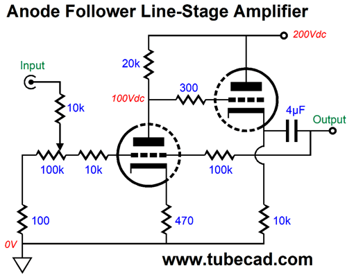

This is the basic anode follower, which is considered to be an example of a single voltage amplifying, inverting gain stage with local NFB.
As explained in my previous post, I consider the cathode follower or source follower to be a buffer, so I consider the circuit below to be an example of 'local' NFB, because it's merely the above circuit with an output buffer added (which improves the performance of the NFB loop):
John Broskie posted pretty much the exact same circuits in his discussion of the Anode Follower on tubecad.com.
https://www.tubecad.com/2019/03/blog0458.htm
