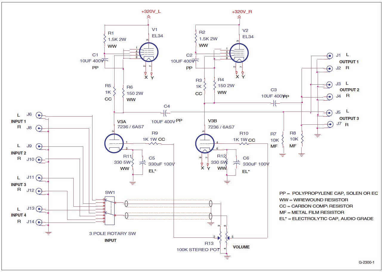

Looking at your design above the only thing I question is the volume control and signal input (presumably output too) wiring in the power supply enclosure when it's not necessary. Otherwise , Kool ! Kind of Bang/Olufsen from The Cyberiad.
There will be a third pipe going up the back. That one will send power up to the separate preamp boards. The signal wires will go from the volume and selector to the separate boards through the pipes on the left and right.
The outputs of the boards will come out of each box.

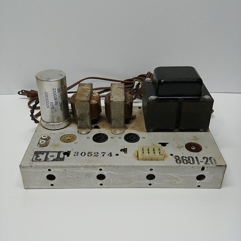

Ok, I’m back at this preamp business! I decided not to build the Akido for my desk. But there is a new wrinkle. Here are the chassis parts I want to use.
The black control panel will be for input selection and volume, the tube box will be for all the tubes, and the handles will be used for, well, handles.
So what good preamp tubes will fit in the 8 pin socks and what rectifier tube will fit in the smaller sockets?
