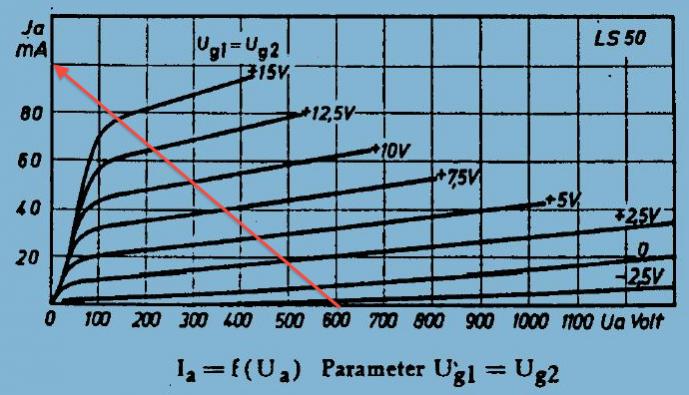

You can use here Gu-50 in "Right handed" mode, connecting all 3 grids together:
http://wavebourn.com/forum/download.php?id=491&f=7

Actually, the title of the plot says that the screen and control grids (G1, G2) are wired together with the suppressor grid (G3) grounded.

Actually, in triode mode it does not matter where to put the suppressor grid. Try and compare. You can get some difference if add positive bias on it.
Hi Anatolyi,Actually, in triode mode it does not matter where to put the suppressor grid. Try and compare. You can get some difference if add positive bias on it.
Thanks for the suggestion, didn't think about the right handed option. It will be better to obtain more voltage span with my current design constraints I think.

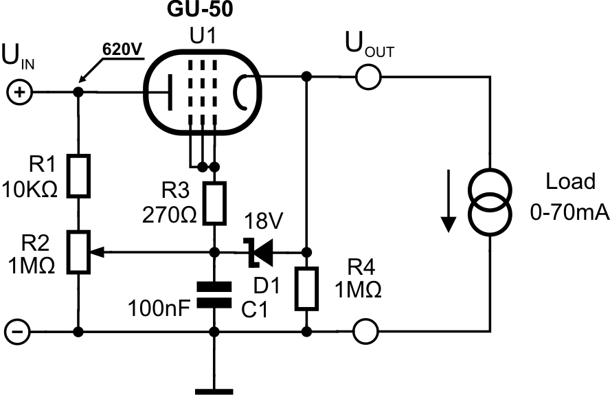

Here is the circuit and looking at the loadline based on your curves, it looks like I won't need more than 15V of positive grid bias to sustain 70mA load at low output voltage.
So if replacing protecting diode by a 15-18V zener should ensure positive grid voltage is limited, but wouldn't this zener blow up if output is accidentally shorted?
Sure, when shorted current will go also through 10K resistor and Zener, if voltage control pot is on maximum. 600V/10K = 60 mA. 36W on 10K resistor, 1 W on Zener. Total current will be the sum of this current and current through the tube. Current through the Zener will be less: part of it will go through grid-cathode. So you should worry now about 10k resistor and the pot.
So is worth using the 10k resistor as a protecting mechanism or is there a way of improving this any further?
I would add one more current limiting resistor, from pot to grid/Zener. Probably one more cathode follower (or source follower?) may be needed using smaller tube or small high voltage MOSFET if voltage drop on this resistor will be too high in normal operations' mode due to grid current.

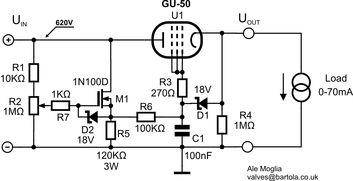

Ok, here it comes: a bit of sand to the circuit 😉
I can use an IXYS IXTP01N100D as I have some. Perhaps not the ideal MOSFET here but should do the job. A bit puzzled as to how bias this MOSFET when the operating point will vary from 0 to 600V 🙄 So when choosing R5 I looked at worst case scenario (i.e. 600V at the output of the follower or across R5). My question here is whether when operating at low voltages the current across the MOSFET will be too low for proper operation?
Other key question is the value of R6. The GU-50 g2 current can be as high as 20mA, but I'm blind as to how much grid current can go through the valve in right-handed mode. Anyone has any chart on this? I think the balance of R6 is between grid current and a high value to limit the current through output zener if the output is accidentally shorted...
Thanks for the help!
Geez! The BD139 is good for only 80 volts!
But if you'd consider using a higher voltage device, your suggestion micGt work.
Regards!
I believe that. I was merely translating the title of the plot you showed, that's all.
Is there any advantage of connecting all three grids together for triode mode rather than the more common G1 = drive; G2 = anode; G3 = cathode connections?
Thanks all for various suggestions and sharing your ideas, but as I said on my first post, I'm looking at achieving this without significant rework or additional parts. Appreciate your input and knowledge here 🙂
