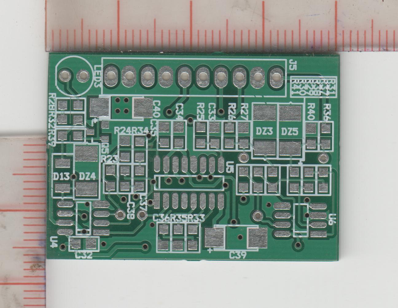

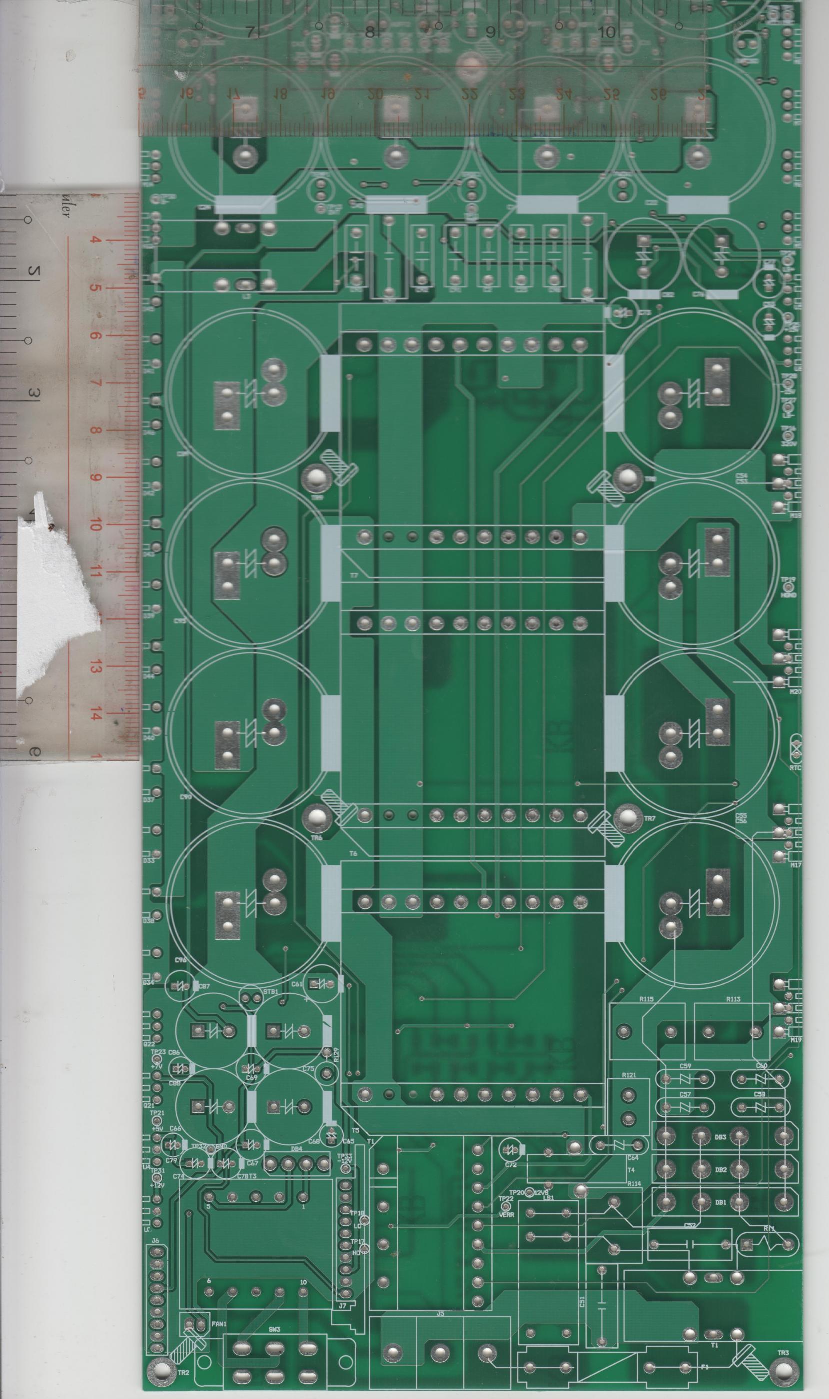

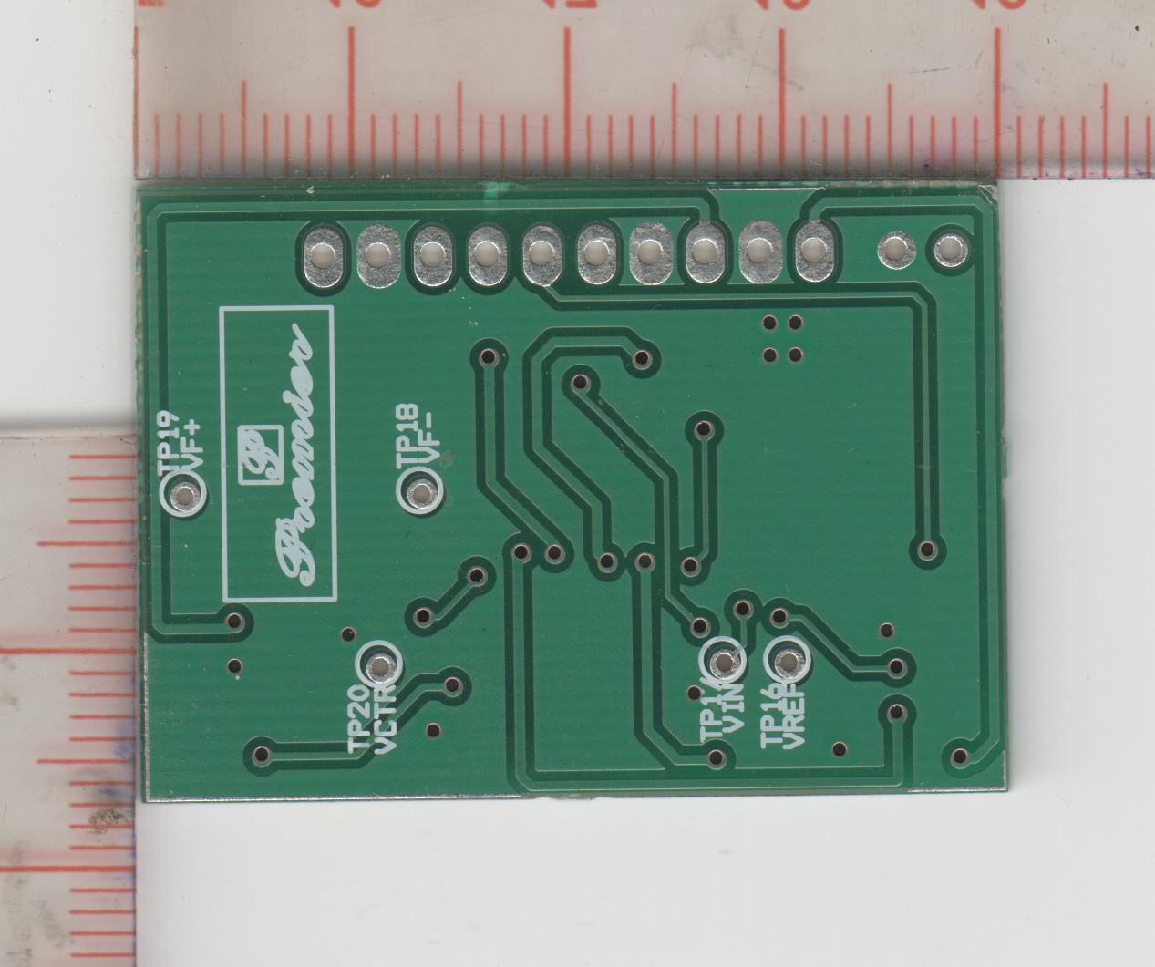

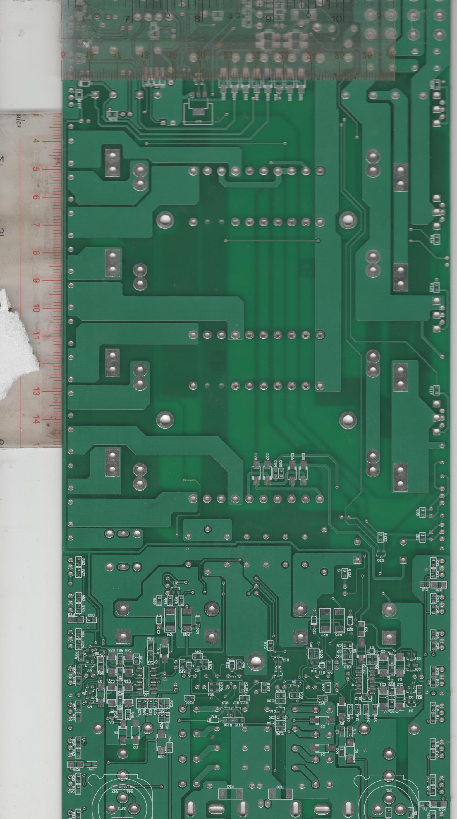

Hi Ngthyen,
I'm interested in your bigam design, is there any news on the pcbs. If so, you will be able to upload them to the forum, you plan to sell them, or you be able to upload on my enail : aerasepolia2@gmail.com
Regrads,
Regrads,
PCB Bigamp
Nice - look forward to seeing the completed amp and test results.
Are you planning a group buy or selling the boards later on? 🙄
