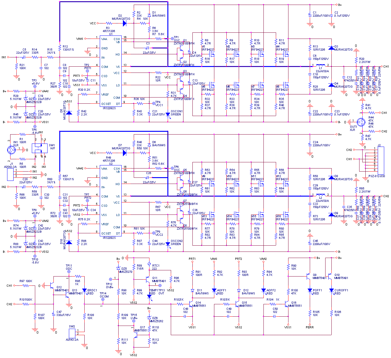

hey guys i've found it's posible to drive output power fets with bjt it is called tontem pole. thanks to ir company ir amp9 is similar to what this thread is all about
but produces 1.7kwt instead of the 6kwt as in this thread
http://www.irf.com/technical-info/refdesigns/iraudamp9.pdf
the whole project is in there, boards ,schema and components courtesy of irf company; but it uses smd components 🙁 🙁 🙁
So?the whole project is in there, boards ,schema and components courtesy of irf company; but it uses smd components 🙁 🙁 🙁

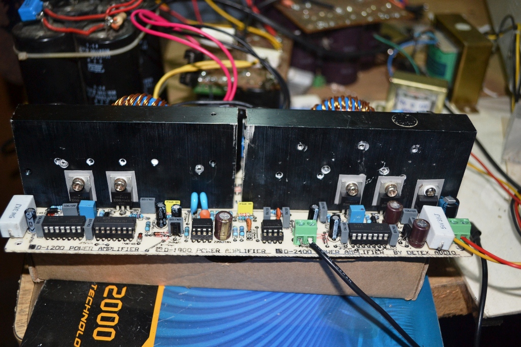

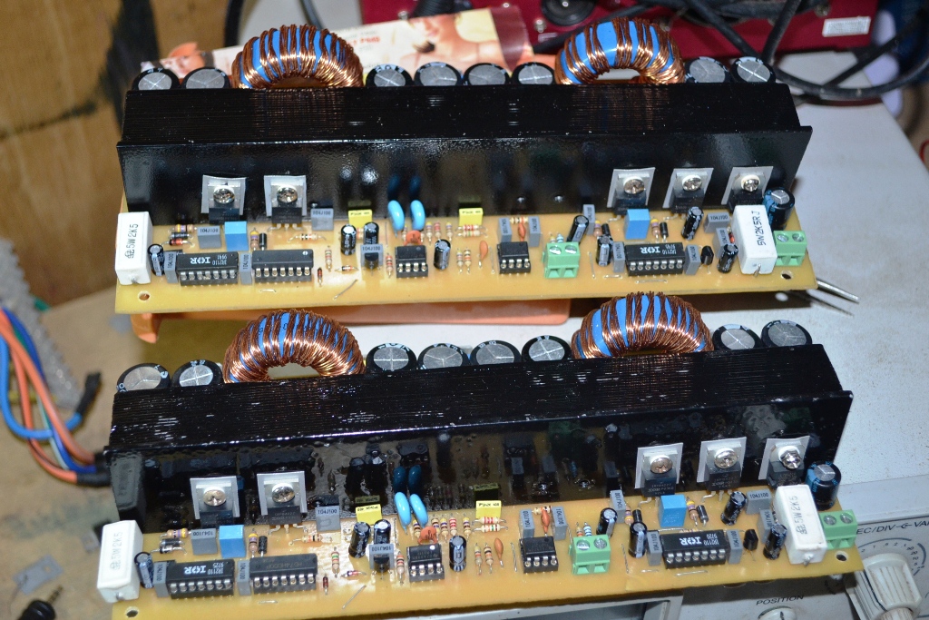

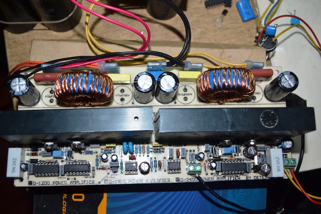

my woking bridges amp
HI hien.t.nguyen hope to hear more from you,this is a huge audio power amplifier
Thank your interested
My module amp maybe change for many purpose usage
For subwoofer,for pro amplifier,1kw,2kw,....7kw.
All can easy change by way mount components with appropriate quantity on PCB or not mounting.
-Maybe mounting 1,2 or 3 switching power transformer.
-Maybe chose 1,2,3 or 4 pair mosfet output,...
-Maybe mounting XLR connector(bottom layer) to become driver subwoofer(chose plate appropriate heatsink)
-Maybe mounting speaker connector(top layer) to become pro amplifier.
Hix,I was option one PCB for all purpose usage.

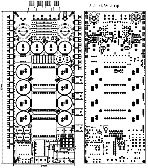

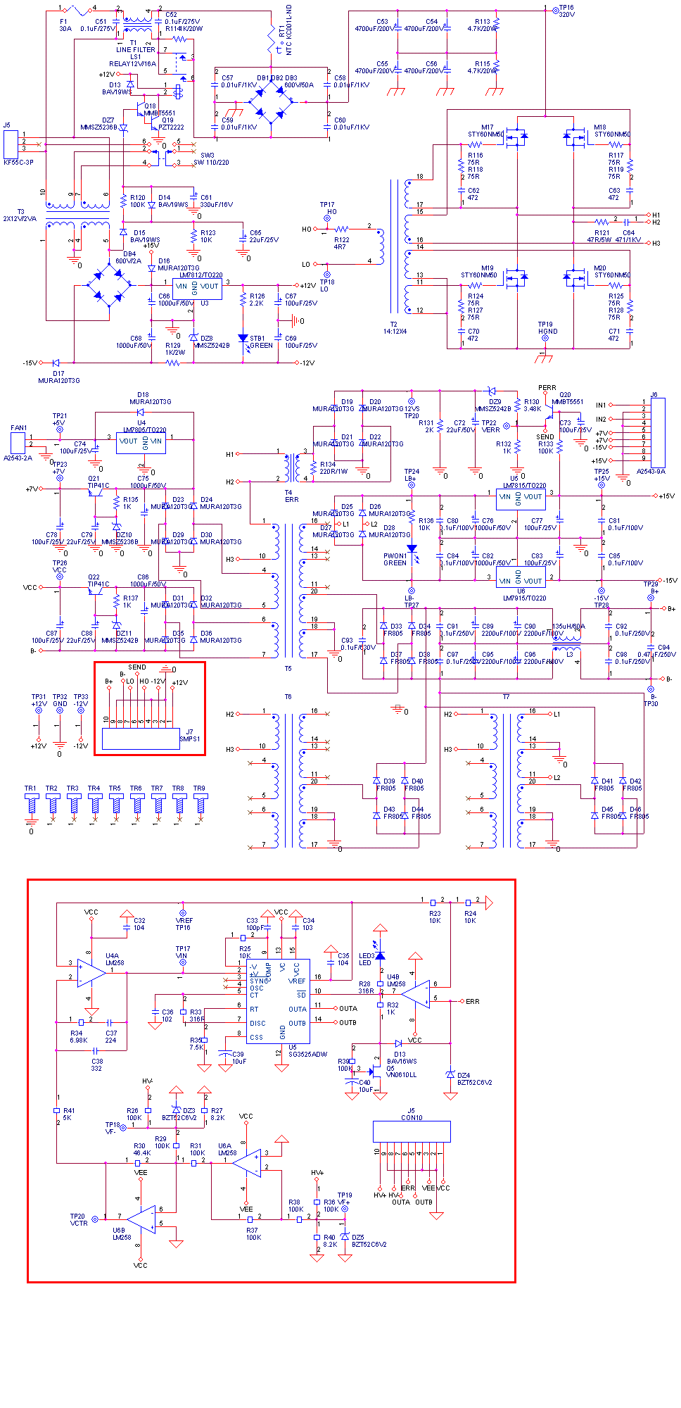

Hello everyone
I am developing an big amplifier(about 7kW/8ohm full bridge or more) include: Amp and SMPS all in one PCB size 140x350mm
Not sure how you're going to get ~7kW running <100V rails.
Sorry,i mistyped from 4ohm load become 8ohm load.
If I use 4 ohm load(full bridge),+/-100V,Pmax < 200x200/4 = 10KW(peak) = 7.07kW(rms)
Thank exactly feedback.
Regrads,
- Class D
- 6000W By IRS2092
