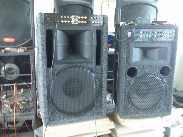

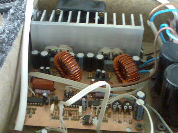

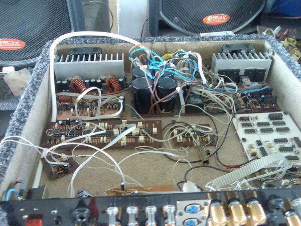

Not quite 6000w, but interesting simple classD topology: IRFB4227, Ir2110, LM319, deadtime with 74HC14, bridge +/-75v, 8 ohm in powered speaker with RCF MB15H401 and Precision Devices PDC2.
It works very well in full range, it is selfoscillating , 400khz at idle, but in this powered speaker i have an active processing, with class AB for highs.
LE. I know that inductors not have optimum position, but it works well, no parasitics.

Toroidal trafo is inside of box (not visible); it puts 126 vpeak, means aprox. 1kw@100hz (tested with resistive 8 ohm load).
Deadtime is 47ns, L=13uH, T130-2, configuration ucd like, full bridge with 2 passive pole. And active clamping sensing v-supply, combined with active compressor based on CA3080 (ElectroVoice like). No distorsion at all, even hard forced by turning up full volume (26db like).
