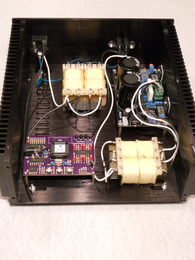

The design uses two low cost split bobbin transformers with dual primaries and dual secondaries. The AC input transformer is a Signal LP24-2000 (48W) and the output transformer is a Signal LP12-1900 (24W). Both are available from Mouser ($24 and $19 respectively).
For 115VAC input or output, the high voltage primary windings are connected in parallel. For 230VAC input or output, the high voltage primary windings are connected in series.

The MK-154 MUST have an adequate heat sink attached to the two LM-3886 output amps for proper operation. Failure to use a heat sink will result in almost immediate destruction of the amplifier. Use a heat sink with at least 40 square inches (250 cm²) of surface area and at least 2-3 inches deep. The LM3886 chips are in an isolated package so they do not require mica insulators between the chips and the heat sink, however, you will need to use silicone heat sink grease.

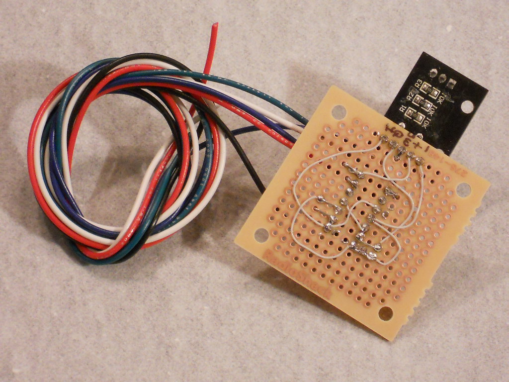

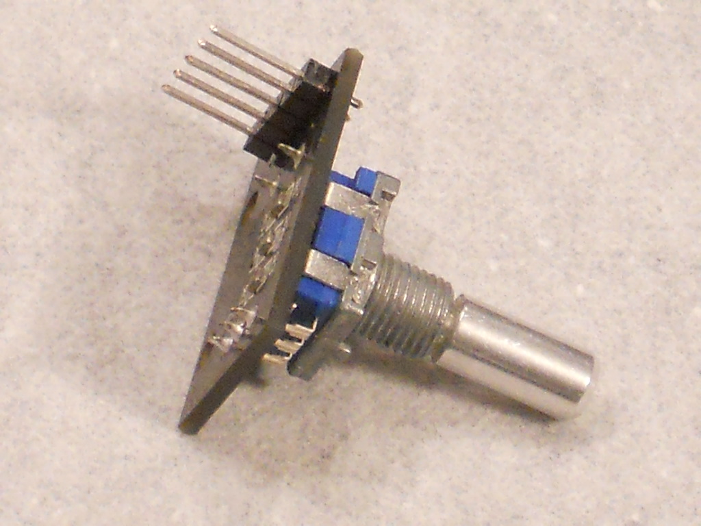

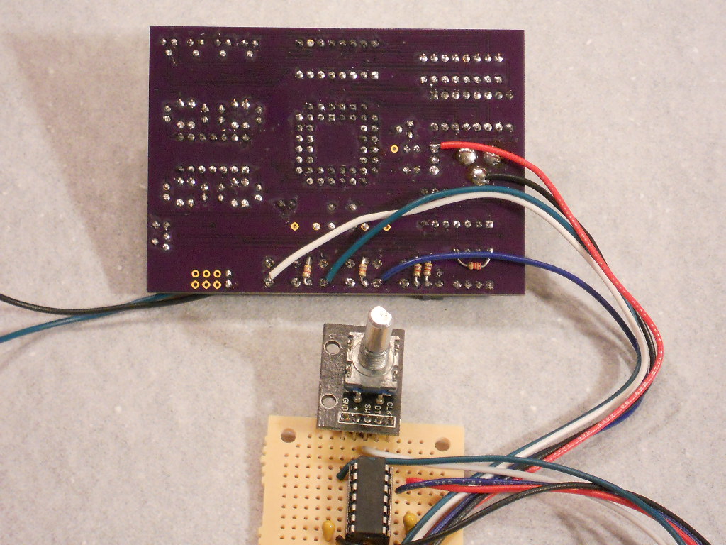

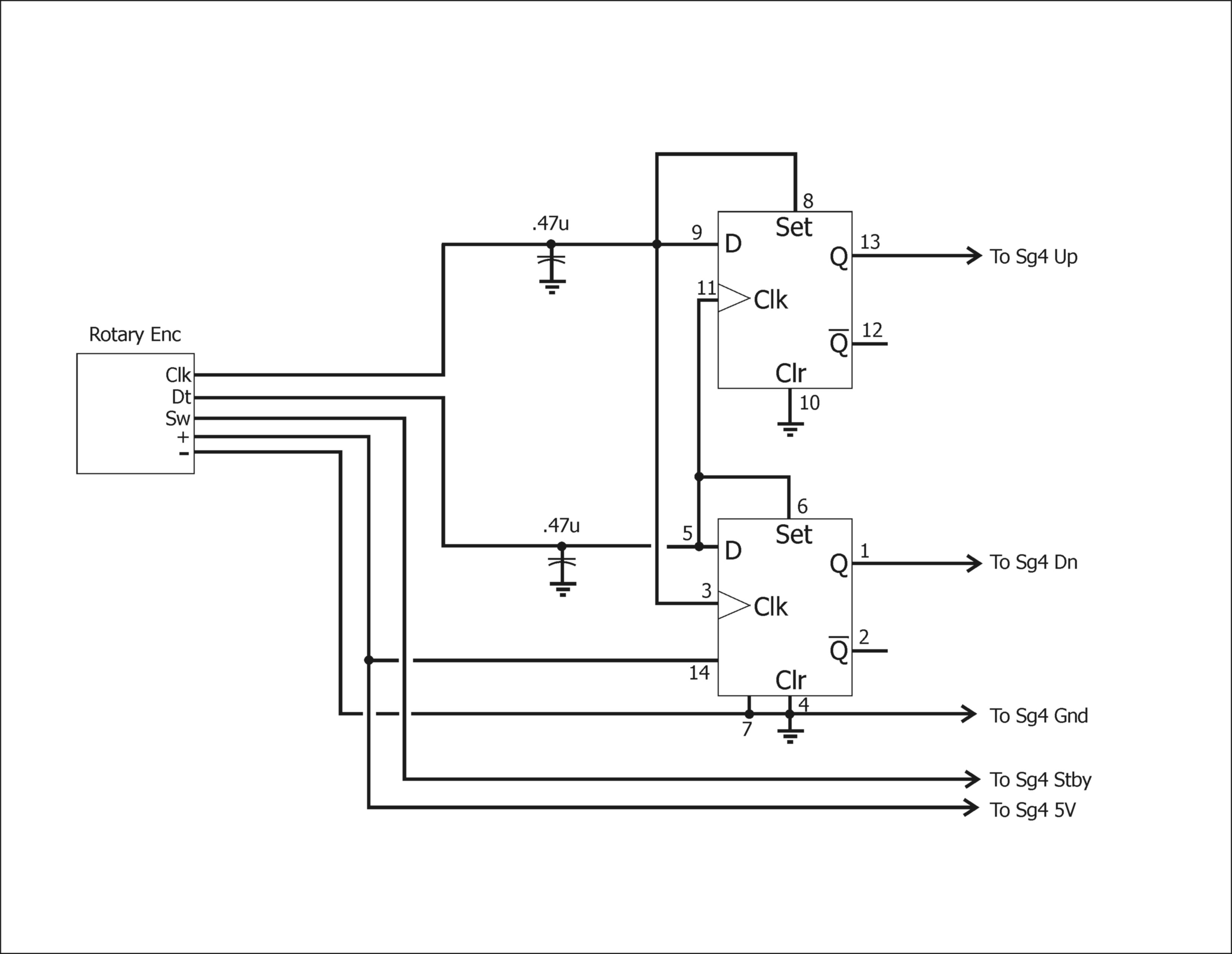

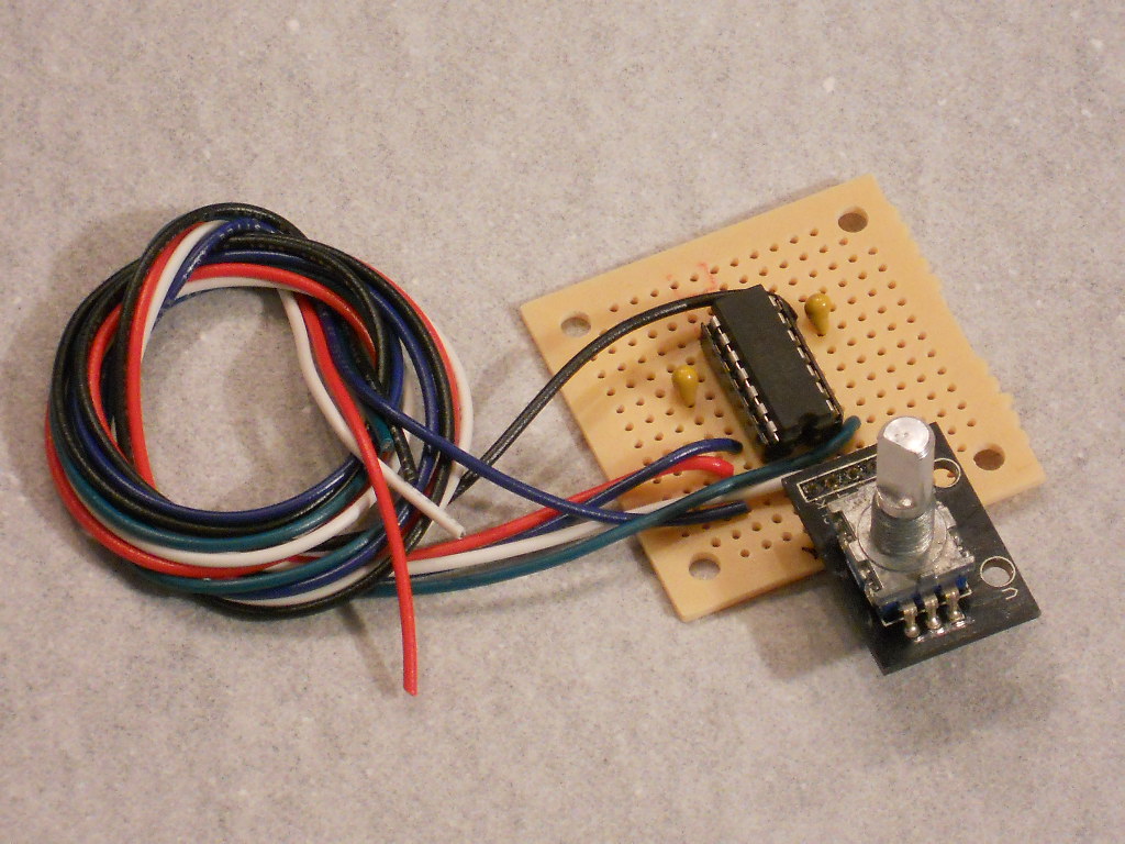

Rotary Encoder control for SG4
I've ordered one of the cases above from e-Bay and will build up a number of configurations and document the process. The case I ordered was the #2409 which comes with a front panel on/off switch already mounted and a knob and front panel hole for one control. Rather than carve up the front panel, I came up with a way to operate the SG4 using only 1 rotary encoder control with momentary push button function.
The rotary switch outputs 2 sets of pulses in quadrature, the leading/lagging signal depending upon which way you rotate the switch. I developed a simple circuit using a 4013 dual D flip-flop that converts the 2 quadrature signals into 2 individual pulse trains with each one only active for CW or CCW rotation of the switch. These outputs can then be connected to the UP/DN buttons on the SG4, the momentary switch connected to the Stby button which will allow you to operate all of the normal functions with one control.
There is a short video of the operation Here
The rotary switch was purchased on e-Bay for $3.59 including shipping Here.
I changed the header on the rotary switch to point straight back and wired up the circuit below onto a piece of Radio Shack perfboard. 5 wires connect the circuit to the SG4: 5V, Ground, Up, Down, Stby.
The two 0.47uFd caps are necessary to filter out switch bounce. If you do not add these caps, the outputs will switch almost randomly.

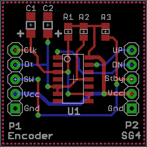

I've just built one up with the enclosure #2409, but I haven't done a lot of testing with it. The entire case is thick aluminum with 2 heat sink fins. It should be fine for motors up to 15W, above that you may want to go with more heat sink. I'll post pics soon about the build process.
If you go with the rotary encoder, you might want to purchase the PCB for mounting the switch and parts:
[url]https://www.oshpark.com/shared_projects/AbsVI39H[/URL]
It uses surface mount parts, but you only need the IC and the 2 caps (0.47uFd) if you use the Arduino rotary switch (3 R's on on the switch already). You can also use the RA header that comes with the switch.

Yeah, I ordered the boadrs earlier today.
The encoder you linked was sold out so I ordered this one.
KY-040 Rotary Encoder Module Brick Sensor Development Board Shield for Arduino.
I hope it is the correct one, not much info on the EBAY page

That should be OK. There are several vendors selling these switches. Just be sure the pins on the output of the switch PCB match the inputs to the interface PCB (CLK / Dt / SW / + / - ).

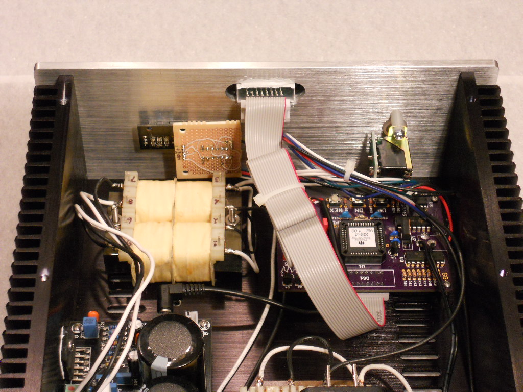

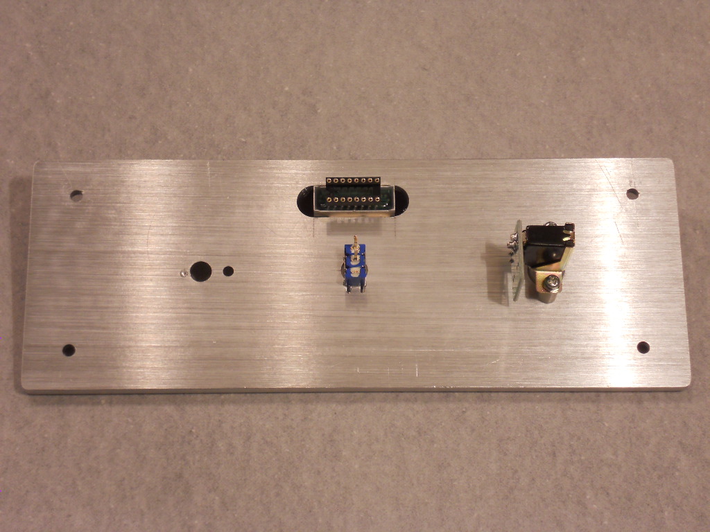

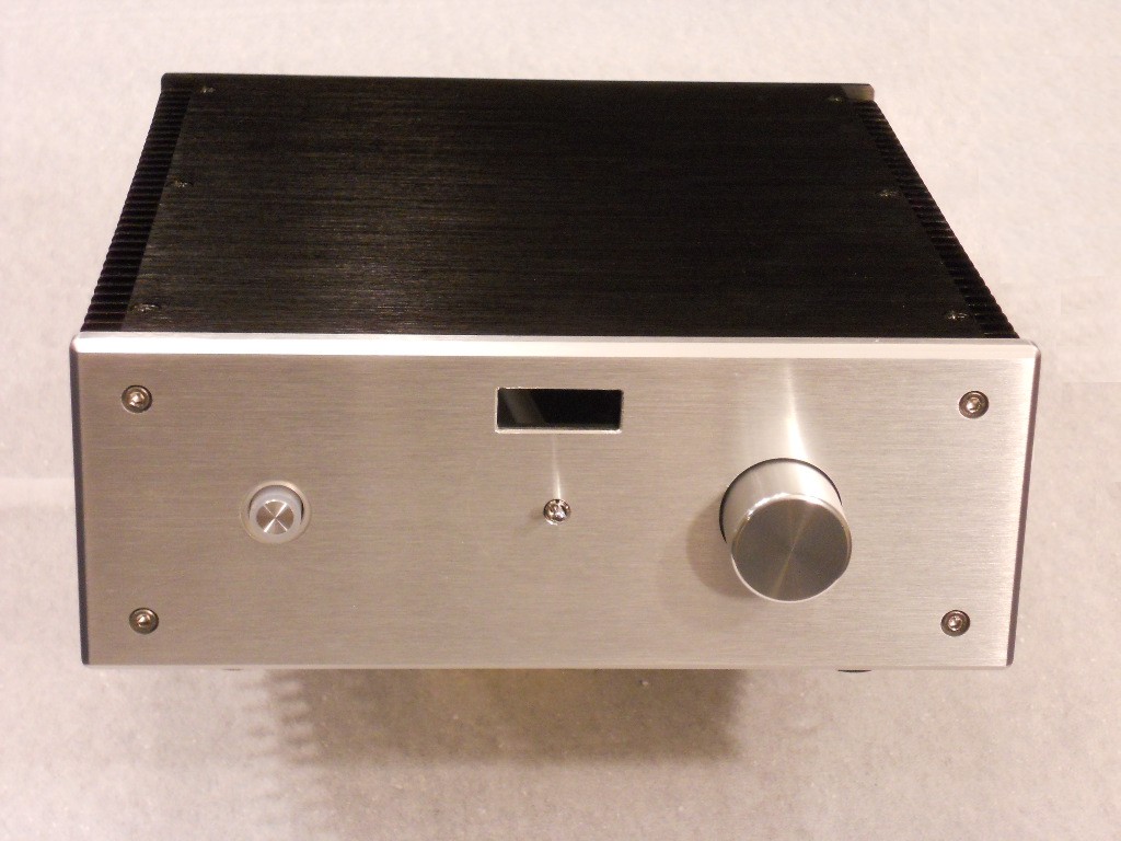

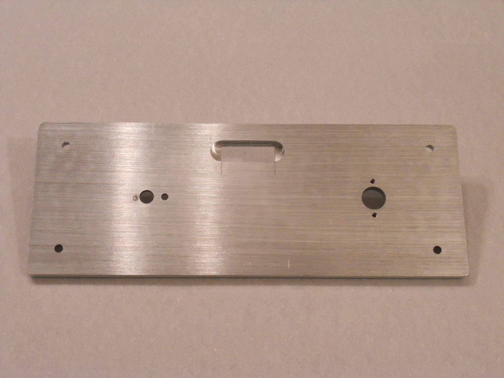

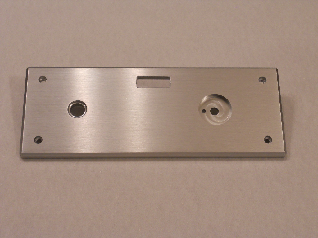

Finished turntable motor controller

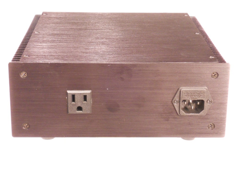

This is the finished motor controller using the SG4 sinewave generator, LM3886 based MK-154 stereo amp, 2904 enclosure and rotary encoder switch. The 2904 enclosure comes with the mounting holes for the on-off switch and the main control knob so only the display window and toggle switch for 33/45 RPM was added to the front panel. The back panel of the enclosure comes with an IEC input socket with built in fuse holder, so only the NEMA 5-15 output connected was added to the back panel.
For the display window, I milled a 0.5" wide channel on the back side of the face plate. The depth was set to within 1/16" of the front surface. I then cut a 3/8" wide hole through the front panel and squared the corners with a file. This left a 1/16" wide lip to glue a plexiglass window into the face plate from the back side. The LED display would then be glued onto the window.

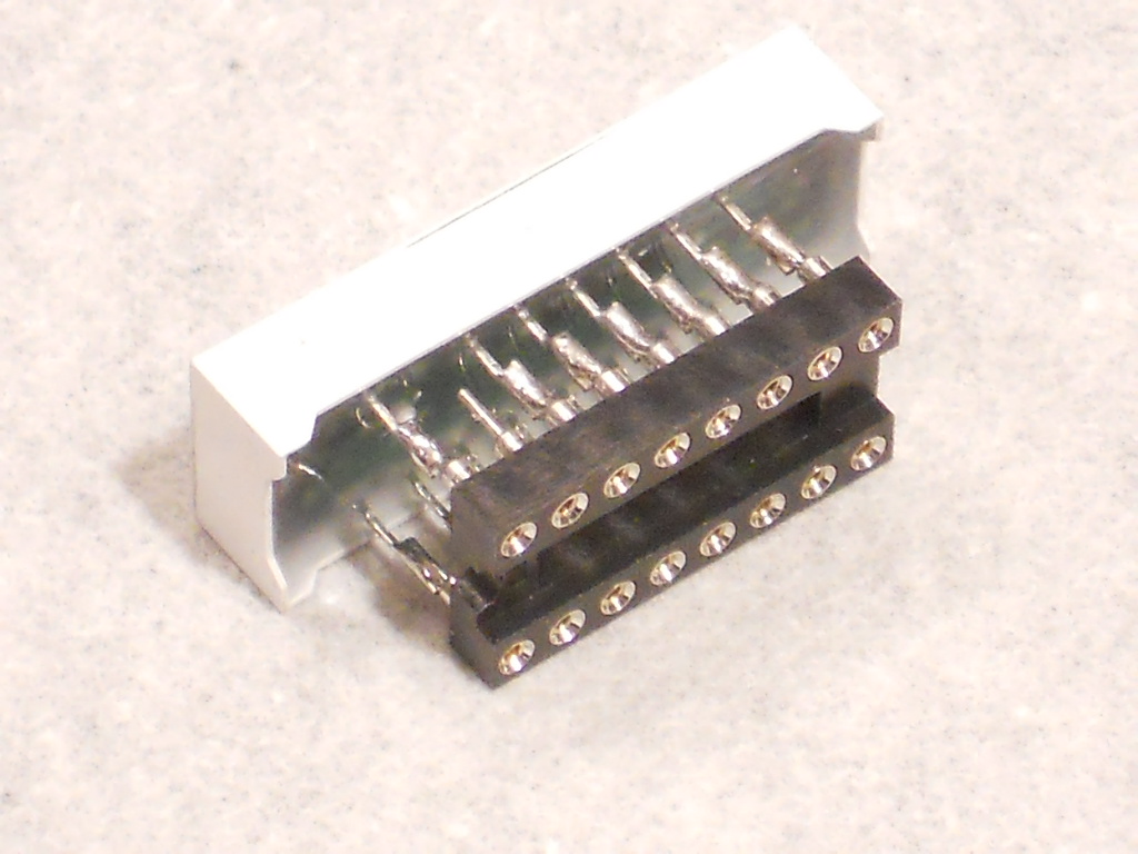

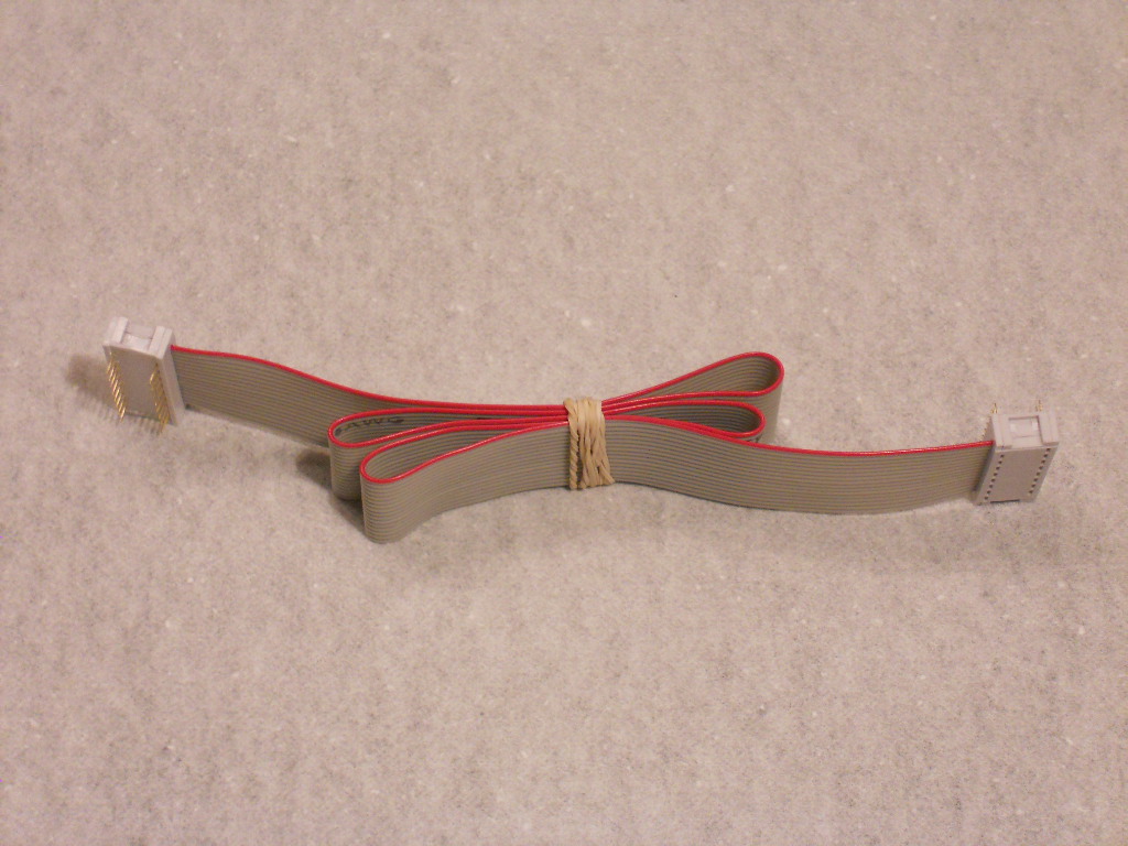

In order to remotely mount the LED, I soldered a 16 pin socket onto the LED pins as shown in the picture below. I also soldered a 16 pin socket onto the BACK side of the SG4 and connected the display to the SG4 using a 16 conductor ribbon cable with IDC connectors. In order to get pin 1 of the display to connect to pin 1 on the SG4, the cable needs to have IDC connectors mounted on OPPOSING sides at each end as shown in the picture below. The cable must attach to the BACK side of the SG4 and when plugged into the socket on LED display, the cable will exit to the top as shown below.
The MK-154 amp was mounted to the bottom plate using 1/2" stand-offs and the two LM3886 amps are attached to the heatsink as shown. The tabs of the amps are isolated, so no mica spacers are needed. Mount the amp to the bottom plate and mark where the holes in the LM3886 tabs meet the heat sink. Drill and tap holes for 4-40 screws into the heat sink for mounting the LM3886 tabs.
The transformers are mounted to the bottom plate of the enclosure and are connected as shown in the OP of this thread for 115VAC input/output single phase.
The rotary encoder and PCB are mounted in the main control knob opening and are wired to the SG4 as shown in the post on the first page of this thread.
I powered the SG4 from the wall adapter that is specified in the parts kit. I soldered wires from the input transformer primary to the wall adapter plug. The controller did not work properly if powered from the 18VDC on the MK-154 amplifier PCB as the start up surge cause the voltage to drop enough to put the SG4 into reset which caused another surge and the system was stuck in an endless loop. If you power the SG4 from the amplifier board, ensure the power supply to the SG4 is decoupled and filtered to prevent this.
Two wires connect the 33/45 RPM SPST toggle switch to the SG4.
There is a video of the completed controller Here.
