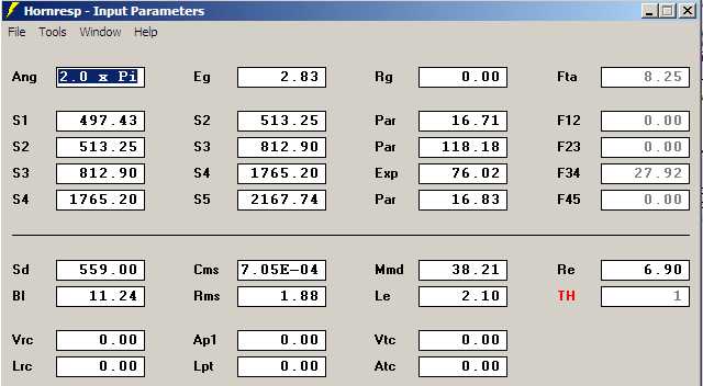

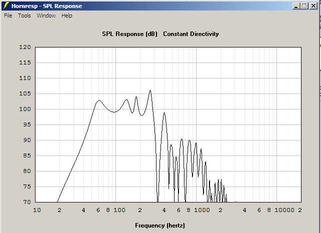

Hi Y'all,
I'll attach Hornresp Input and SPL screens for jbell's SS15 w/ the Avico 12". There is not much going on in the initially desired frequency low end. On the contrary, for this driver and this box a good low cut filter would be at around 35-40Hz to prevent excessive excursion at high input power. Yes, it would work, but it would not come close to 25-30Hz.
To add a bit more, at 20 Hz, a 5 dB difference sounds twice (or half) as loud to our ears.Hi Y'all,
The SS15 w/ the Avico 12" is about 30 dB down at 20 Hz, it simply is not a bottom octave contender whatsoever.

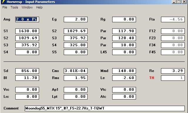

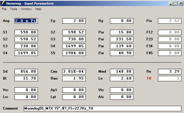

Hi moondog55,
I entered your MTX 15" data into Hornresp for you. Here are three simulations, BR, TH, T-TQWT. For sealed just zero out Ap and Lpt. That ought to get you started.
For the simplicity of the build and the size I'd go w/ the BR, just double the volume, etc. for a dual (V_int~254 L_net for the single).
That's interesting as when I enter the data into JBagbys program I get a reflex size of 2455 litres optimum. Sealed I get a reasonable response in 300/400 litres, the alternative which I used and did not like was a small box( 155 litres ) with a first order pass at 18Hz.
Art
As Art said, the news is better than expected. 5db equates to about twice as loud. 10 db is twice as loud in the midrange, but if you look at the equal loudness contours, you realise that bass is different. Typically 6db equates to twice as loud, but as the level goes up higher, the db increase required for percieved doubling of output goes down. I wrote about it here:
Red Spade Audio: Loudness perception and bass
Take a close look at the equal loudness contours and you might notice a few things easily missed.
