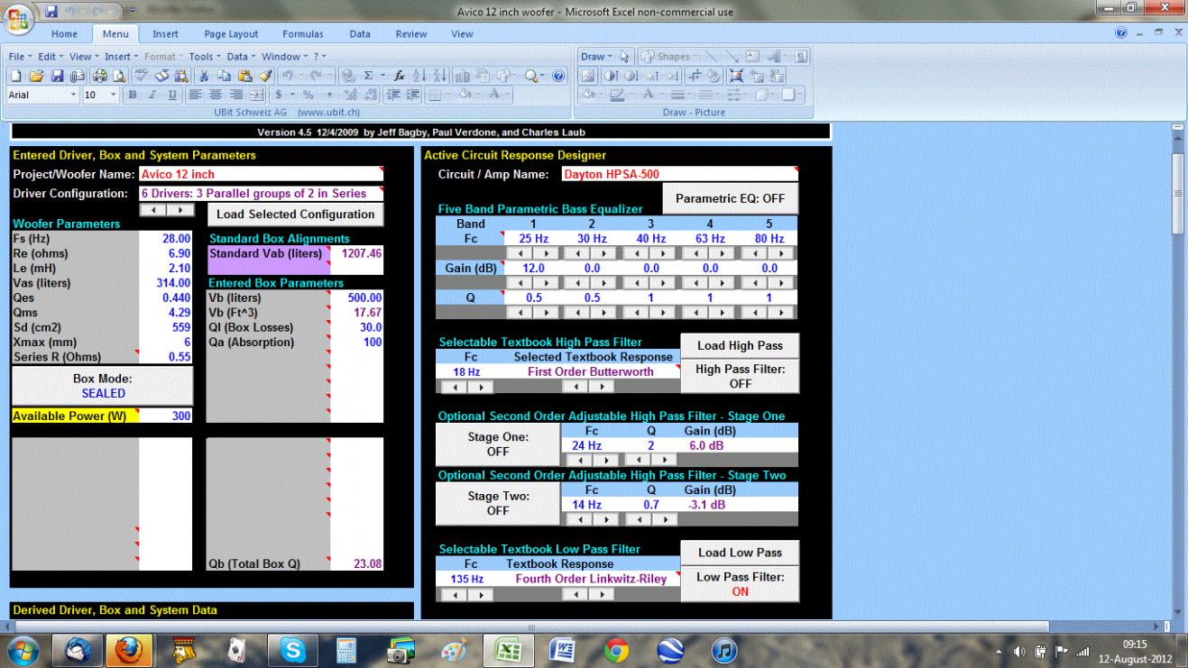

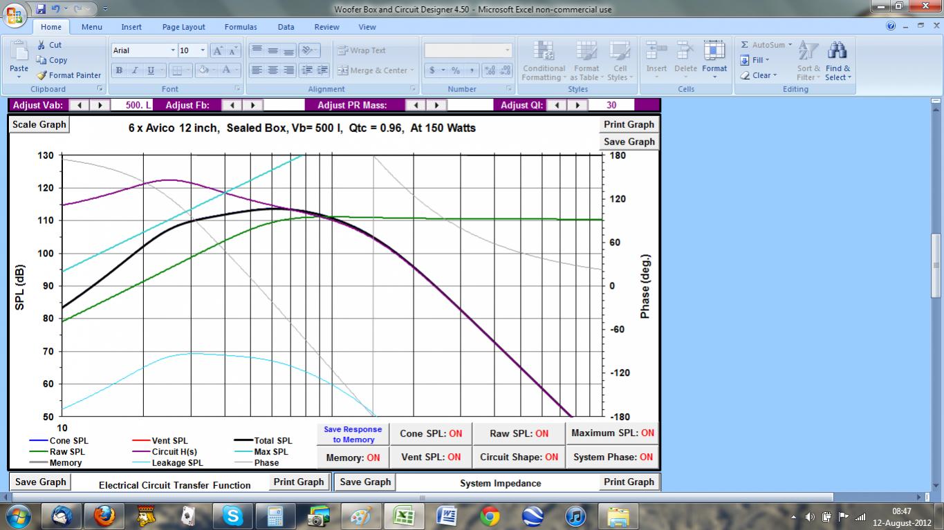

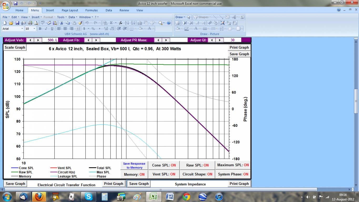

I have done some playing around since I managed to find the factory parameters.
Maximum EQ on my little mixer is 12dB at a "Q" of .5 and 24 Hz is the lowest setting.
If I can get 100db or so from these it will be enough as 96dB at the property boundary is the legal maximum.
Given the comments on the box size being too big I went down quite a bit.

I don't have the physical space in the shed to to store a horn, a big sealed box on wheels is at least a little portable.
Quite honestly a sealed box is with-in my woodwork capabilities and fits as far as the cost goes. I can use chipboard for a sealed box and from my limited understanding the horn needs 18mm plywood which the restrained budget won't allow.

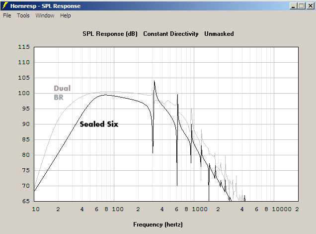

Hi Moondoog55,
A tapped horn for this driver should probably be a new design. Just stuffing the driver into the SS15 box might not work too well, and the SS15 does not have bass extension to, Post #4: "...around 22-35...".

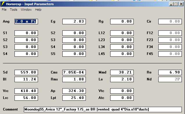

Taking your initial box dimensions, you could build a simple (not at all highly tuned) vented box using two of your 12" drivers. Using the T/S data from Post #24 it will need 4ea. 4"Dia.x10"long port tubes (or equivalent port): Ap=324.3cm^2 and Lpt=25.4cm. Try it in Bagby's software and see what you get, in Hornresp it does not look at all critical. You will need a 20Hz low cut filter. I used the same Eg=2.83V for both simulations.
The box material could be chipboard, just make sure that you provide a lot of bracing (the Bozak Concert Grand comes to mind). You could use the same basic box to try this out.

The trouble with tapped horns is that they tend to have limited bandwidth. You have to consider your desired bandwidth, extension goal, driver and design all together. They don't seem to like doing 2 octaves, but just slightly less.
For this situation I'd probably be thinking vented box. What bandwidth do you need from this?

Now just by way of comparison, if you made a 250 L vented box with a Celestion 18HDX, you get the same efficiency, and about 30 Hz extension. Smaller box but still quite large and less extension.

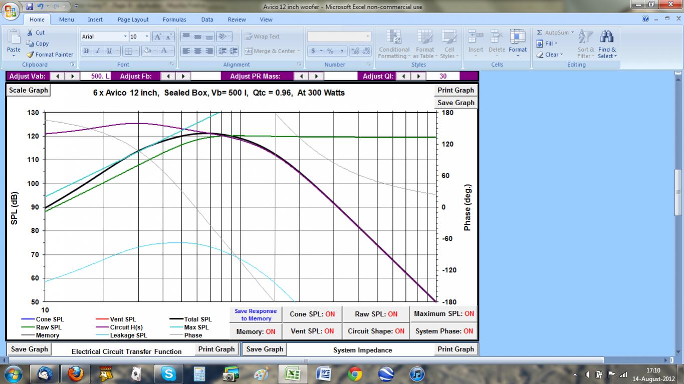

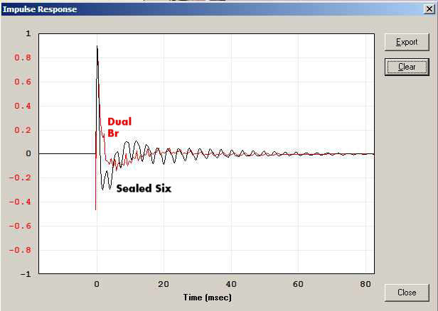

I think a tapped horn has to be in my "To do" list but for simplicity I really do think the party bass needs to be sealed. partly because it is just easier but also with a fairly high "Qts" and limited excursion the "Ideal" ported box will exceed 2500litres and give a very peaky response.
Sealed with parametric 12dB @ 30Hz EQ looks better on the plot Probably a lot easier to pass to the mid-tops around 200/250 as well although the plot shows 4th LR ( I use a cheap Behringer CX unit with this mixer 0 at 135

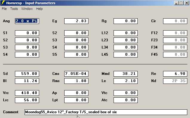

here is my sub modelled on hornresp.
note: 2subs wired in parallel on 300w between them. simulated in an open field environment.
edit: note, wave form above 120db from 35-100hz
compared to only 50-90hz on the previous simulation..
edit2: also note, 30-60 = octave 60=120= octave, so in essence, a tapped horn is capable of 2octave frequency response.
