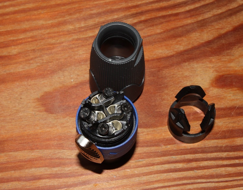

This is some blurb from Neutriks site page on the NL8FC cable connector:
"They feature solid contacts with screw-type terminals including a stranded wire protection which offer also solder termination."
I interpret it so that they can be used screwed or soldered or both on the same plug as there does not seem to be a solder only version. Would let you solder them without holding the cable too.

I have the NL8FC plugs, and the wire receptacles are little silver-plated brass holes, about 3.5mm, with a thread tapped in the side. You get a grub-screw and a little bit of folded metal that squashes the wire under the screw so that the screw won't mangle fine strands. You can remove the screw and solder directly in if you want. The strain relief is pretty good so I just screwed mine in.

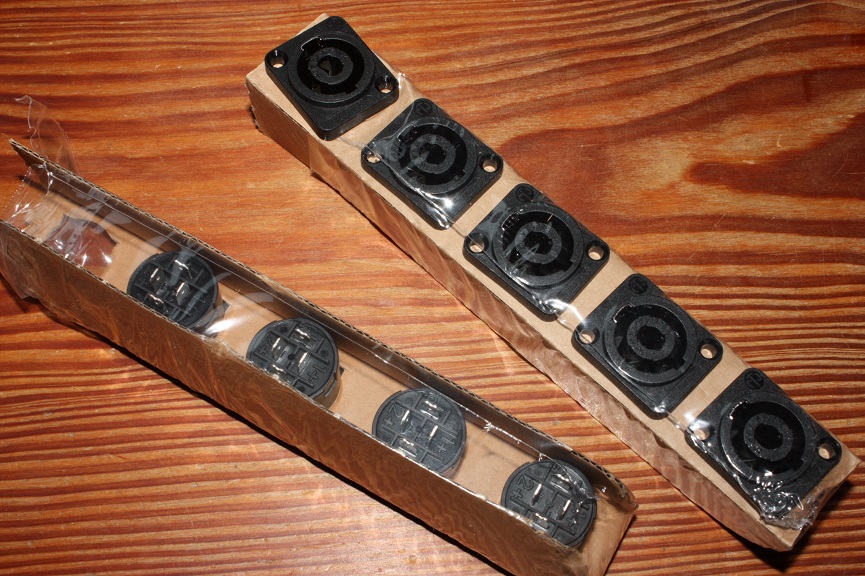

the chassis part is cheaper, and a small discount on 10 pieces
