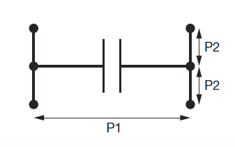

my vishay MKP 200uf film caps have six pins!!!
cant find any indication in the data sheet as to which pins are wgich?? Confused and need some advice.
Please
Strange that you have datasheet but not the required data Ime there is usually printed code to describe the +/- pins. It can be many caps in one package or just one cap with supporting pins. Check again any printed codes (or molded on the base near the pins), or other graphics code and painted pins
Its a vishay MKP 200uF. 450v Its grey, square, has 6 pins out the bottom and no markings anywere. The data sheet indicates six pins but not how they are connected. think i have it sorted with the meter but i would like to [email protected]
You're right, I couldn't find anything there either. Take my poached drawing [from another Vishay datasheet] and DUG's elaborate "ohmmeter" message. Together they ought to provide the answer and nothing could possibly go wrong.
Yes. Three pins on one side continuos
Same on the other. Plates in between. 6 pins to stick it to a PCB
If I was making them I might add a couple of dots or something. They don't give them away!!(the capacitors)
