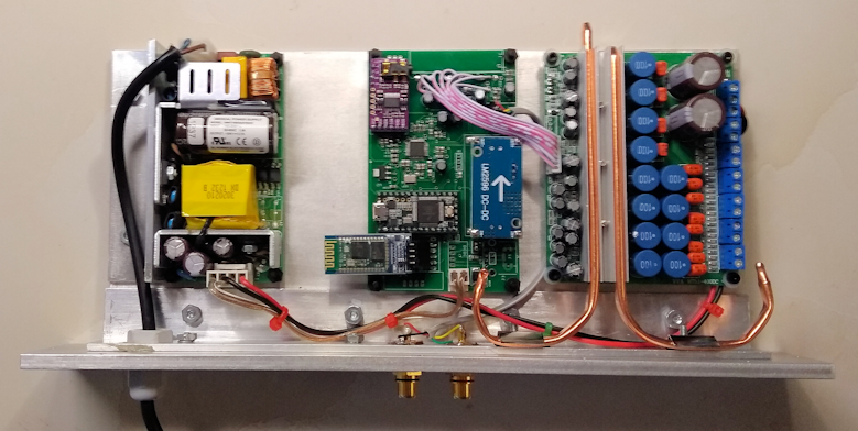

I've used that 6-channel amp for two different projects. It works fine, but you will need to be very careful about running your grounds or else you will have a lot of noise from those 6 amps switching at the same frequency. This link shows the amp I use for my computer speakers, which makes them active 3-ways.
I've got another version underway with that amp shown in the picture. Both of these projects use the "Revision 2" stereo 3-way ADAU1701 board described in this link. There is a new version of the board on the workbench, awaiting some parts, that uses the $16 ADAU1701 learning board. That one should be very easy to build, as it has no SMD parts.

The noise problem is due to switching currents in the ground lines, and balanced inputs won't fix the problem. There is actually an error in the picture--it shows one of those LM2596 DC-DC converter boards to provide the 5V for the DSP from the 24V. That configuration will result in lots of noise, even with no input. There is also lots of "chatter" whenever the Bluetooth interface is used to control the DSP. I need to replace that non-isolated DC-DC converter with an *isolated* 24V-5V DC-DC converter so that the DSP and amp only share a ground at the amp input connection. I forgot that I had done that on the other amp that I made.
I use smaller power supplies, in the 75W-200W range, because there is no way you will ever need 50W continuous from each amp for music. The power supply in the picture is just a $10 65W supply from MPJA. This amp will be for a 4" tall 3-way computer monitor stand using 2-1/2" "subwoofers", so I didn't need a lot of power. The other amp uses the Meanwell UHP-200, which is 200W but it is about half the size of their other 200W supplies.

Interesting. I had planned on using the Mornsun b0505s-1w type DC-DC isolators for both BT and DSP boards coming from one of the LM2596 boards you used, hopefully that will keep things clean. They will all have their own ground but I am not sure of the power consumption of the boards so I don't know if they will be enough.
Which isolating DC solution are you going to switch to?
Are there any other provisions I should take to help keep noise down?

I've got a 5V to 5V isolated converter on that PCB to power a WiFi module, but the DSP also needs to be isolated. I use the Meanwell modules: SMU02L-05 for 5V to 5V and SPB05B-05 for 24V to 5V. They about about $9 or $10 each from Digikey or Mouser. 3W output is plenty--it's over twice what is needed, even if you have radios (WiFi and/or Bluetooth). You don't need the LM2596 board--just use the SPB05B-05 to go from 24V to 5V.
That Mornsun module should work OK for the DSP, but it does not provide enough current for Bluetooth or WiFi modules.

Seeing as you did not use these amp boards with any anger you may not have bothered but do you think the large capacitor needs to be upgraded?

No. According to the TDA3116 data sheet, the main filter capacitor should be 100uF or greater for each chip. Using a larger bulk capacitor won't improve the performance, and it may screw up the feedback loop in the switching power supply. If you feel the need to "upgrade" the filtering, add some .001uF and 1uF low ESR ceramic caps as close to the chips as possible, as suggested in section 10.1 of the data sheet.
