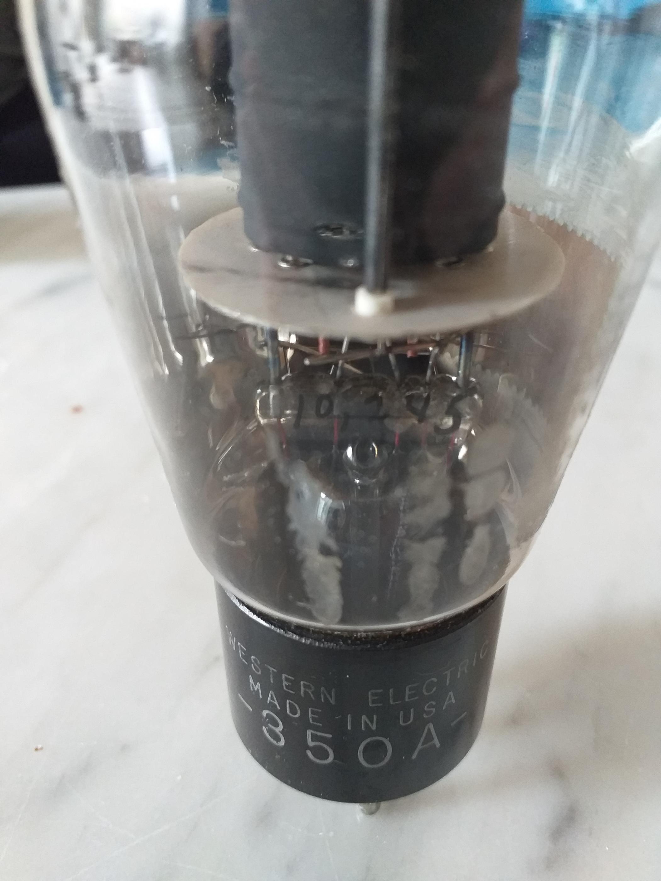

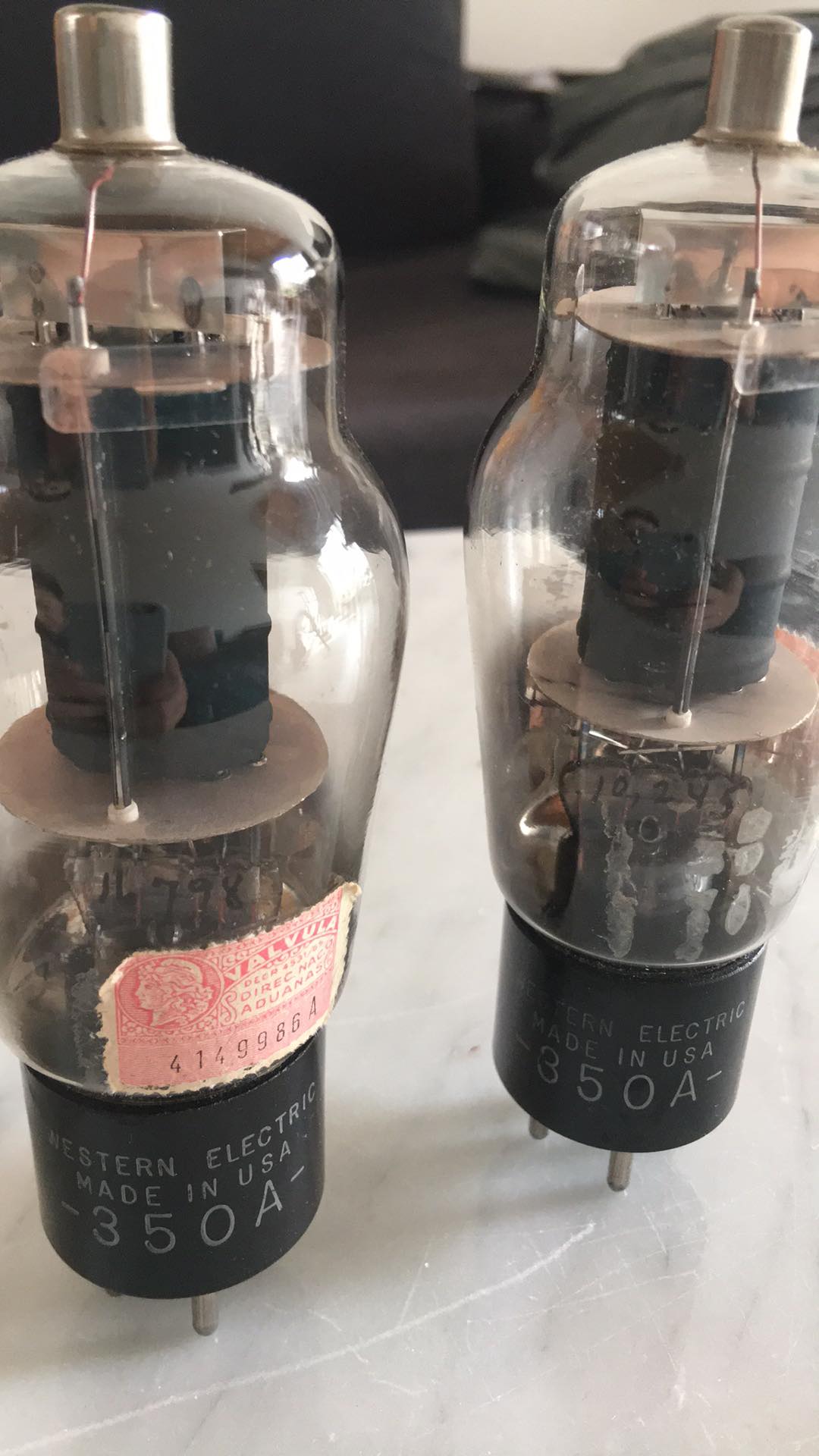

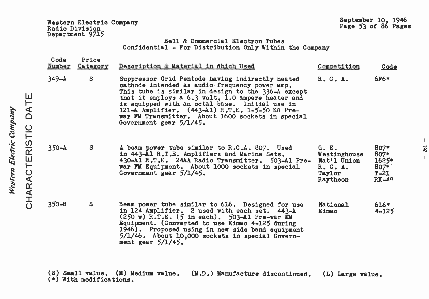

I am building a amplifier ,i have a 4.2K 40% OPT, one pair of Sylvania 6550 ( 40W dissipation ) and other pair of Western Electric 350A ( 28W dissipation ).
Could get 10W UL with the Western Electric 350A Beam Tetrode ?
According to WE is equal to 807 tube.

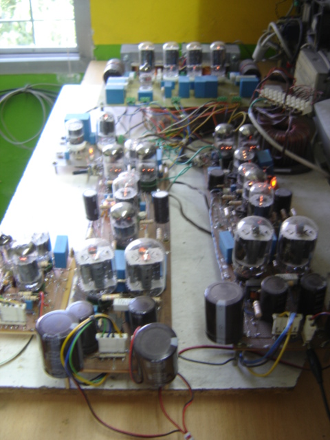

Let me skip an opinion, I am not skilled on those old tubes. My tendency is to use the most modern ones, mainly compactron with very enhanced characteristics over those. I am currently working on a DC coupled 6JN6 and may other compactron tubes.
Yes, 8 multiple tubes per channel, plus 5 for the rectifier board (4 damper diodes 6AX3 plus a 6DJ8 (four diodes) plus a regulator with a 6K11 and a 6FM7 and 3 more for the delayed relay unit. A lot of heat, but performs very well near I ant from it. Fully DC coupled. In a PM I may send the schematic and lots of photos, but still unfinished and not sure if I will make it public here.

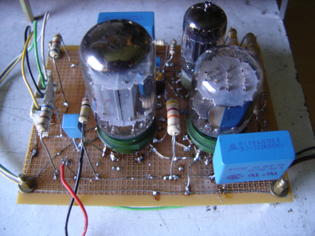

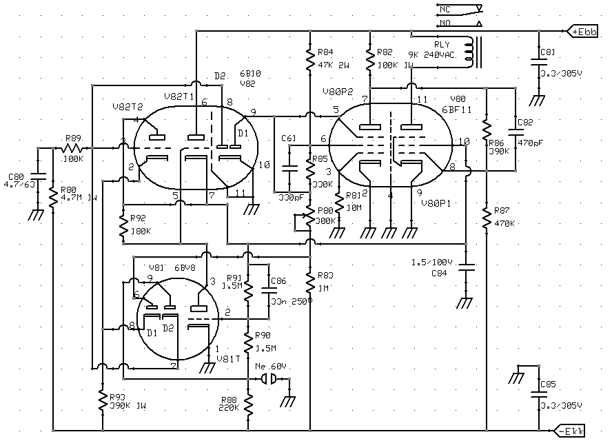

And there are some very interesting combination of tubes in one envelope. For example, a 12AU7 plus a ½12AX7, with one power heater, 6.3V 600mA. One of the triodes is "free" of filament power. Also, I am working with the uncommon 6BF11, a compactron with one power section like a 6AQ5 plus a pentode like the 6AS6 or 6DT6. The pentode section performs excellent as a Schmitt trigger screen coupled, as the very unlinear characteristic of its screen and supressor make it ideal for signal signal conforming. Here is a little example.
My apologies by the off topic.
