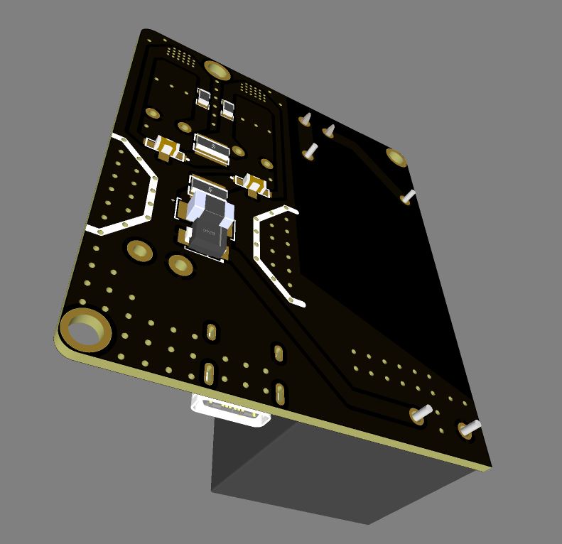

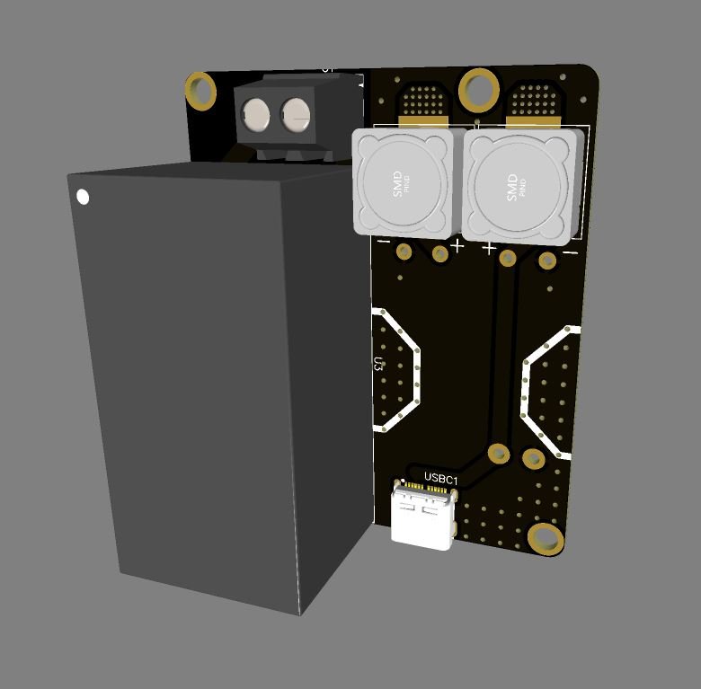

Anyway, OP has an Wiim Pro Plus and wants to build/obtain an improved PSU so back to topic please. If one wants maximum improvement a better PSU and better connectors are a good combination. Both are generally picked for lowest cost, not best quality.
That is why I gave the tip where to find the IRM in 5V 4A version and the 12V 1.8A version for 3.99 Euro. Plus free advice, free Gerbers and my time for free. Leaves budget for a better connector. Total picture please.

Just tested it, works proper, so i'm posting gerbers this evening. Will ping this thread.
Both usb-c and aux for dc barrel. There is also led pilot light pads to attach to the box of your choosing so you know when it's on, nice feature to have.
