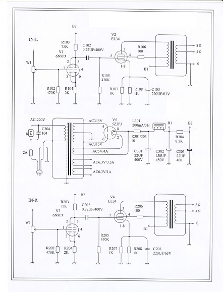

Eli has a copy of the schematic and checked it all out. Did a few other mods to get hum lower and make a better input impedance match for my tube preamp. Any way, here's the original schematic. Funny how the amp would run most of the day before it would arc. The new mods aren't shown. Some day I'll draw them in.

Okay, so as long as your current draw doesn't fall below the magic minimum for your choke, the 5U4 doesn't "see" the 150 uF capacitor. All would be well. However, if the current draw does drop too low, then that 150 uF capacitor could possibly give the 5U4 a headache. Can you keep a watch on total current draw? Maybe an ammeter temporarily can help you out.

Just going by the diagram, it looks like there is no unusual stress on the 5U4GB. The peak inverse voltage would be @ 800-850v (the peak negative AC + the B+) depending on your actual B+. That's well under what a 5U4GB is rated for. You have normal to light 1st cap value so that's not a factor. A nice choke. Your arching would seem to be a failure of the rectifiers themselves, or a 1st cap that has a possible heat related problem or other downstream intermittent large current draw. Maybe an intermittent EL34.... But a normal good quality 5U4GB should have no problem handling the draw of your amp or the PIV on it. The diodes could be just masking the real culprit, and just crutching your amp.
