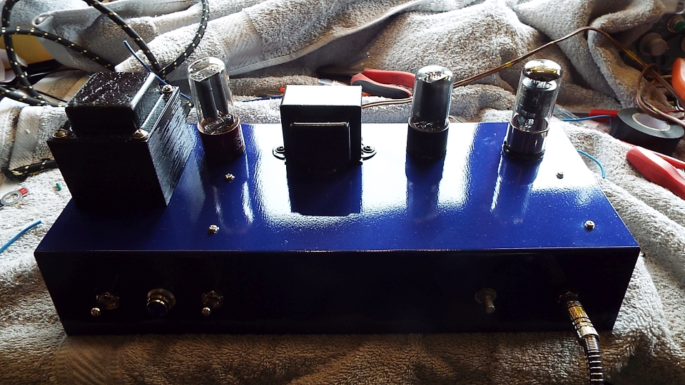

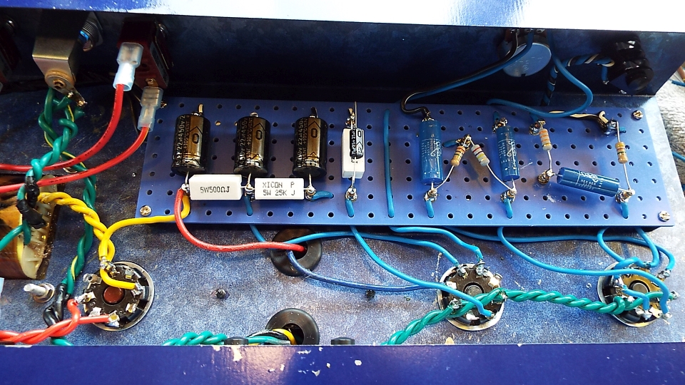

5C1 Scatch build (voltages ?)
Hi guys buildin a 5C1 anyone got a list of standard voltages, only got 1/2 a watt output 😕

mmmm its a touchy little circuit swapped out the 5z2p-j Chinese rectifier for an OLD rca 5y3 lifted voltages thru amp by about 3 volts now i have a peek of 3 watts hum/hiss is milliwatts (ok i know this is not a high gain amp but its signal to noise ratio is the best I have ever built) would like to get it up to 5watts but will wait till i bring home my good dvm from work.
also i have a 6j8p-j in v1 (it is supposed to be an equivalent to 6sj7) may take sum tweaking

here are the voltages dc voltages with tubes in
V1 6J8p
1 0
2 heater
3 0
4 -001
5 0
6 23
7 heater
8 159
v2 rca 6v6gt
1 no con
2 heater
3 357
4 366
5 0
6 no con
7 heater
8 22
c1 369
c2 366
c3 344

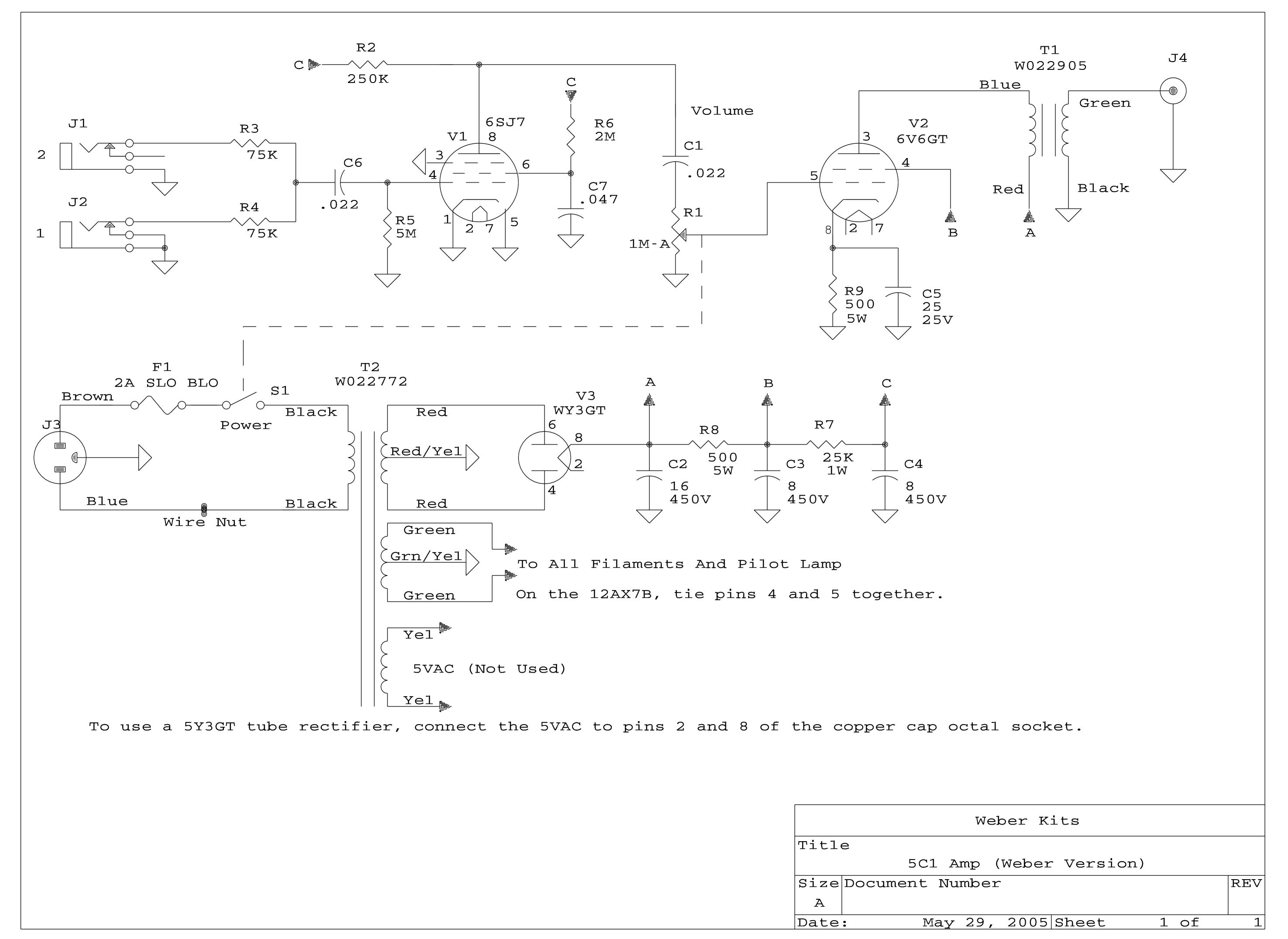

using webber 5c1 schmatc

Note that depending on what meter you are using, it will change the bias on the input tube when you measure the grid voltage, and the reading will not be accurate. The old vacuum tube voltmeters had a 10 or 11 meg input resistance. Most modern meters are lower. The $4 meters I get at Harbor Freight are about 1 meg. You are putting this in parallel with a 5 meg resistor, and the result is no longer 5 meg.
If you have 2 meters, put one on the plate and see how much the plate voltage changes when you probe the grid with the other meter.
