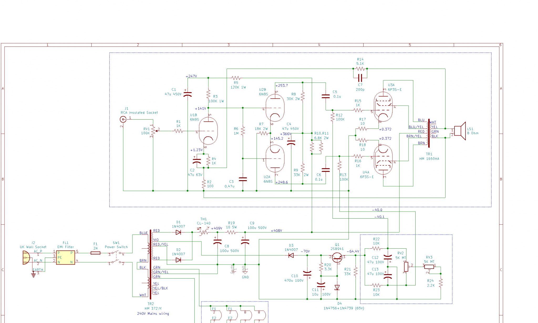

410V UL push pull, 20W Pq. They don't break a sweat.
