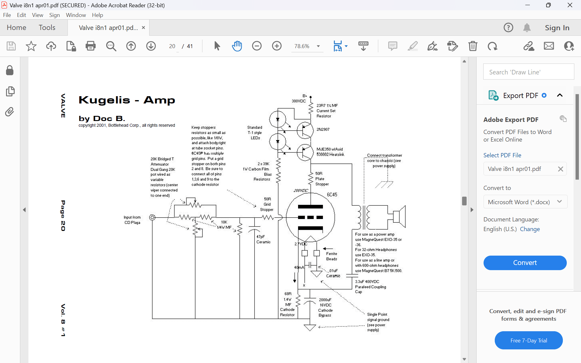

@rongon, I use the 6S45P/6C45P quite a bit, indeed I used them in Mr Potatohead referred to earlier in this thread.
My recollection is that the tube's Rp is closer to 1200ohms, maybe even a bit less. It is basically the ruskie vesion of the 437 iirc.
Other than that I agree with everything in your post. 🙂
The Altec 15095 strapped 15k:150 used i Mr Potatohead is a 10:1 step ratio, and it drives my HD600 (300 ohm) and HD25 (70 ohm) with no problem in the bass are at all. A 30 ohm load might be a bit borderline though with output from the plate to the primary of the parafeed OPT.
The OPs Sowter 8665 (which should sound very good being 50% Ni, imho) strapped to 12:1 should reflect about 5k ohms with a 30 ohm load which should be just fine for the 6C45P/6S45P if the output is taken from the tube plate..
Mr Potatohead is similar in execution to Doc B's Kugelis, see below, except I used a cascode depletion mosfet CCS and a 1.7V LED in the cathode and a lower B+ (150V) and 20mA through the tube. I didn't write the curcuit down, but I "might" have taken the Mu output of the cascode CCS instead of from the plate. I think I used a standard 50k ohm audio taper pot for volume control and used a 100ohm plate stopper rather than the 50 ohm indicated in the Kugelis circuit.

@yan24 it isn't my drawing, sorry. 🙂 It is from the now defunct Valve webzine. My understanding is that the CCS shown is a representation of the Bottlehead C4S circuit, which I believe is sold commercially, so it could be a deliberate misrepresentation or more likely an unintended error.

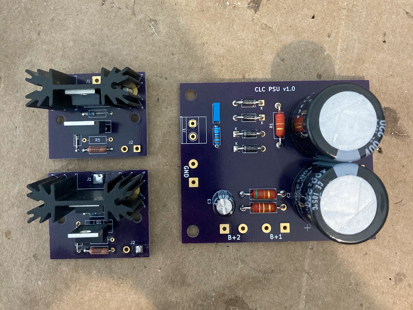

The project is still alive.... I ended up with mostly the Papa Rusa with some modified construction details.
The build will be mostly P2P with the CCS and PSU on PCB's.
PSU is SS bridge rectifier (1k+1nF snubber) and CLC 220uF-5H-220uF.
The CCS is the cascode DN2540N5 as described in SY's HMN and ImPasse projects.
The CCS PCB will be mounted directly on top of the tube socket (as shown below)

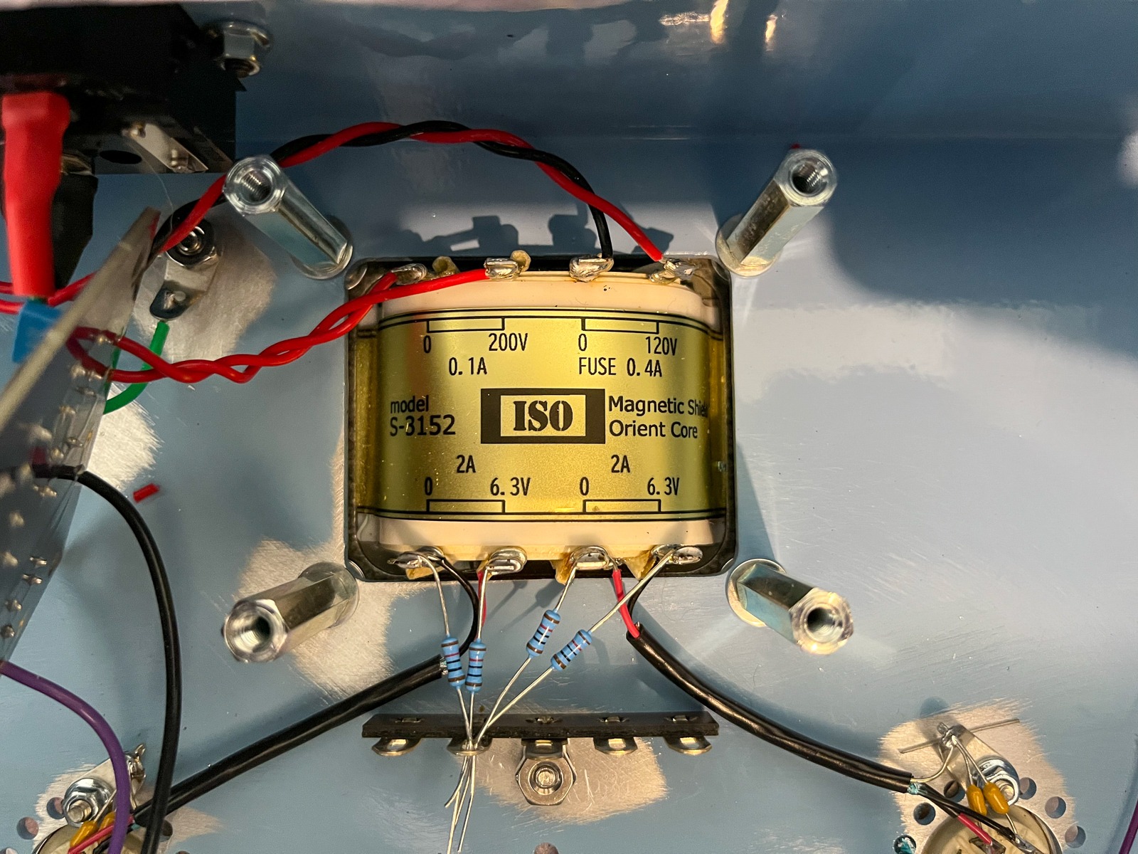

AC heaters elevated to ~50V DC with 10nF ceramic caps from the heater pins to chassis.
I also realized I have enough parts to build more than one, so first a prototype with the Hammond 269GX PT and Hammond 119DA output transformers and the final build will be with a nice ISO(i.e former Tango) PT and the Sowter 8665A.

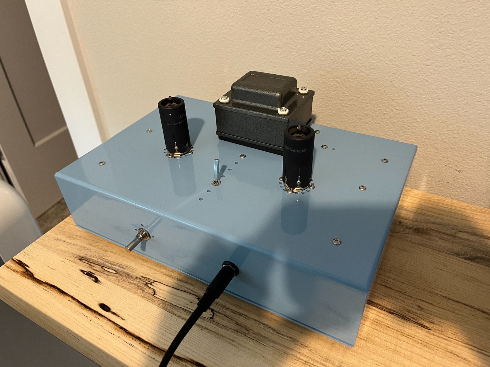

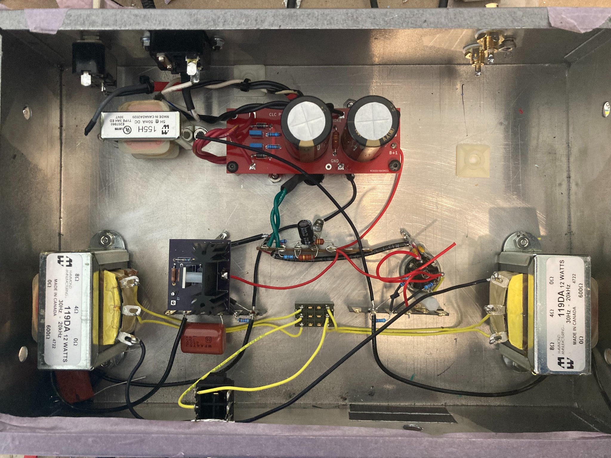

Almost finished with the "prototype" build ... the amp is silent (no hum or buzz) and sounds VERY good. Unfortunately, it seems like one of the 119DA was faulty since I was getting no output from the 8ohm terminal, so I need to replace it.

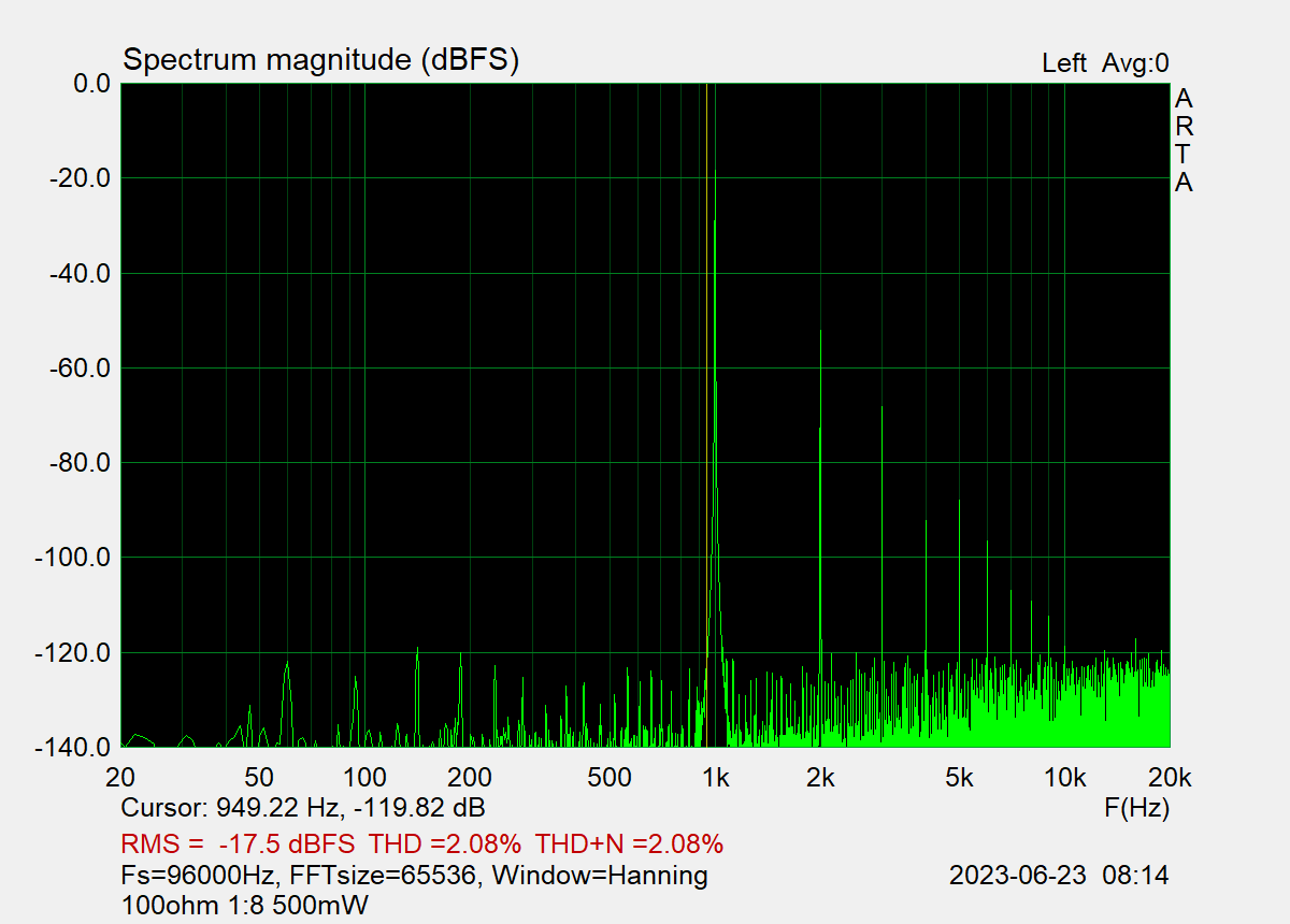

Total power is impressive, over 500mW to 100ohm headphones and easily 150mW+ to 300ohms.

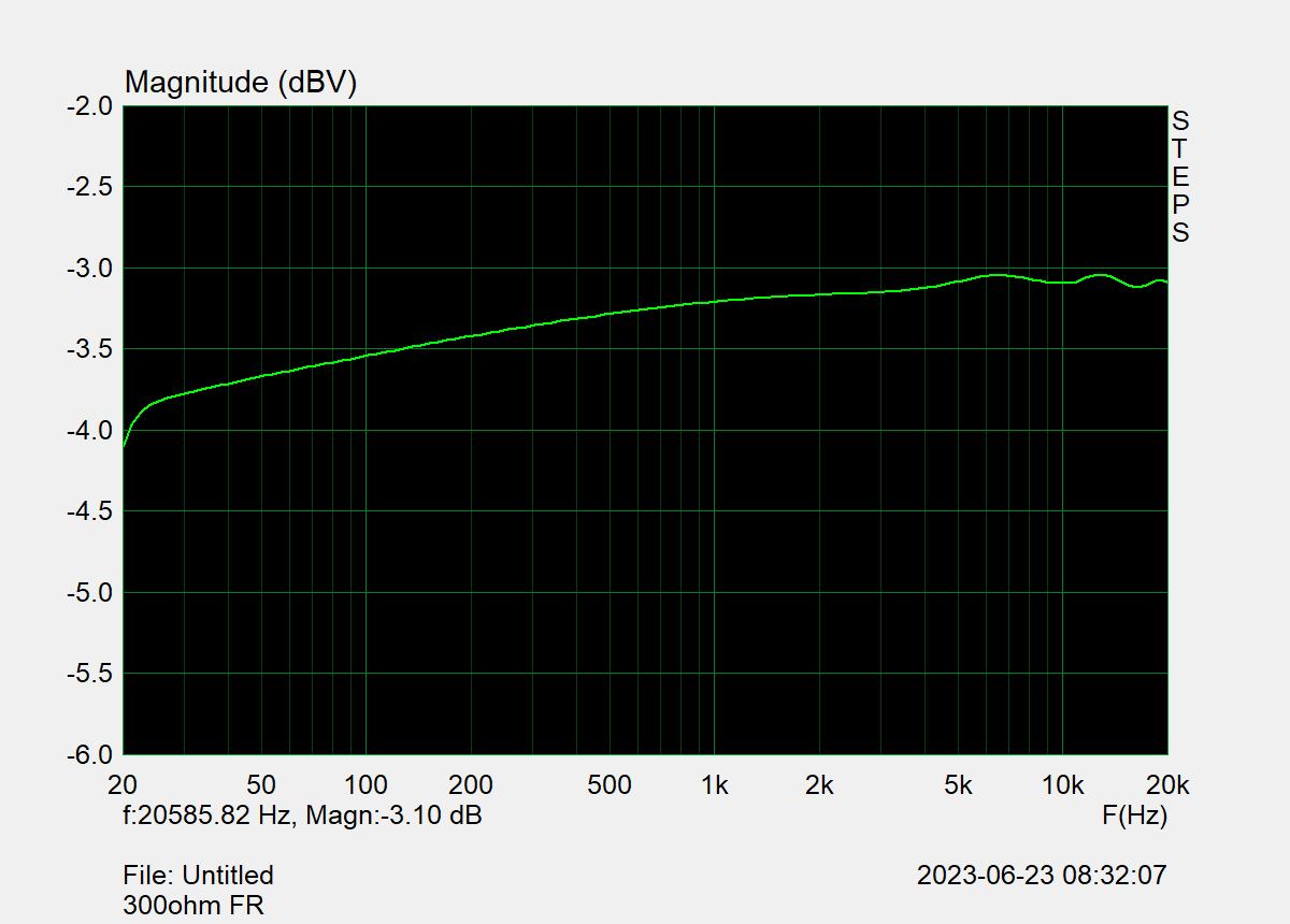

FR from 20Hz-20kHz is within 1dB, but definitely not as flat as the tests with the Sowter OPT's. Although, a pair of 119DA costs half of a single Sowter so definitely a cost-effective solution.
I will post pictures of the external builds once finalized.

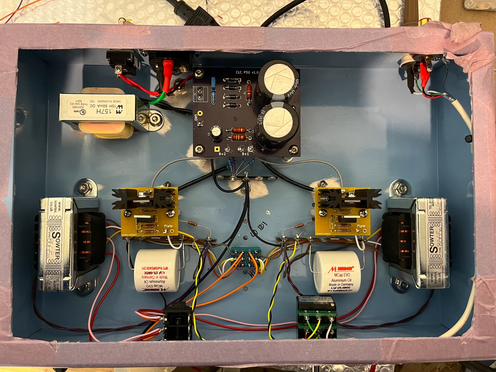

I finished the second build, this time with D3A in triode mode and Sowter 8665 transformers.
B+ ~250V (CLC power supply, 220uF - 10H - 220uF)
Ip 20mA (CCS)
Vg -1.41V (70.5ohm resistor)
Vp ~140V
I initially used an IR LED with ~1.37V forward voltage but the frequency response and output power were not as good as with the un-bypassed resistor.
Overall lots of power (less than 6C45P though), good frequency response. No hum or buzz. Sounds very good.

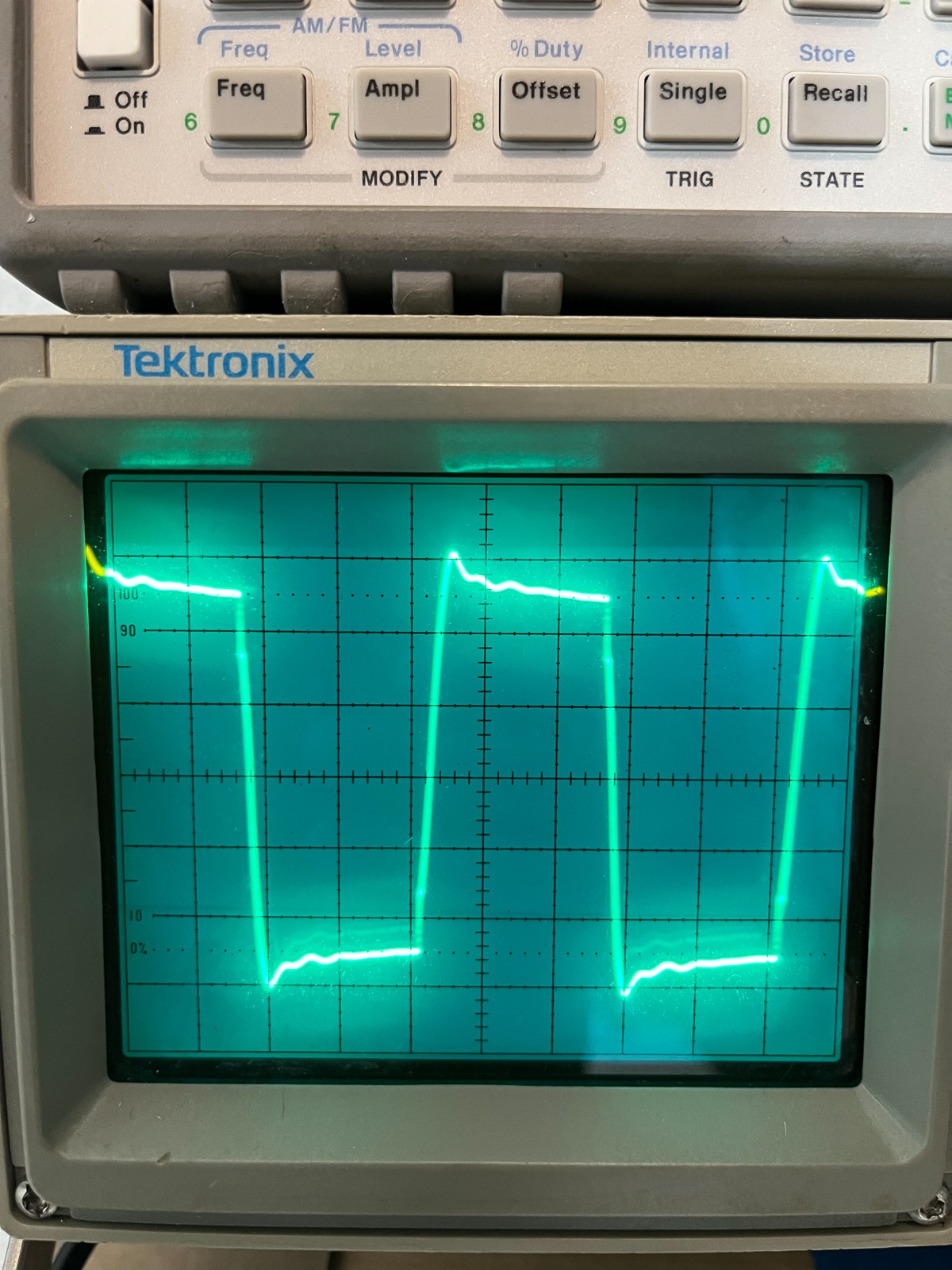

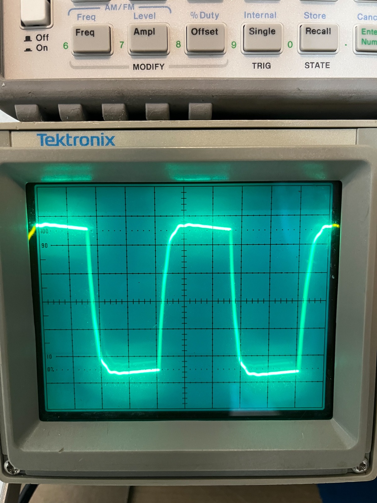

Attached is scope view of 10kHz square wave, 100ohm secondary, once with 12:1 and then 6:1.
With frequency response scopes, there is visible HF roll-off in 12:1.
What can I learn about these? Is there any oscillation that needs to be addressed?
