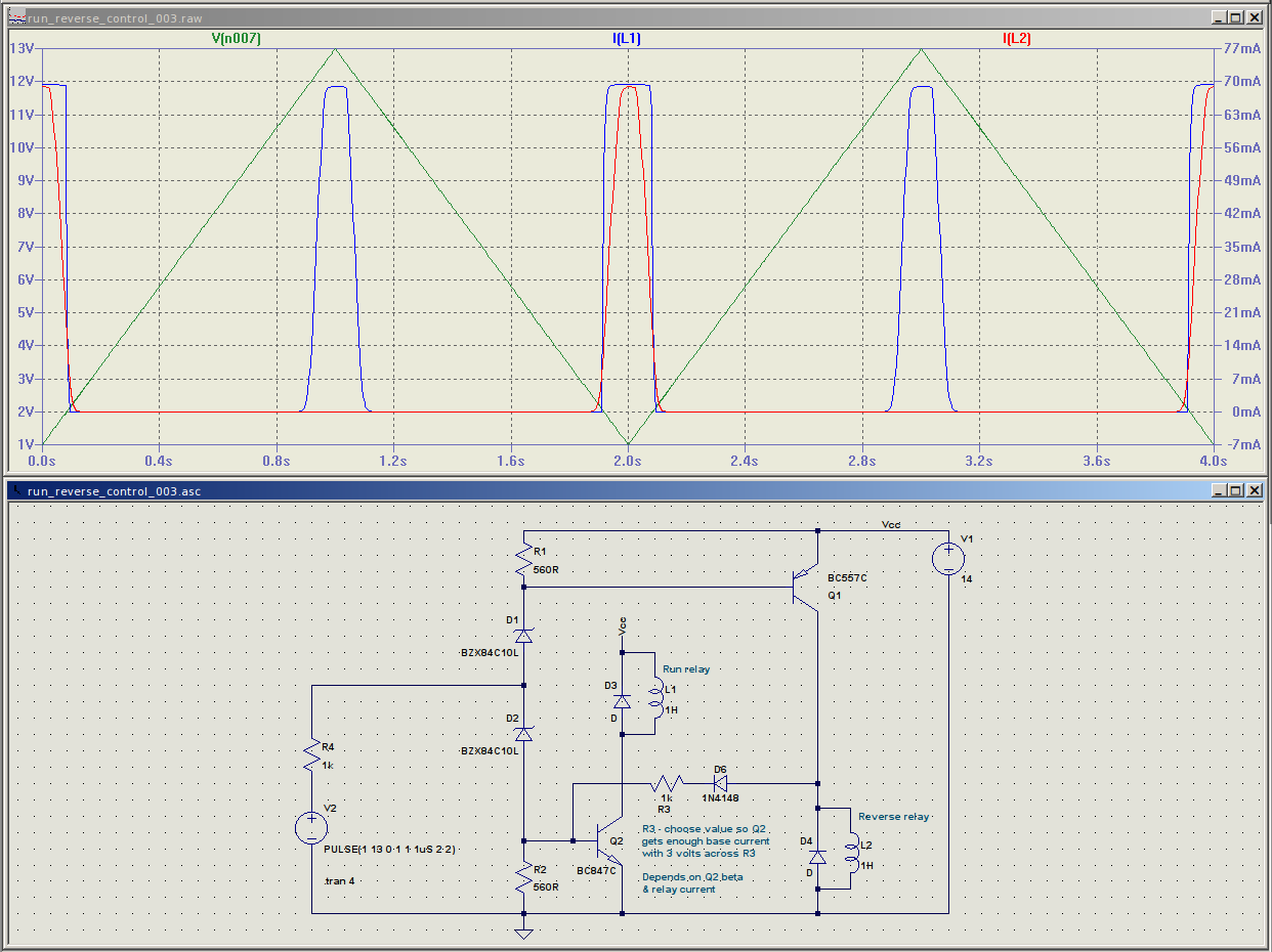

The two transistors shown are suitable for an actuator having forward and reverse relay inputs. The device apparantly has run and reverse inputs. A couple of 4093 nand gates would have sorted that out, but the CMOS maybe zone between 1/3 & 2/3 input voltage means they could oscillate when the motor is supposed to be off. As one transistor is at top of relay and other is at bottom, can't use one diode to or reverse into run relay. May have to use two 393 comparators to decide forward and reverse, then use nand gate to turn that into or (forward or reverse = run). I'm not sure, it is hard to read the blueprint, one reason I gave up on repairing the replacement control board. There is a big TO3 darlington npn transistor on a huge heat sink driving "run" relay I think, then the reverse relay drive apparently comes out of two TO92 transistors used as a darlington.
Don't have 9 v zeners, using a stack of yellow LED series 6.8 v zener to simulate 8.4 v zener. Problem now is that my "12 v" home power supply is putting out 18.4 v, so current will flow all the time through the double stack zeners. Have to load it down somehow. Actual organ power supply is regulated to 13.5 to 14 v by 8 parallel 2n3772 transistors.
First cut I'm using 3900 deadband resistor instead of 2000 ohm. I can easily tack a parallel resistor on top to lower value, whereas removing and replacing resistors can lift land off the project board. I'm going to use two DVM to determine how big the dead band is, and whether it stays constant over the .6 to 4.8 v input range. Reason for yellow led, I don't have a 3rd meter to determine what the transistor stack is putting out.
Driving to my nearest parts store would be a 330 mile trip. If there is a Fry's in Chicago. I'd have to rent a car, too, I don't run one anymore.
I thought "run" meant "run forward", while "reverse" meant, well reverse. Evidently I misunderstood. Sorry!
So: you have to turn on both the "run" and the "reverse" inputs simultaneously when you want the motor to run backwards, correct?
That's an easy fix. All you need is to add one diode and one resistor to the existing circuit. Schematic attached. No CMOS or comparators needed at all. 🙂
D6/R3 turns on the "run" relay any time the "reverse" relay is actuated. D6 blocks any current to the reverse relay when the forward relay is enabled.

Thanks again. Your diode to base of Q2 is elegant. Unfortunately, both bottom sides of the coils of the two relays are common to minus 14 v. As I lay on my belly to work on the device under a pipe chest 36" off floor, I'm trying to avoid rewiring that. Organ supplier tends to wire relays/solenoids with a 300 W electric iron, so I'm not confident of moving the wiring around with my iron reliably. Also, pipe organs always put the relay coil flyback diode on the electronics board instead of on the relay. Since 1n4001 didn't get under $.10 until ~1965 and lots of pipe chests full of solenoid valves are in use that are older than that. Yes, run has to be on, positive current flow in wire, at same time as reverse. I think. Not expecting package solution. Looked again at op amp inventory, have 4 in 1 339 comparator ICs instead of 393, so plenty of those in one IC. Spent day making a new 12 v power supply, installing 680 ohm resistor+yellow LED+6.8v zener resistor twice stack, disarming the 4th op amp of 4558 from oscillating, mounting DIP project board to bare transistor/power board. Buzzed the wiring.
Since not confident I can get more than 6 ma out of 4558, and they swing voltage pretty well, & beta 20*6ma is 120 ma out of a TIP31C or 32C, planning to use generic nfet & pfet to switch relays 1st case. 5 v across 680 ohms & yellow LED should turn on gate. Pfet (IRF5210) hangs source on the + rail, drain to the relay coil. gate to junction top yellow led & 6.8 v zener Nfet source goes to lower relay coil. Gate to junction bottom LED & 6.8 v zener. Wish GEDA (linux schematic drawing pgm) wasn't such a PIT* to use would draw it. Will take control board over to church this week after select dead zone resistor and try first with fwd & reverse relay drives from *fets, (which I don't think will work, but relay wiring is not on the blueprint they gave me). Shouldn't hurt anything, if motor runs forwards & not backwards then my suspicions about run & reverse would be confirmed. Nfet & pfets have flyback diode in the transistor, anyway. thanks again.
...both bottom sides of the coils of the two relays are common to minus 14 v.
What do the other ends of the relay coils go to?

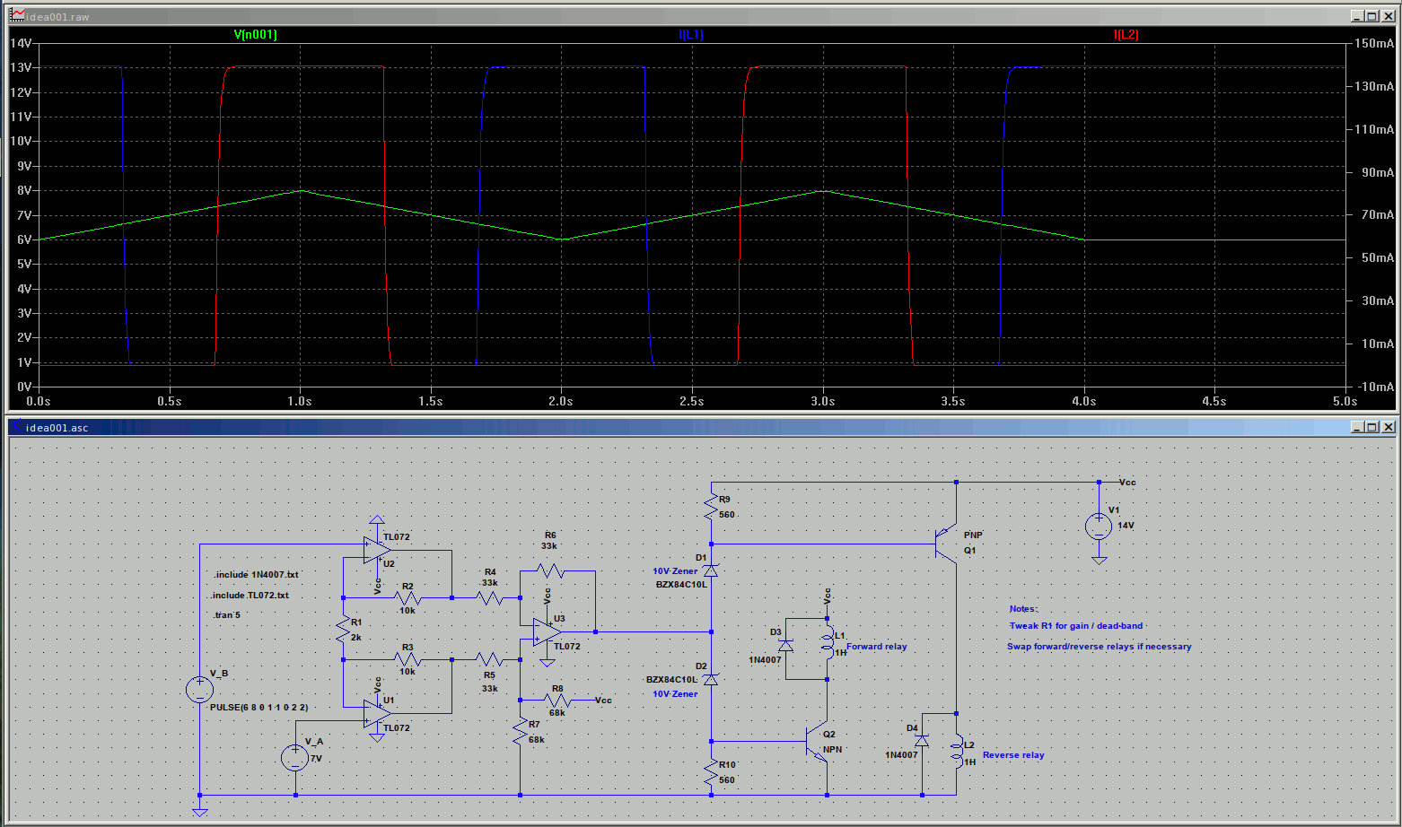

I see you mention N-channel MOSFETS later, I was going to suggest something similar...but watch out, turn-on voltage for a MOSFET is usually several volts, while a BJT needs maybe 0.7 volts.
If the op-amp output swings to, say, 1.5V, and you have a 14V supply, that leaves 12.5. If the MOSFET wants 5 volts of that to turn on, the zener shouldn't exceed 7.5 volts.
The gate-to-source resistor for the MOSFET can be considerably bigger than the 560 ohms I suggested for BJTs; you don't need super-fast switching, so you can easily use 10 kilo ohms or more here. (It will take longer to drain gate charge out of the MOSFET, so switching will be slower, but still millions of times faster than the motor relays.)

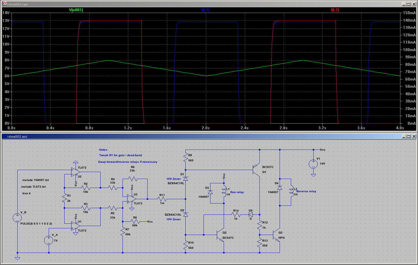

Do the relay connections in the attached image look right? (Q2 & Q3 being the existing NPN power Darlington transistors driving the relays in the organ.)
If so, the schematic in the image should do the trick. The only change is that the signal to turn the "Run" relay on (R14/D5) is now taken from the collector of the PNP driver (Q1) rather than straight from the relay coil.
The waveforms show that things are working as they should - when the red line (reverse relay current) jumps up to maximum, so does the blue line (run relay current). The red and blue lines almost overlap, but if you look closely you can see that they are both present.

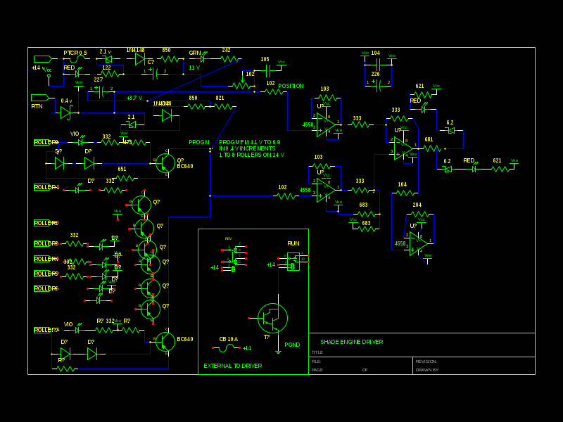

Here is the GEDA schematic so far. Driver transistors not installed yet. Think low current on 620 ohm resistors in stack comes from using 12 v power supply instead of 14 v in actual device. The top & bottom 620 ohm resistors in stack are swinging 0.63 v which is 1.05 ma. Will have to increase value of those resistors, or find an actual 14 v power supply, to drive base of any switching transistor Q2 Q3 from on to off.
That will certainly make a difference, but you have also inserted a 680 ohm resistor in series with the op-amp output, which is not in my schematic.
There's no need for that resistor, because the op-amp will have short circuit protection at the output, which will limit output current to a safe level. The zeners (and the LEDs you added) will drop most of the supply voltage, so there won't be excessive power dissipation in the op-amp while the output is shorted, either.
I suggest either removing that 680 ohm resistor entirely, or jumpering it with a much lower value resistor, to see if that gets you enough drive for the transistors. You can also increase those 620 ohm resistors, but the LEDs will get dimmer if you do.
