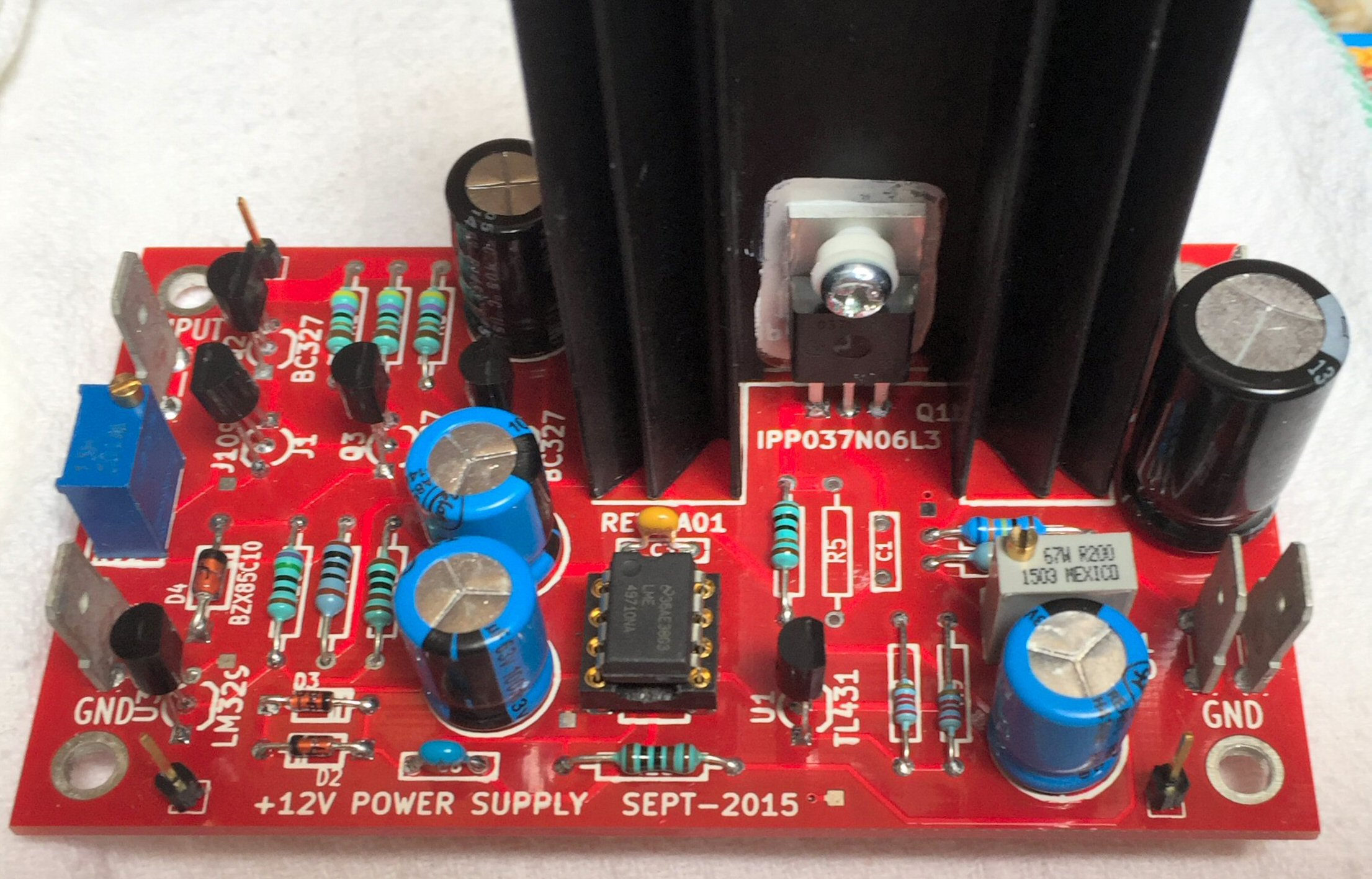

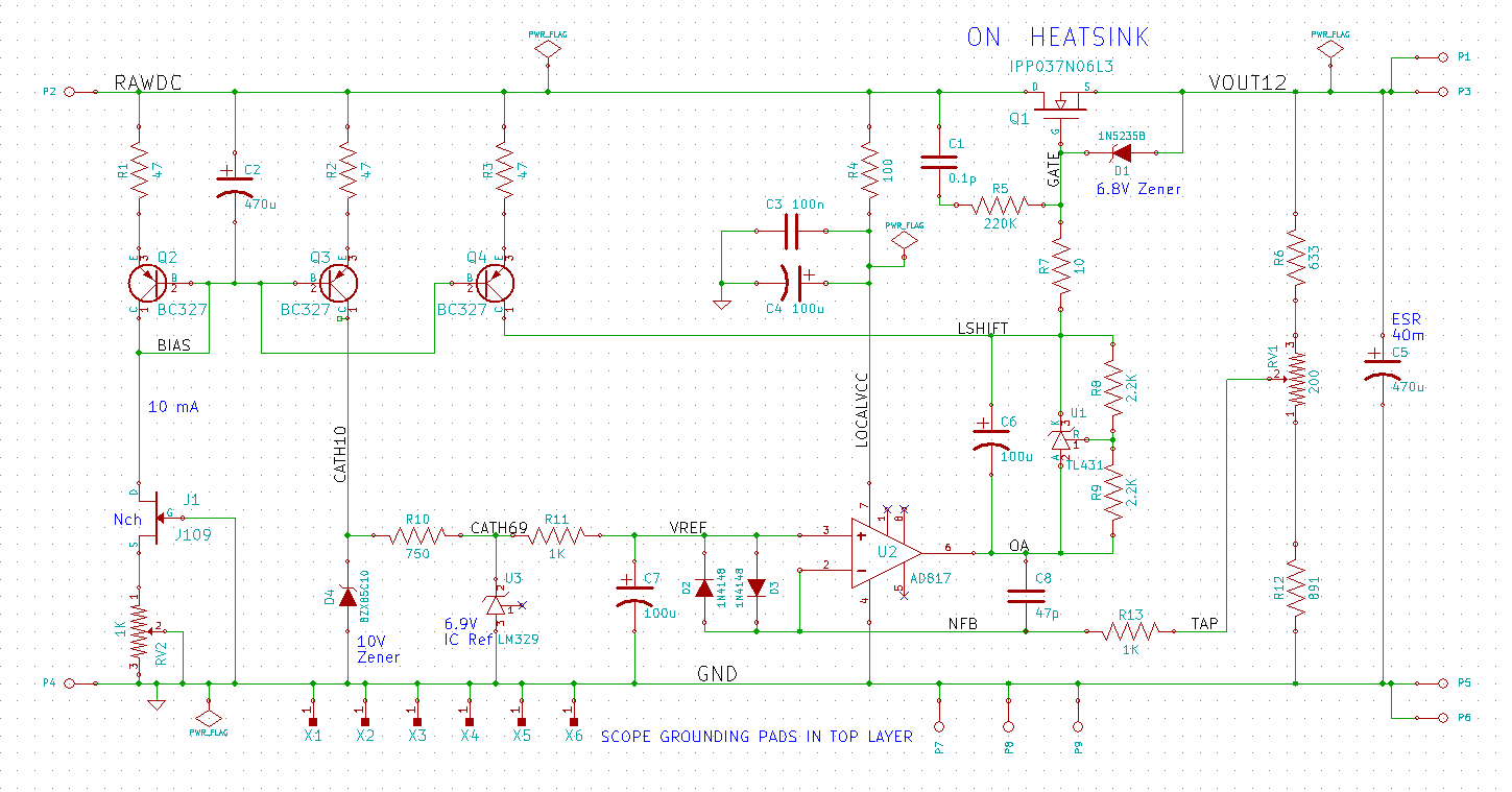

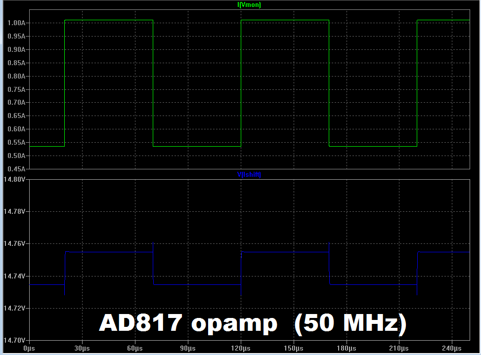

55 MHz opamp + MOSFET pass xitor in 1 amp Voltage Regulator
why use a tl431 voltage as levelshift (1/f noise in the loop) ? why not use a resistor as there is a current source feeding it ..
Please feel free to do that if you build your own regulator. With a 10mA current source and 5V drop you'd need about a 500 ohm resistor. Calculate the required value of C6 to get the performance you want, at both extremes of the frequency range, round to nearest standard capacitance value, and drop it in.
