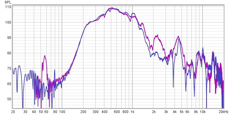

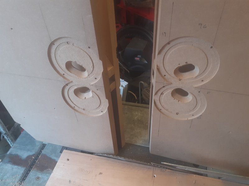

I've repaired the throat, decided to try and lower the mid front chamber volumes while the baffle plate was off and the router could get to the horn walls.
I've reduced the wall thickness to 12mm and lost the large gasket / spacer. Routed a clearance slot for excursion.
Waiting for filler to set and will measure tomorrow.
Am going to cut through the whole horn mouth end after to test the original Tom D style throat to see how / if the measurements change.

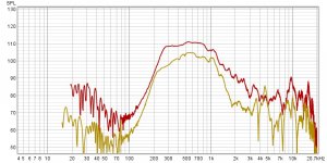

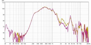

smaller chamber mids have a bit more top end response, but also now have a spike at 2.2k
smoothing the tweeter out with filler brought up the low end a bit. Am about to shorten the horn a bit to try the SH50 style throat.

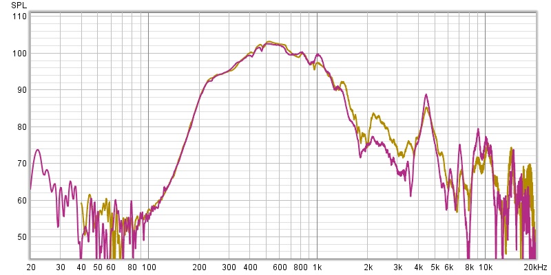

I've reduced the length by 8mm which makes the mouth of the horn 1" square instead of 0.7" square.
A little filler in the corners to smooth the transition. (using a 5mm thick aluminium plate baffle)
The TD style has a bigger dip around 5k but a little more around 1k.
The mids being closer to the throat shows the cancellation notch move closer to 2k. Tiny bit more output at 1.5k
Not much between them. I'll probably go with the smoothest response for the final builds. (Bwaslo style throat)

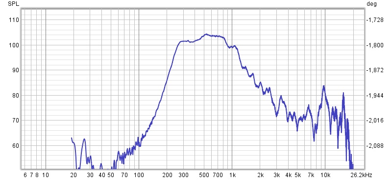

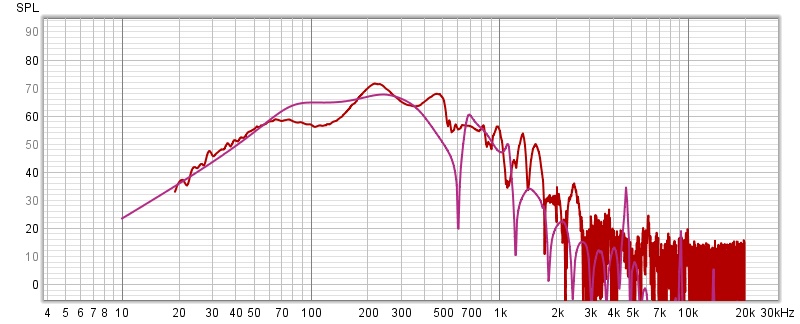

I've been modelling lots of 10's and 12's for the bass drivers. It suddenly occurred to me that I have my old Labhorn drivers sitting on the shelf. (was planning to use them for a multiple sub setup but they model ok with a 20 litre sealed rear chamber)
Hopefully will have them attached and ready to measure by next weekend.

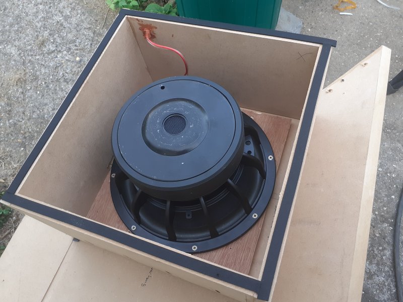

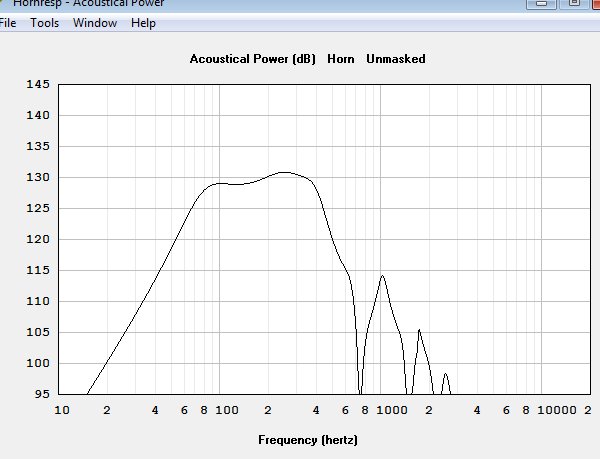

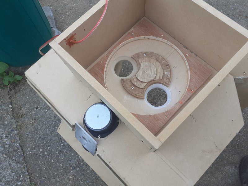

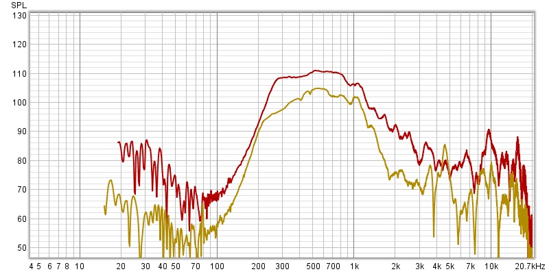

Finally got round to shoehorning the lab12s onto this horn. The drivers are way to heavy to use tbh but with all this covid business I can't be buying stuff on a whim to try.....
The pair of them were lacking in sensitivity badly and maxed out a 200w amp channel in my garden without sounding loud.(I did have a bit of EQ to flatten to ~50Hz, and to be fair the original synergy is ported whereas this was a sealed 4th order tap into the horn.( Too much velocity in the entry port.)
Not really a success 😀
A couple of pics of the drivers / rear chambers on the horn and a plot of sim versus measurement.
Pretty sure my final build is going to be a large 60x40 2way sitting on top of a double 15 cab, crossed around 250Hz. Possibly using 4 celestions per horn rather than 2. (Should lower distortion / allow a little eq at the bottom end if needed)
Rob.

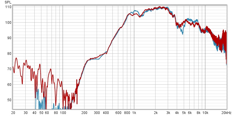

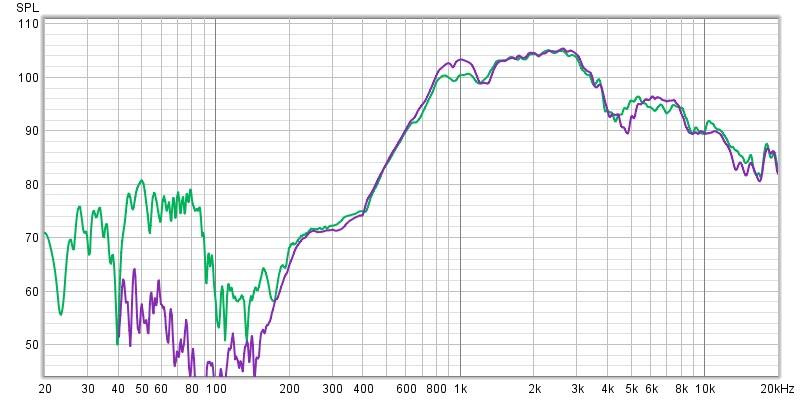

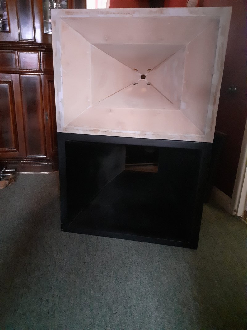

Full sweep in the garden this evening with a very quick eq/xo set up (no delays)
I ran out of time as I needed to get my steak on the BBQ .....

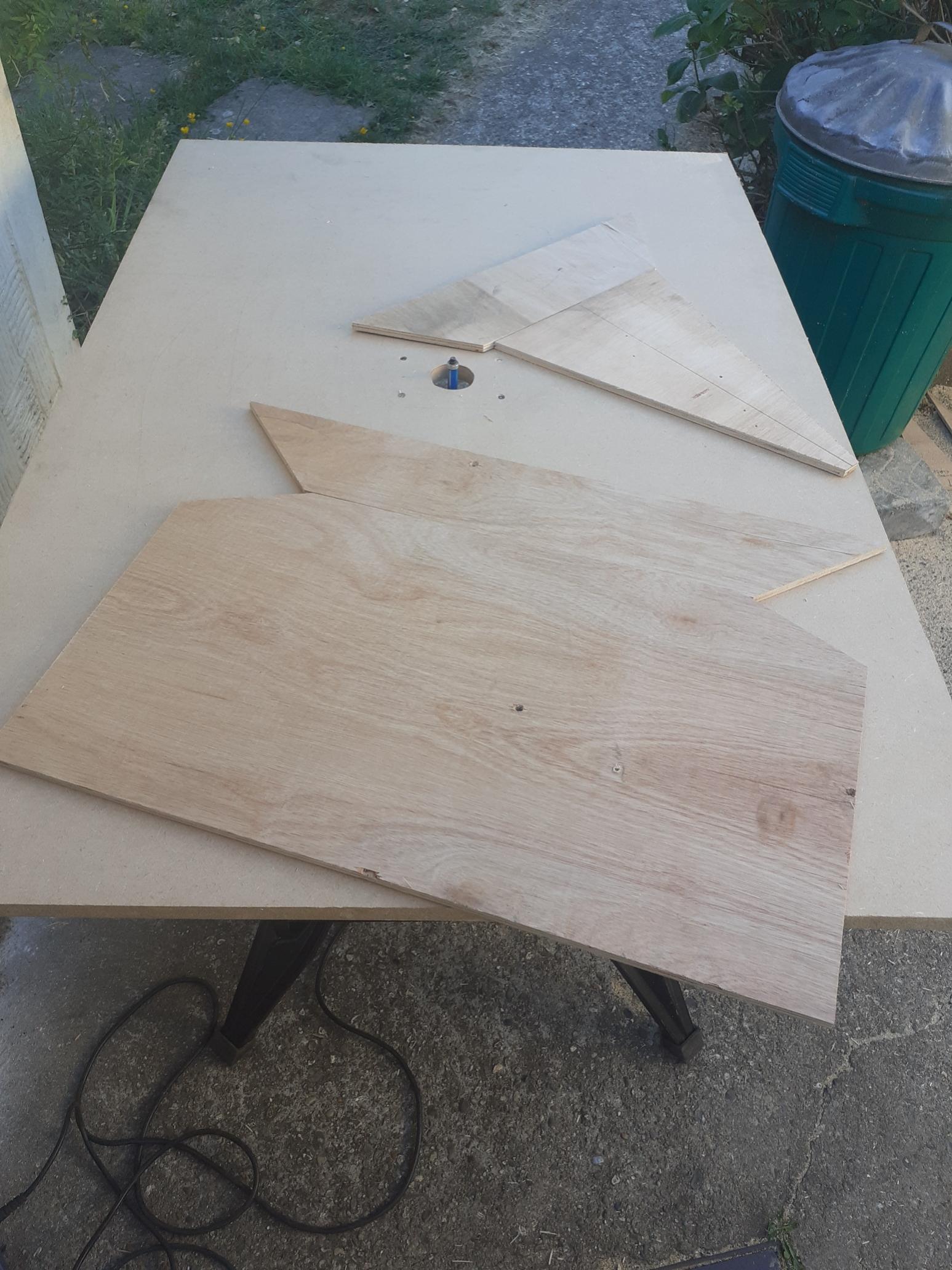

Nice day today, spent the afternoon drawing and cutting the templates for the final build.
Have decided to spin my Edgar style 80Hz horns on their side and place a matching width 60x40 MEH on top.

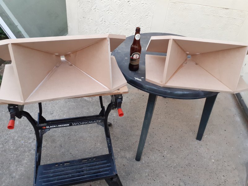

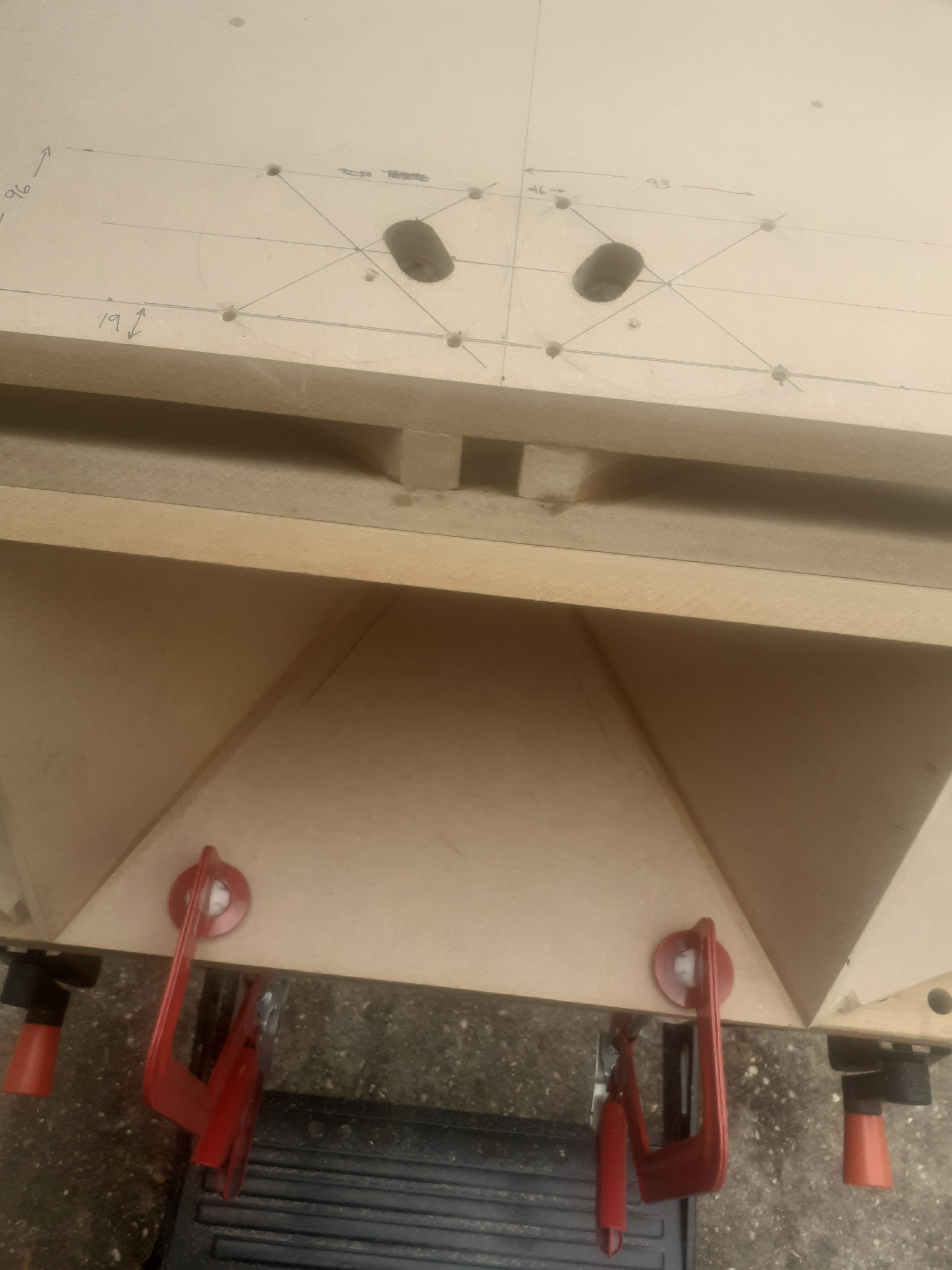

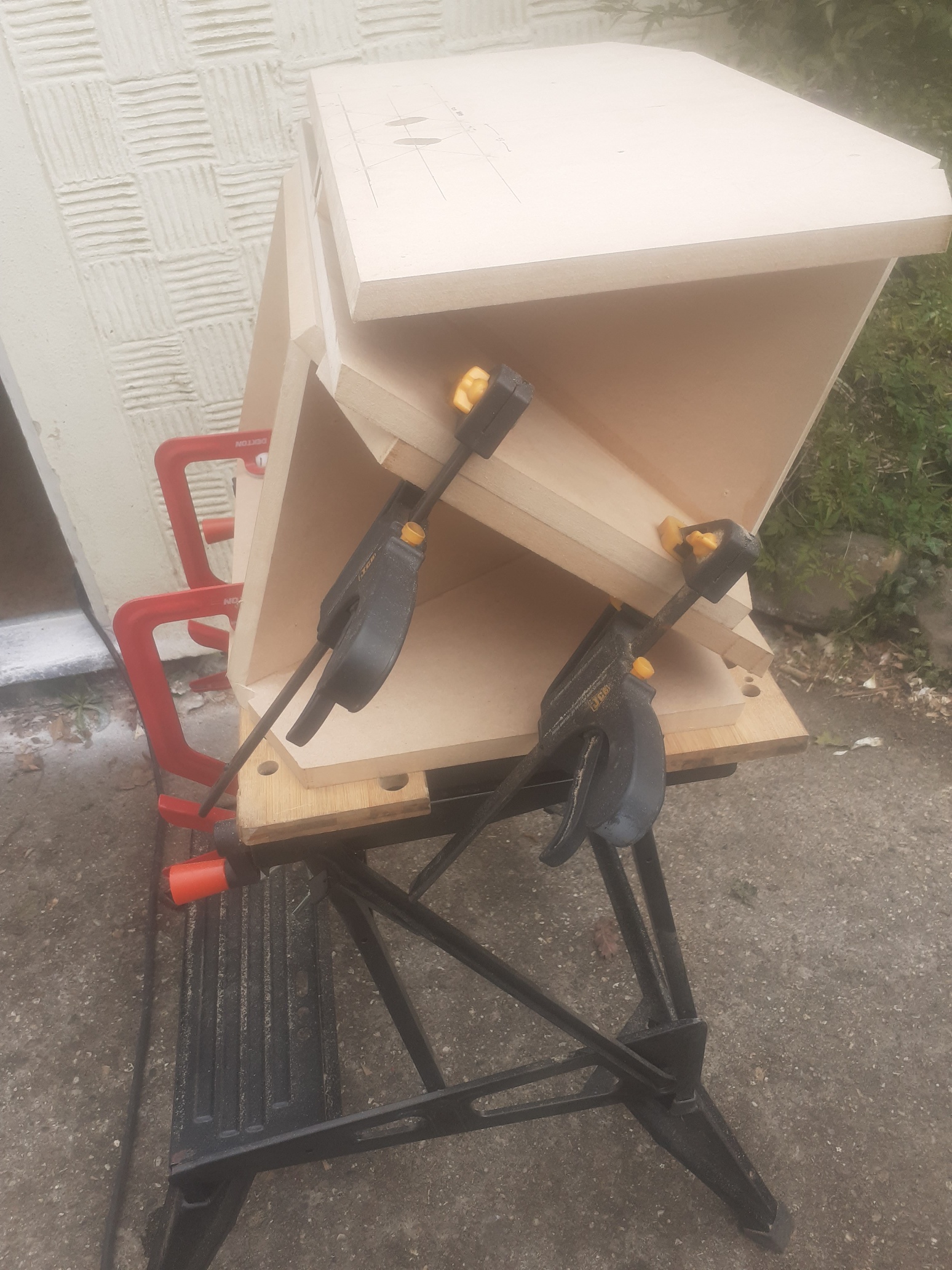

Got the initial flares glued up tonight for the 60x40's. Takes up a lot of time building these things. Got home from work at 5.30, had some food and finished up around 8.30 (had to cut the ports for the mids before assembling) Henry Weston popped by to give me some help...
Rob

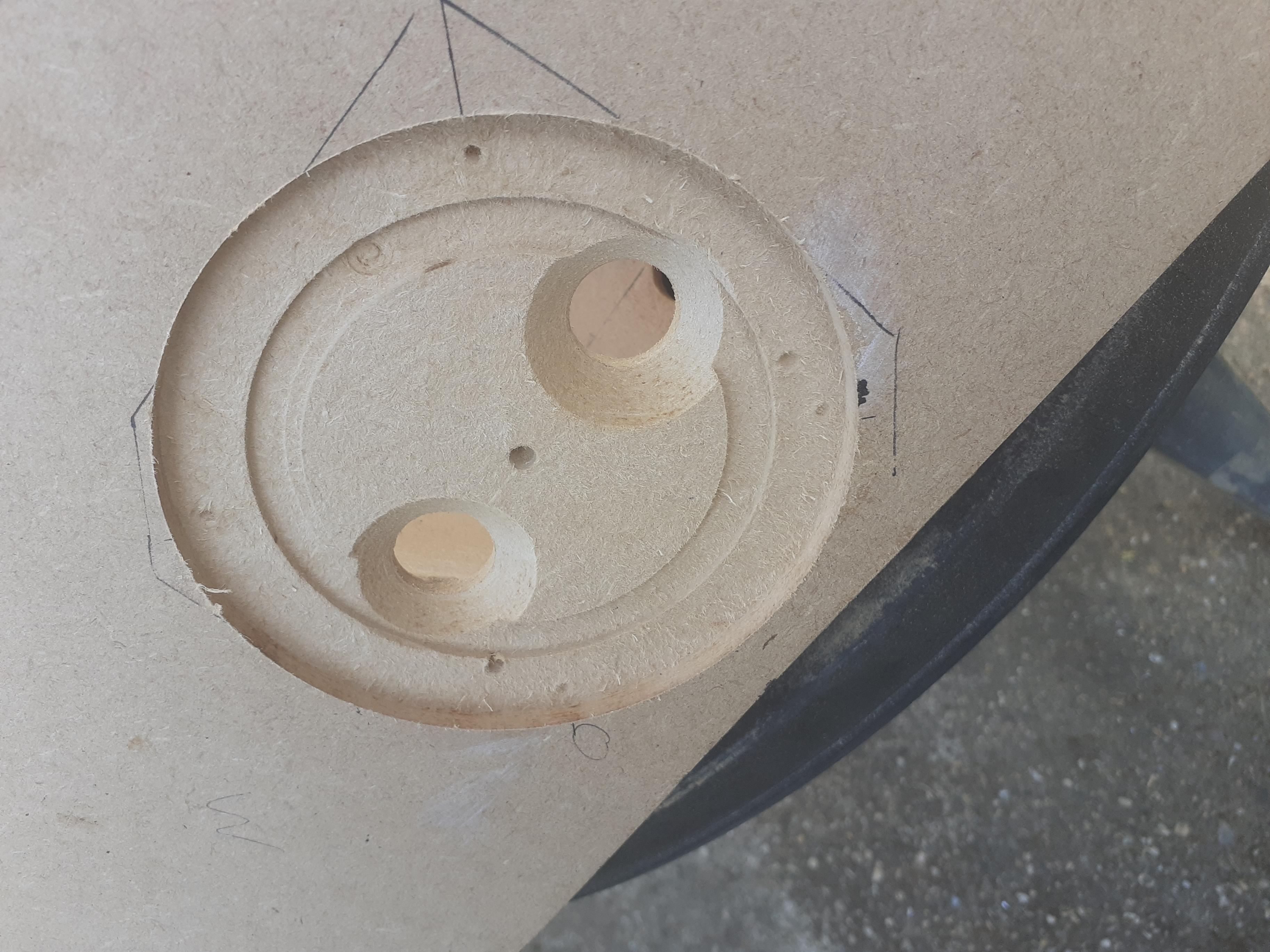

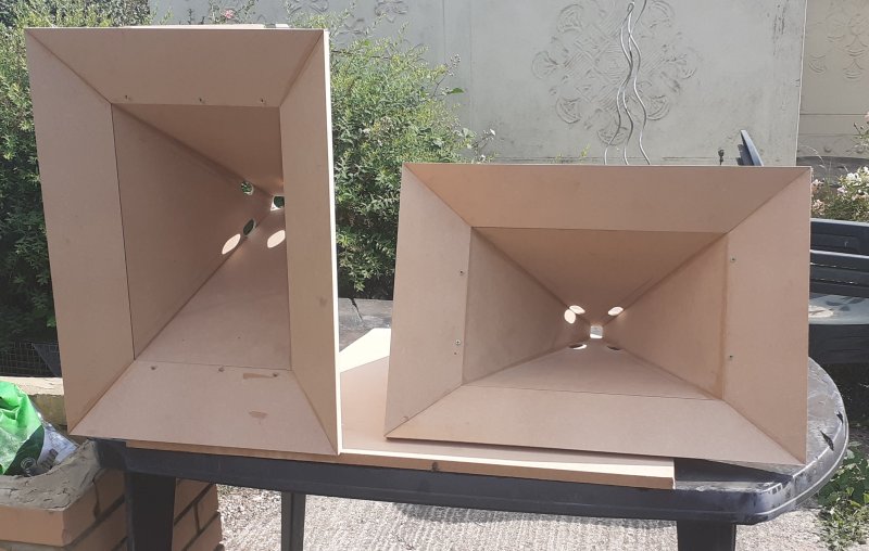

Started routing the mid cutouts in between rain showers. Hopefully they'll be done and I'll get the flares glued on. I have to do all the routing / tablesaw stuff outside so my builds are very weather dependant.

Flares filled and sanded, nearly ready for paint. Still have to buy mdf to do the enclosing boxes.

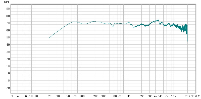

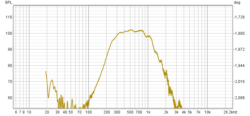

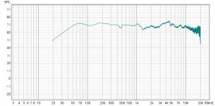

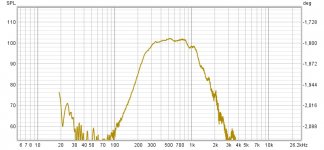

Tested the mids / tweet on one today. Mids are smoother than the 50x50 test box. I'm assuming it's because the port is closer to the middle of each driver.
Less resonant spikes above cutoff too. :happy1:
Pics are mids raw response, then with a couple of PEQ's and slopes each side to lose the hash / help excursion at bottom end.
