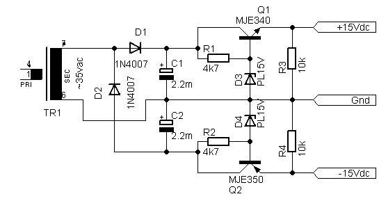

This is my sugested solution
That is just a voltage doubler, and what i have sugested...
PS: What use do you have for R1 and C1?
It would become a voltage doubler if it happened to be operated open circuit, which is normally never the case.
R1 limits current spikes, at power on for instance, and C1 sets the average output current. Each cycle, it transfers a charge of C1*2*Vpeak to one of the outputs, leading to an average current of Q*Fmains, 50Hz in this case.
