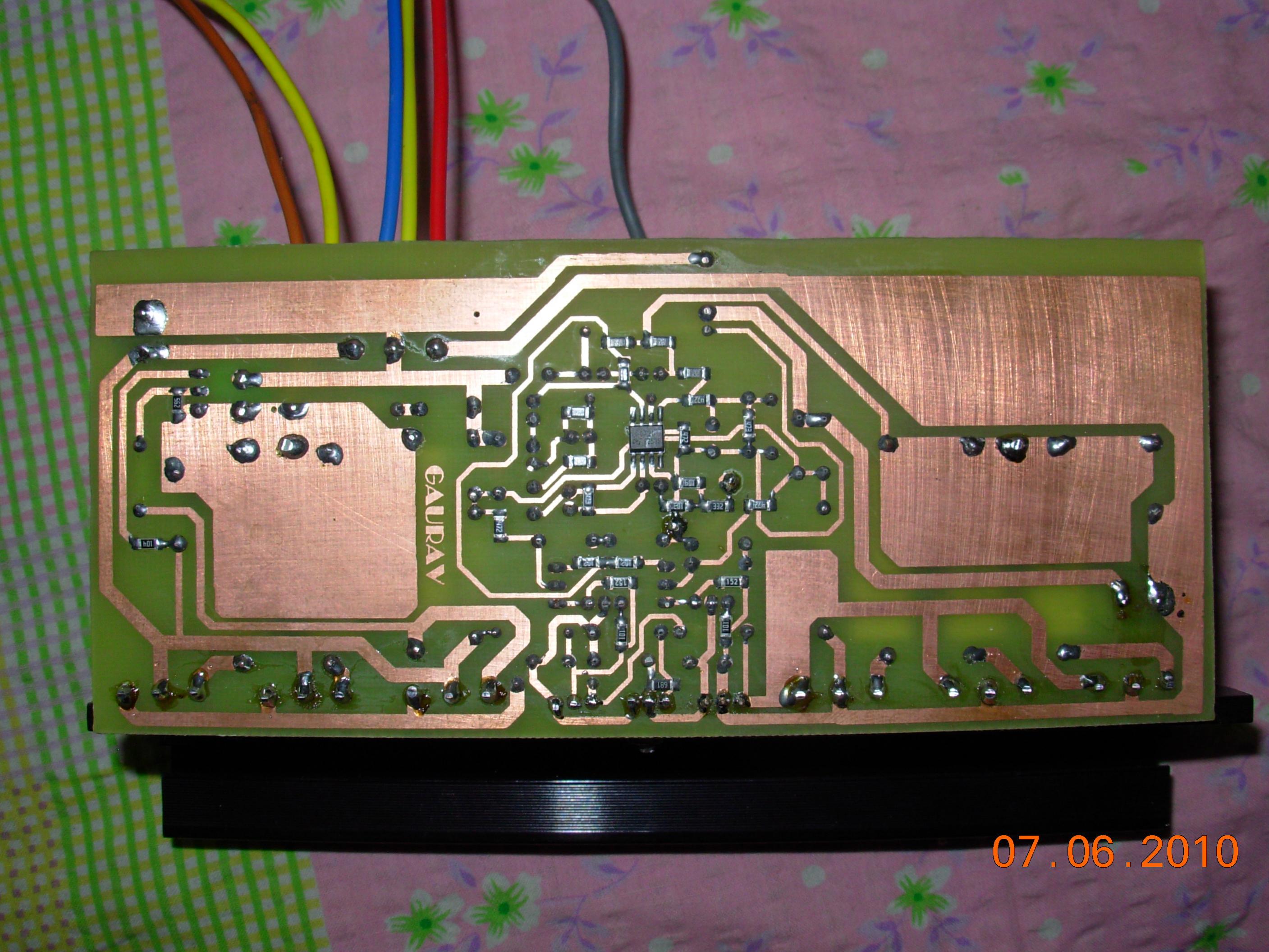

Hy everyone! I finally finished the metalwork with the B500 heatsinks, and could start one of the amps. As soon as I have time, I'll post pictures of it, but at the moment all I can say is: WOW! This sounds great. As far as I can only try it on my 50w kenwood hifi speakers, it is very powerful and has excellent sound (for my ears). So thank you Apex for sharing this with us, and as soon as I can I will post pictures.

In fact, it has been already made but i didnt got enough time to post the pics.

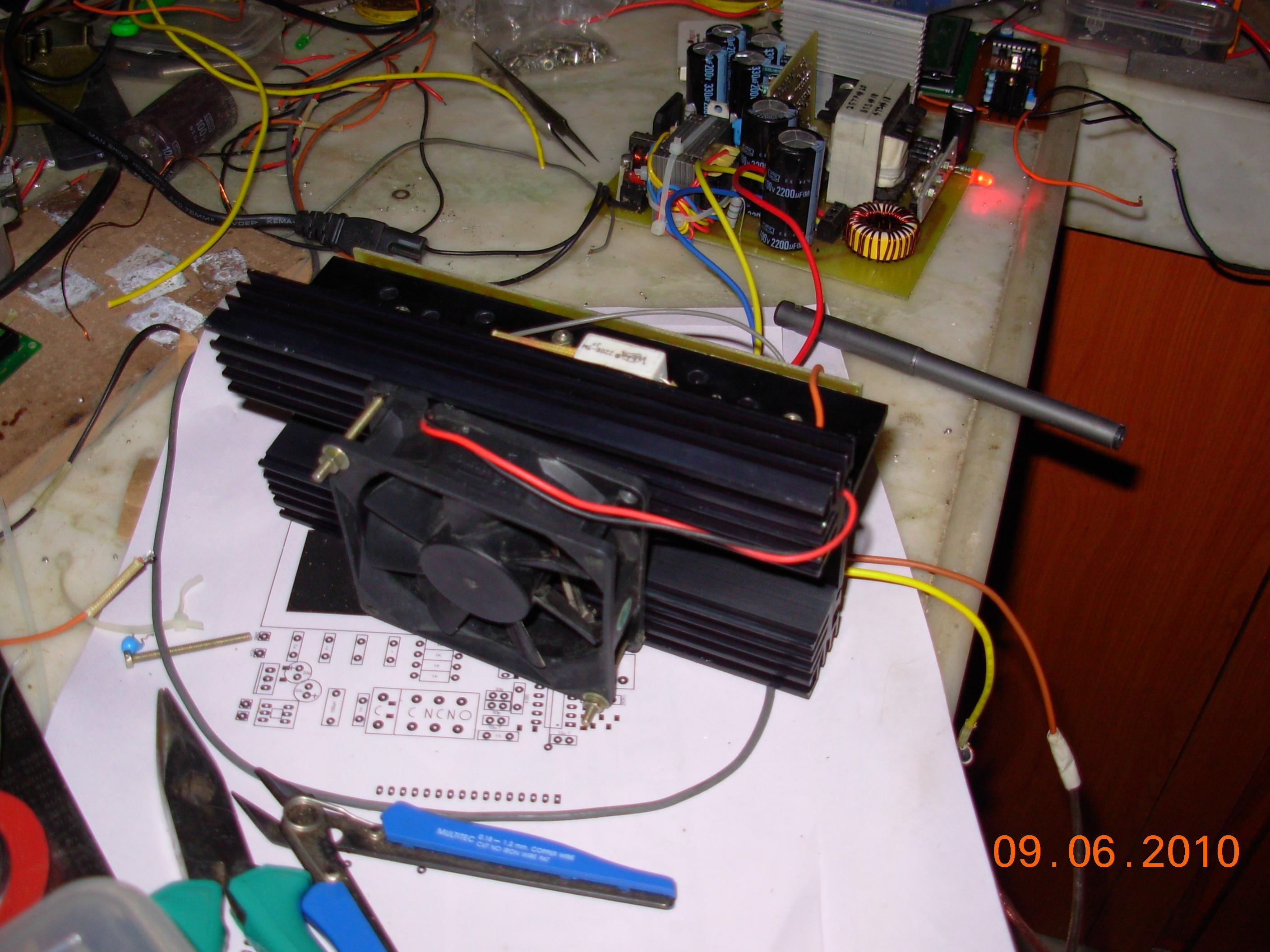

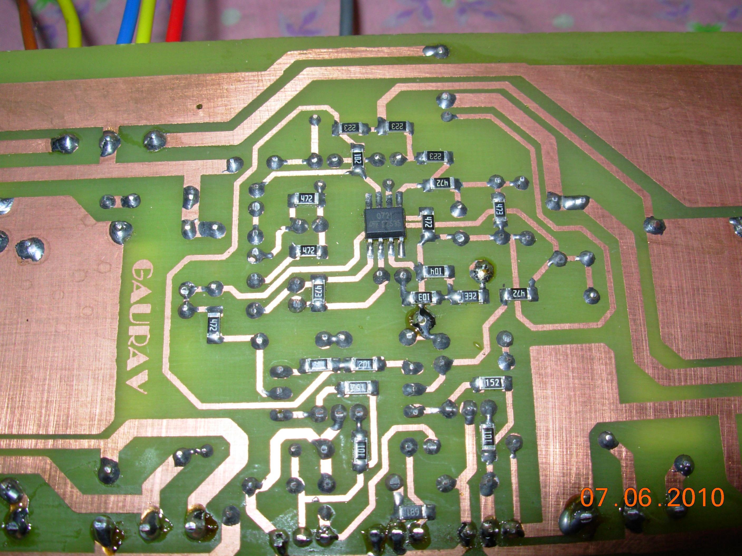

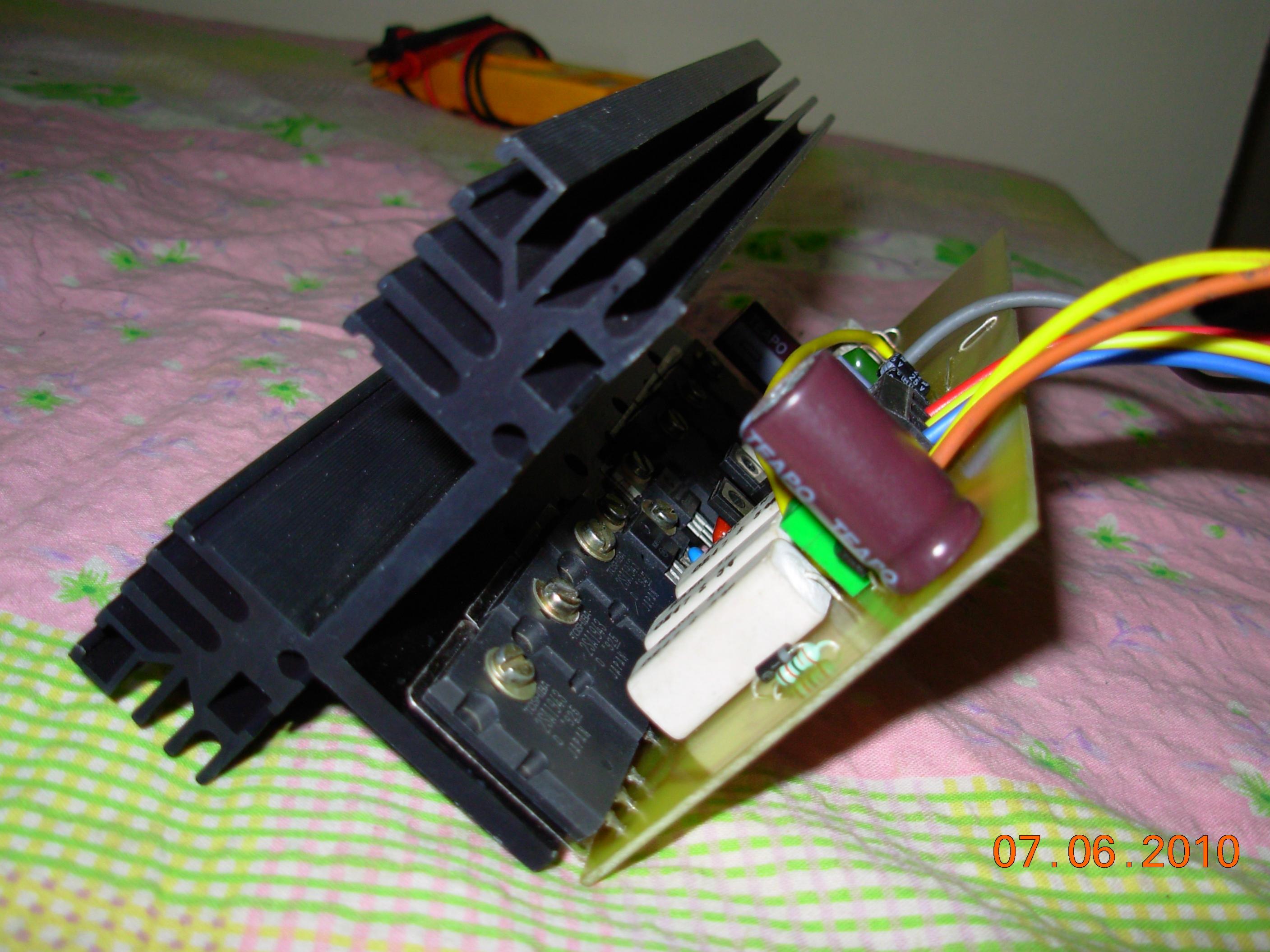

here are some of the pics. It really sounds great.

Thanks for pics, nice work. What is PSU specification, and what speakers are used for the test?
Regards
PSU is around 50-0-50 and 500VA IR2110 based. speaker I used are pioneer 4E DVC champion series 12" with 1200w peak power input and 400w nominal (TS-W307D4). That's what I have presently. however I have also tested the amp on a 600w 12" full range spk and it sound well at almost full power without any auidable distortion
