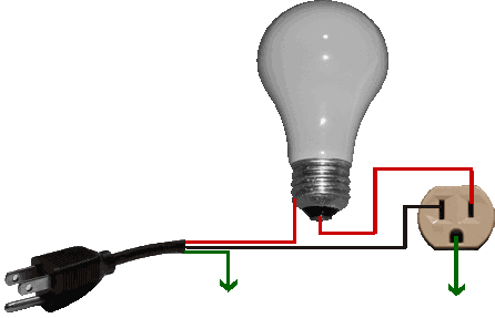

sorry i dont understand.why use bulb?If you use a light bulb limiter, you don't need to step it down first or use any DC protect. The light bulb is actually better than a variac. A lot of amplifiers will work perfectly at lower voltage and get unstable at full voltage. With a variac turned down it may behave, and then go bang very suddenly as it is brought up. The light bulb will let the amp get to 90% of normal voltage when it's idling, and bring it down automatically if it goes unstable.
amplifier just use example -+70v.how the connection of bulb with this amp?

it prevents you blowing up your amplifier if you have made a mistake wiring it up.sorry i dont understand.why use bulb?
