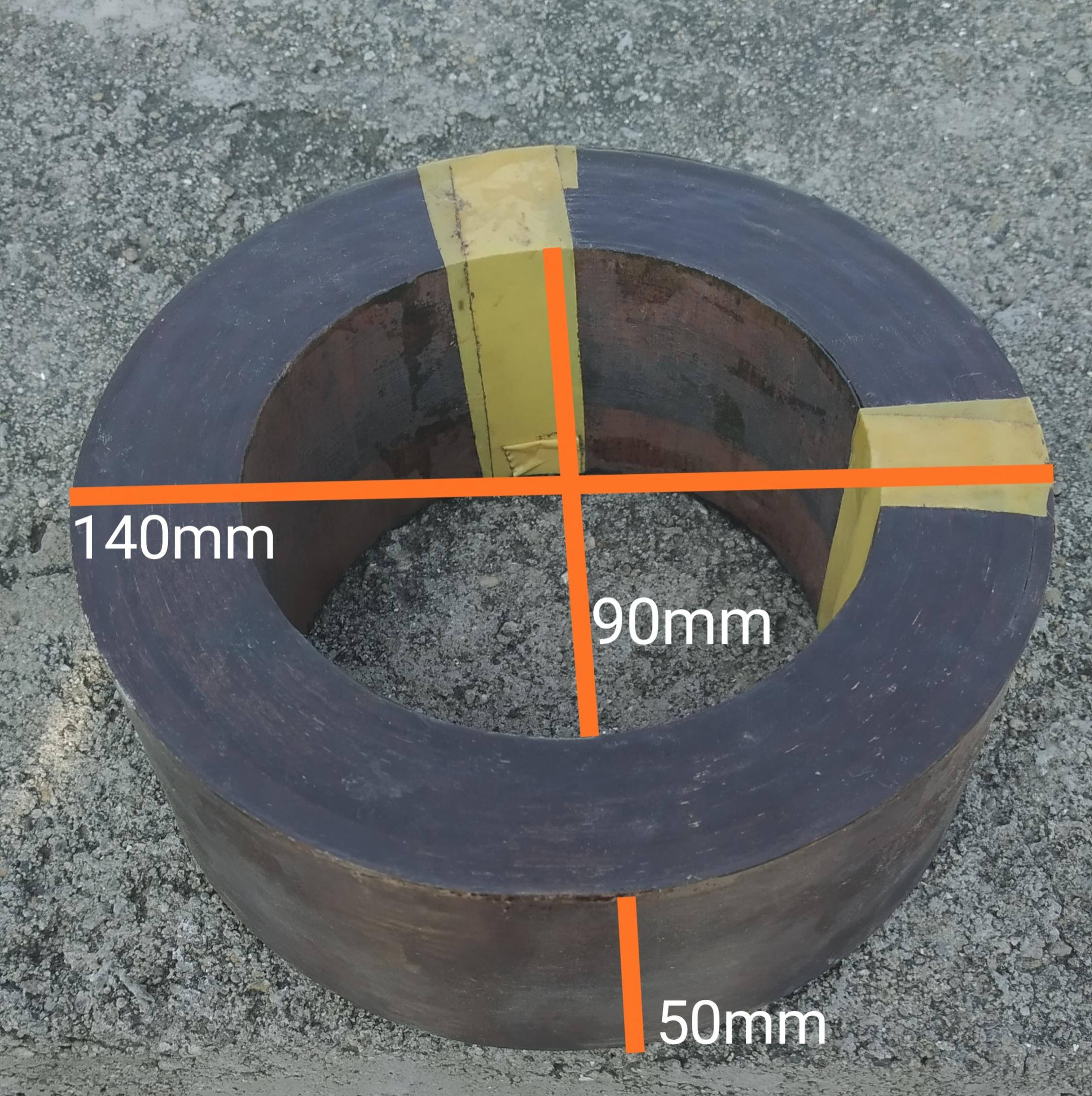

Hello diyers
I have toroidal core of following size, it's more than 1kva.
so I can wind two 35Vac and two 55Vac on it.
can it is enough for Mono B500 and stereo Ax-14 amp. Because I think total Power requirements is near about 800 Va.

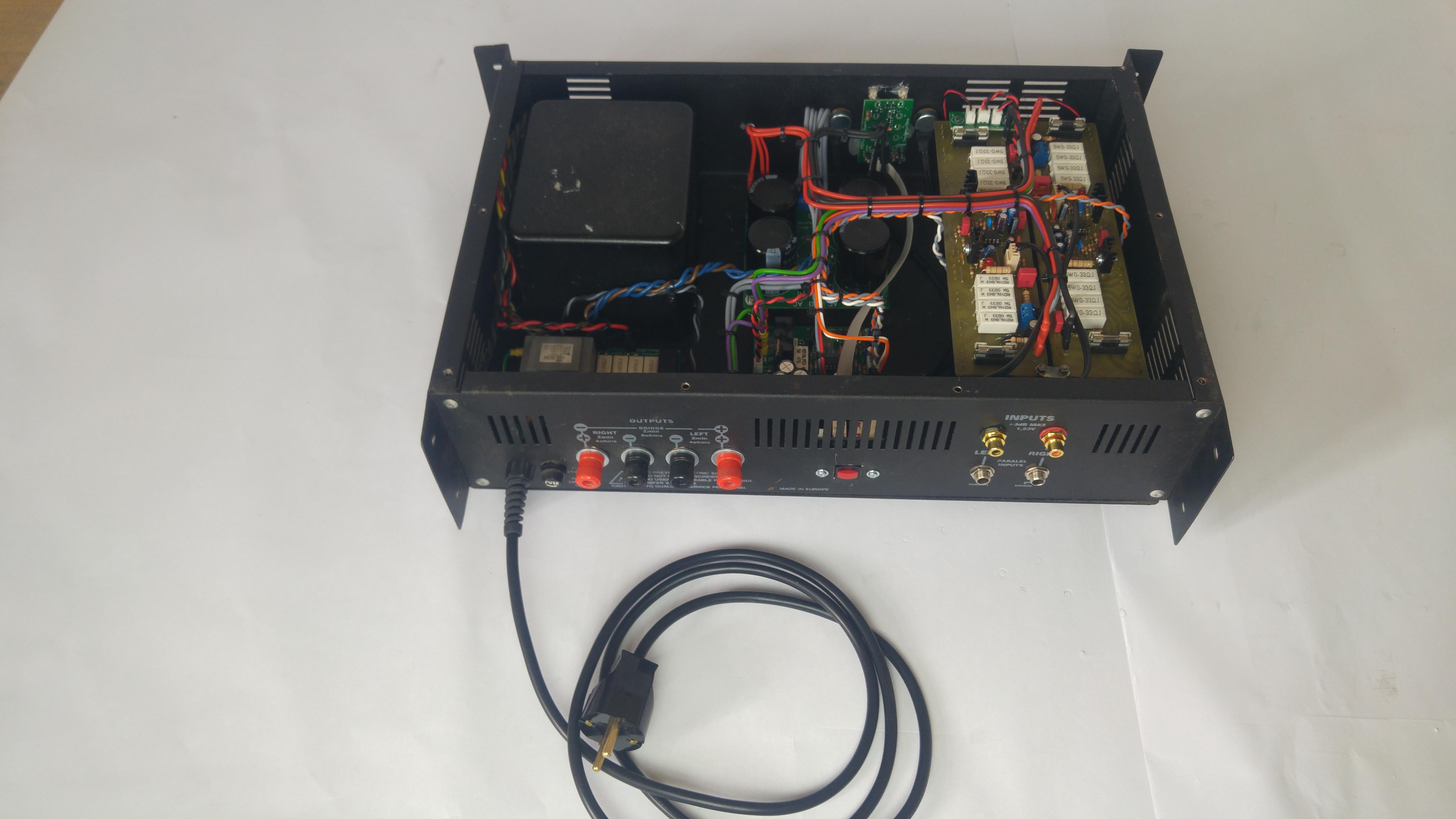

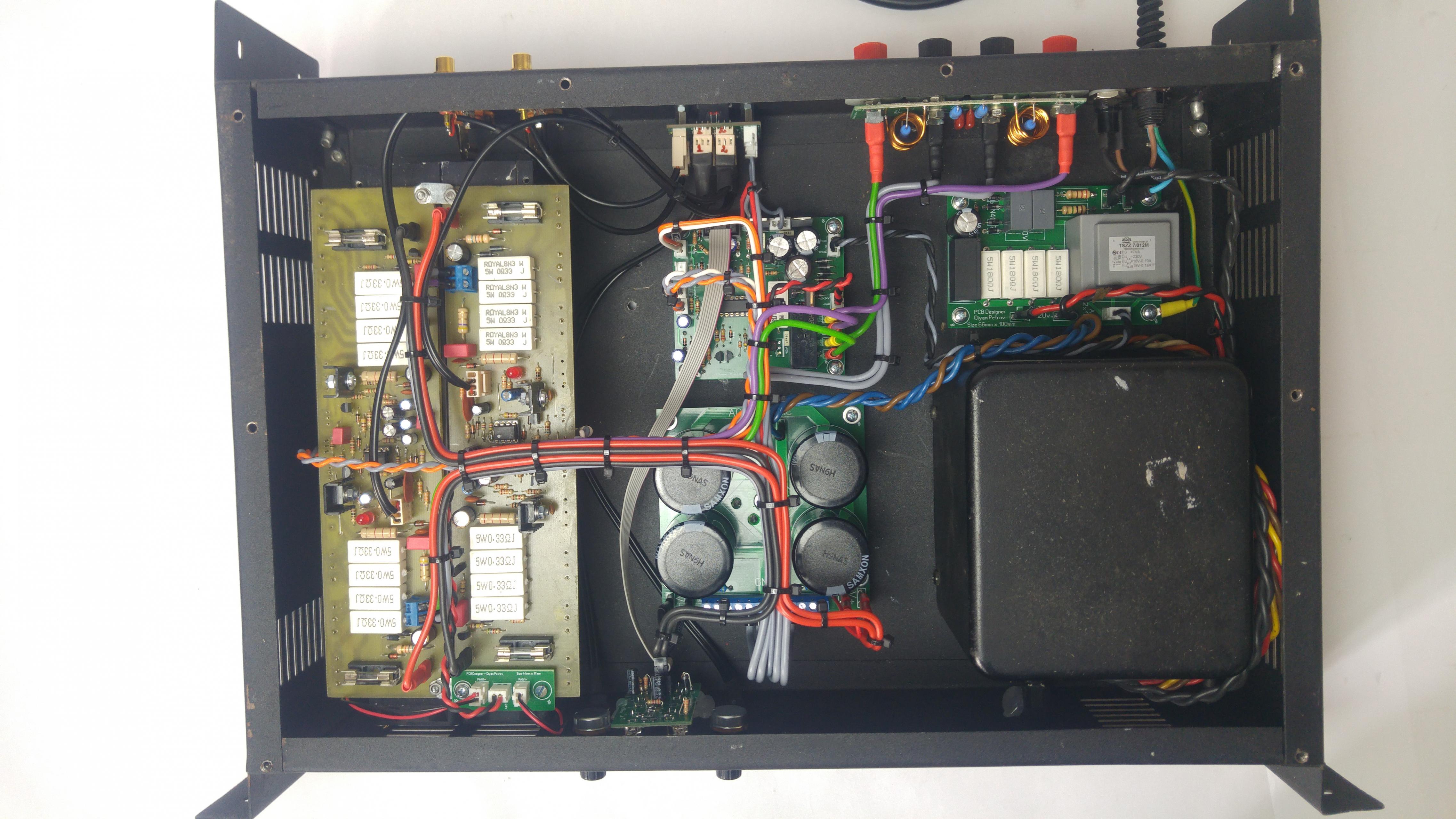

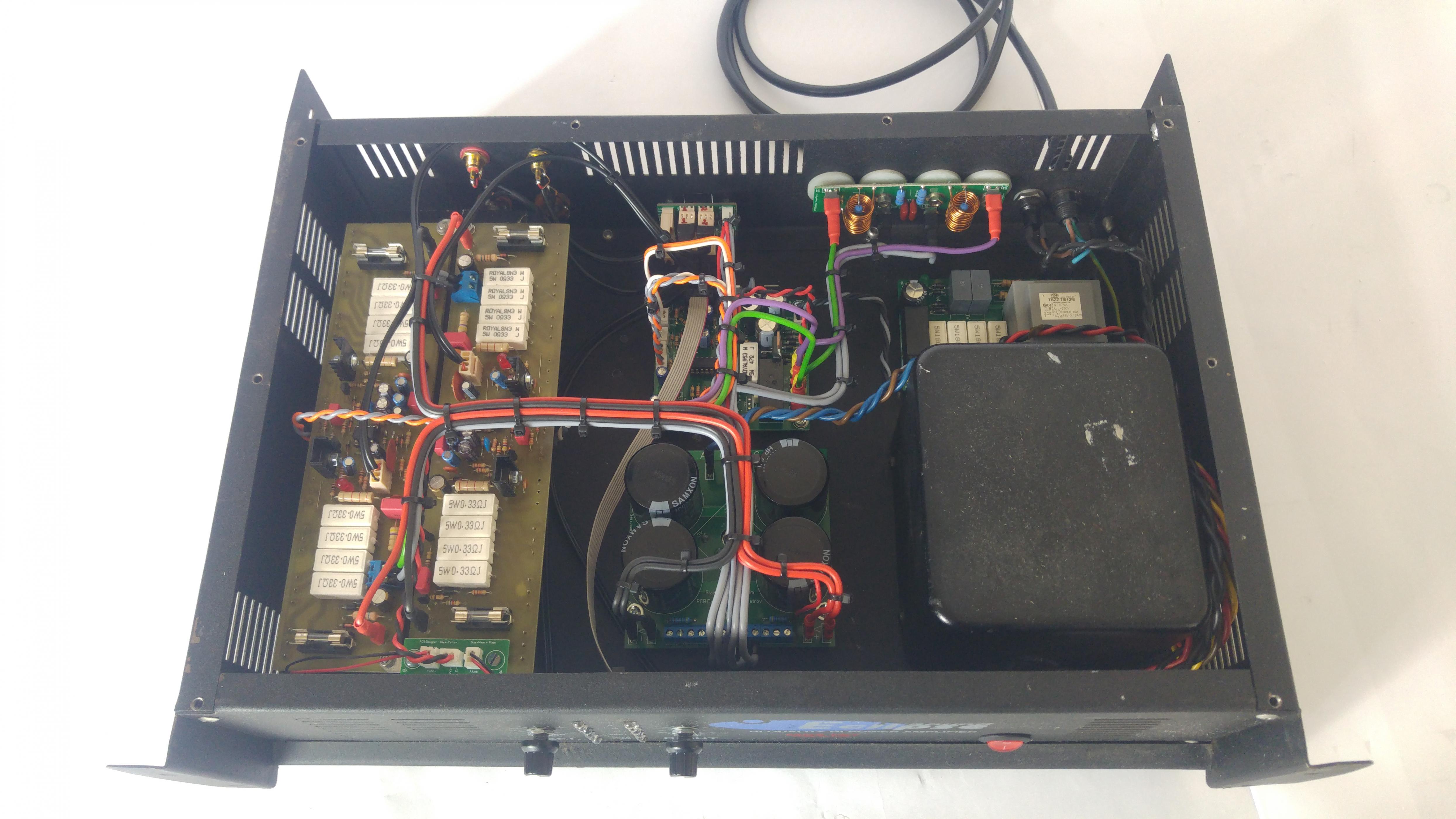

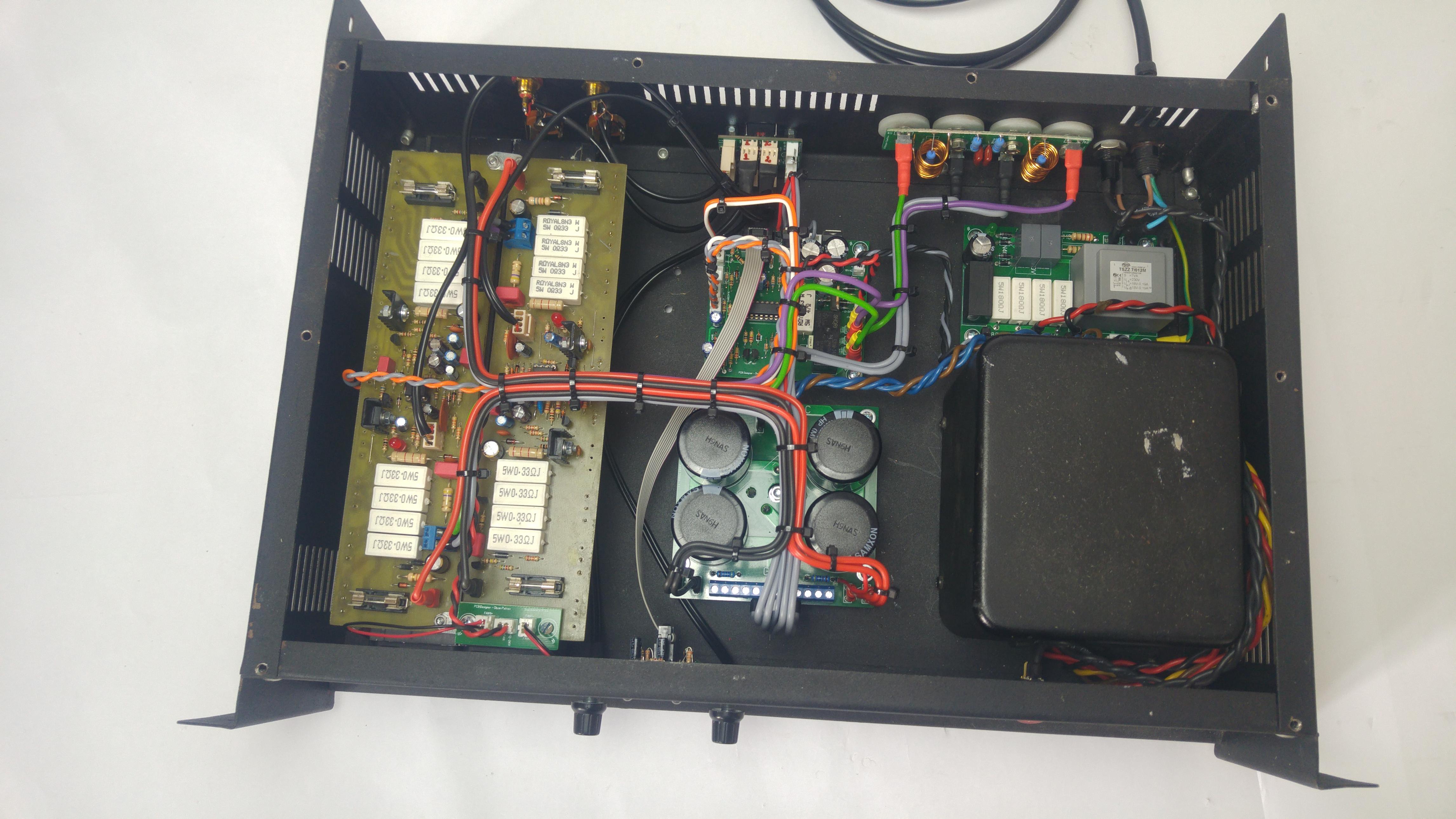

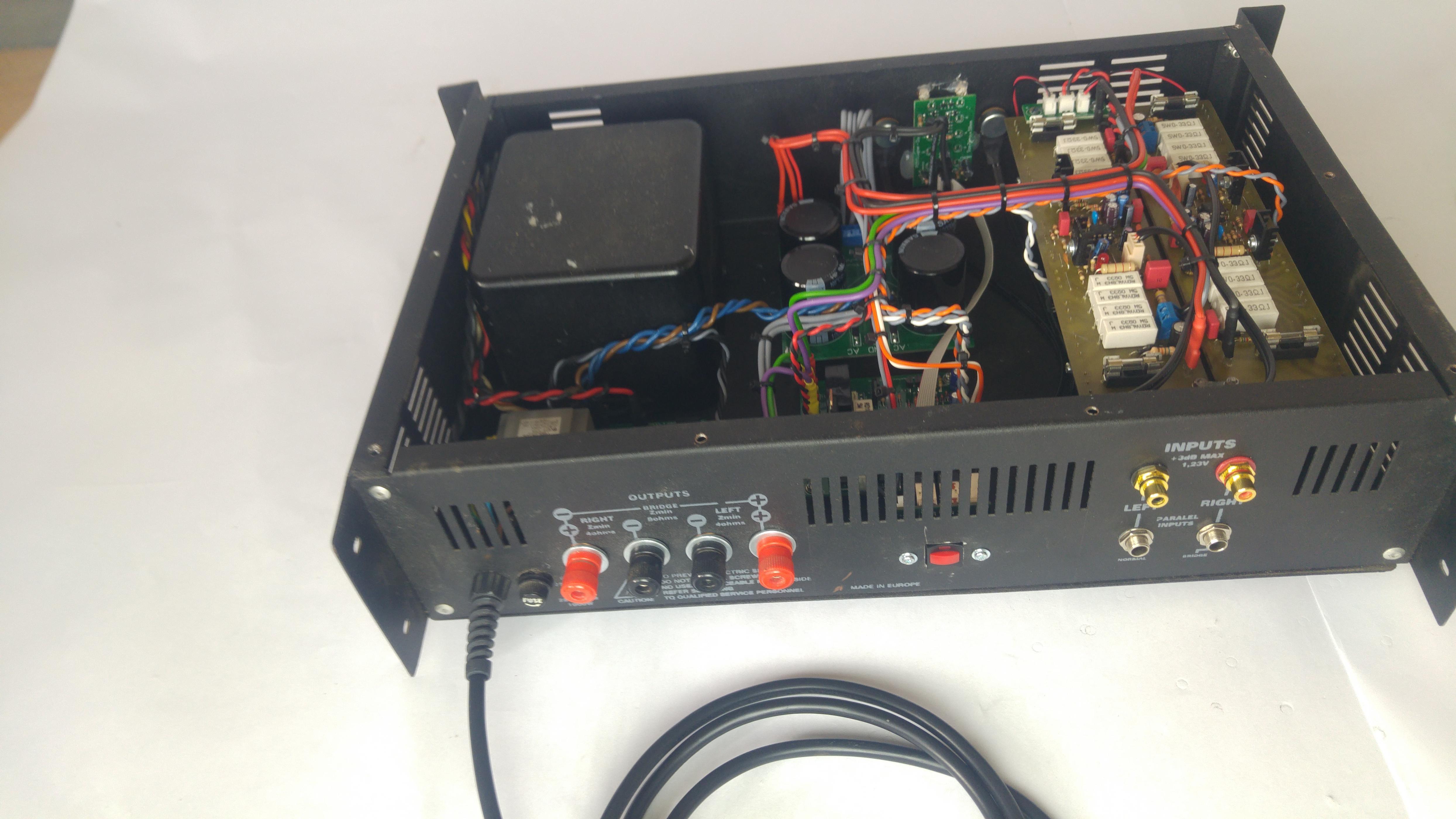

This is my version of B500 Apex.
Traf - 2x40VAC
caps - 4X10 000uf/63V
Input - RCA and 6.3
VU meter PCB
Zobel PCB
Protection PCB
Bridge switch PCB
Soft Start PCB
All of this PCB designed by me and manufactured from JLCPCB.
Apex B500 PCB is hand made by me.
Offset voltage is 7mv per channel.
The sound is clear and loud.
THANK YOU Mr. Mile , regards Diyan Petrov.

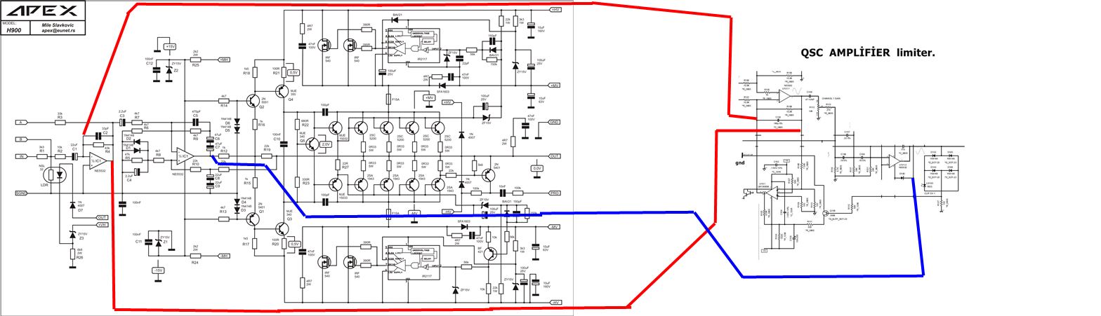

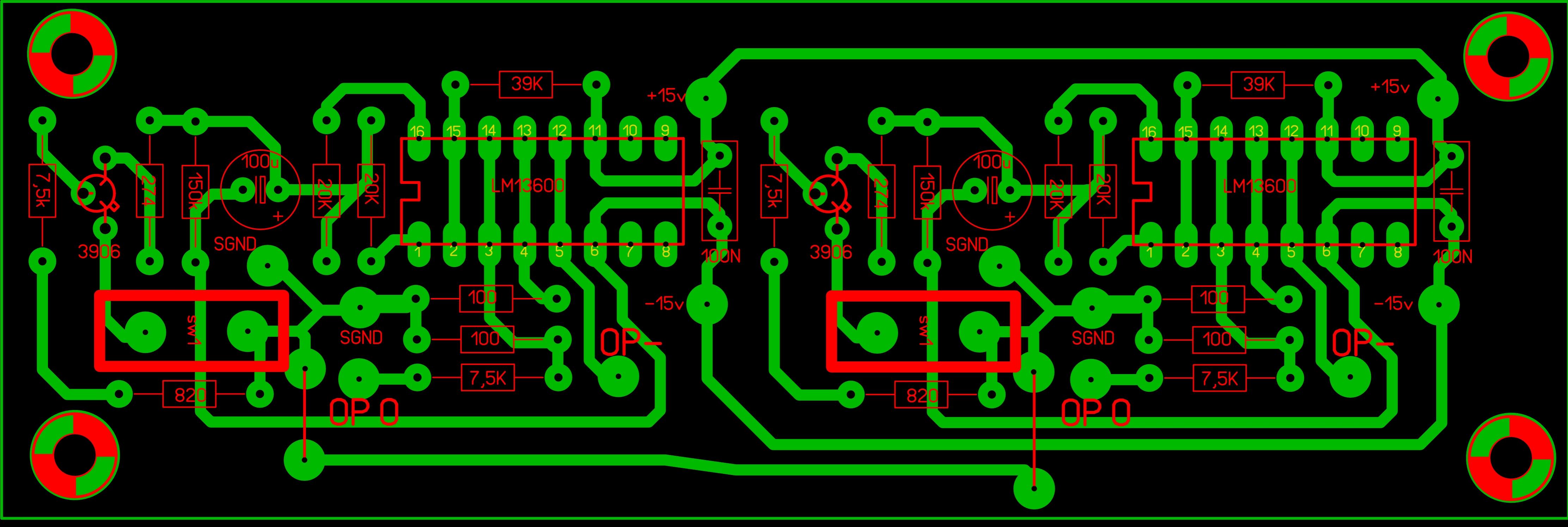

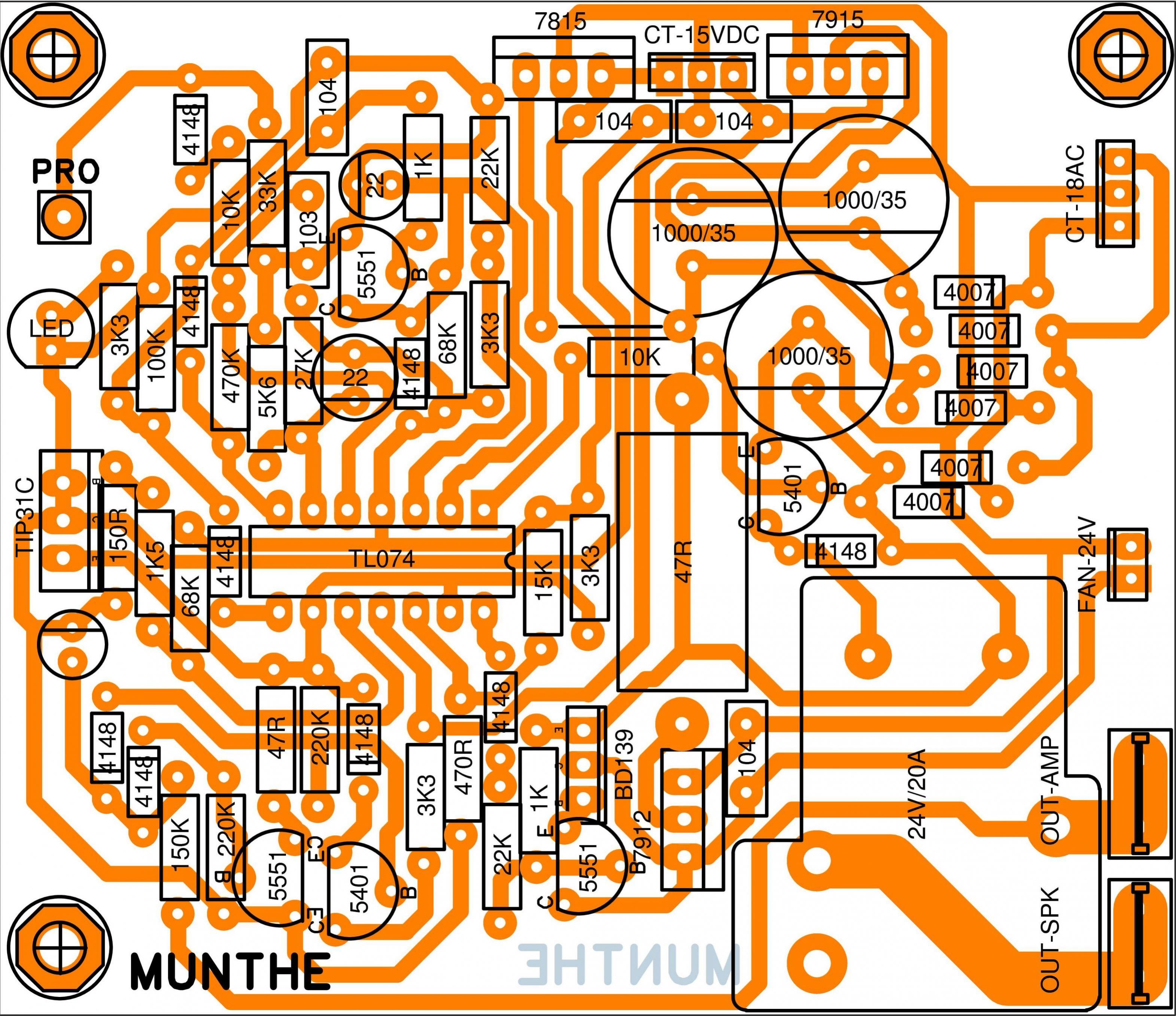

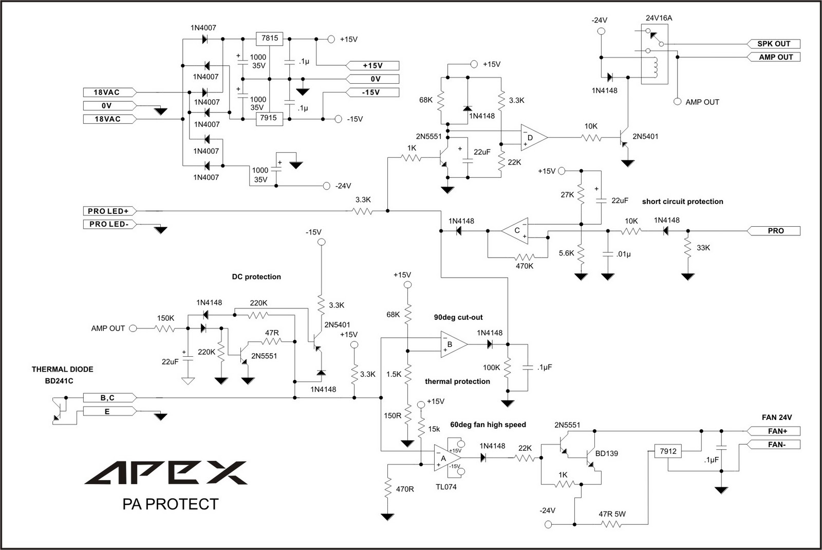

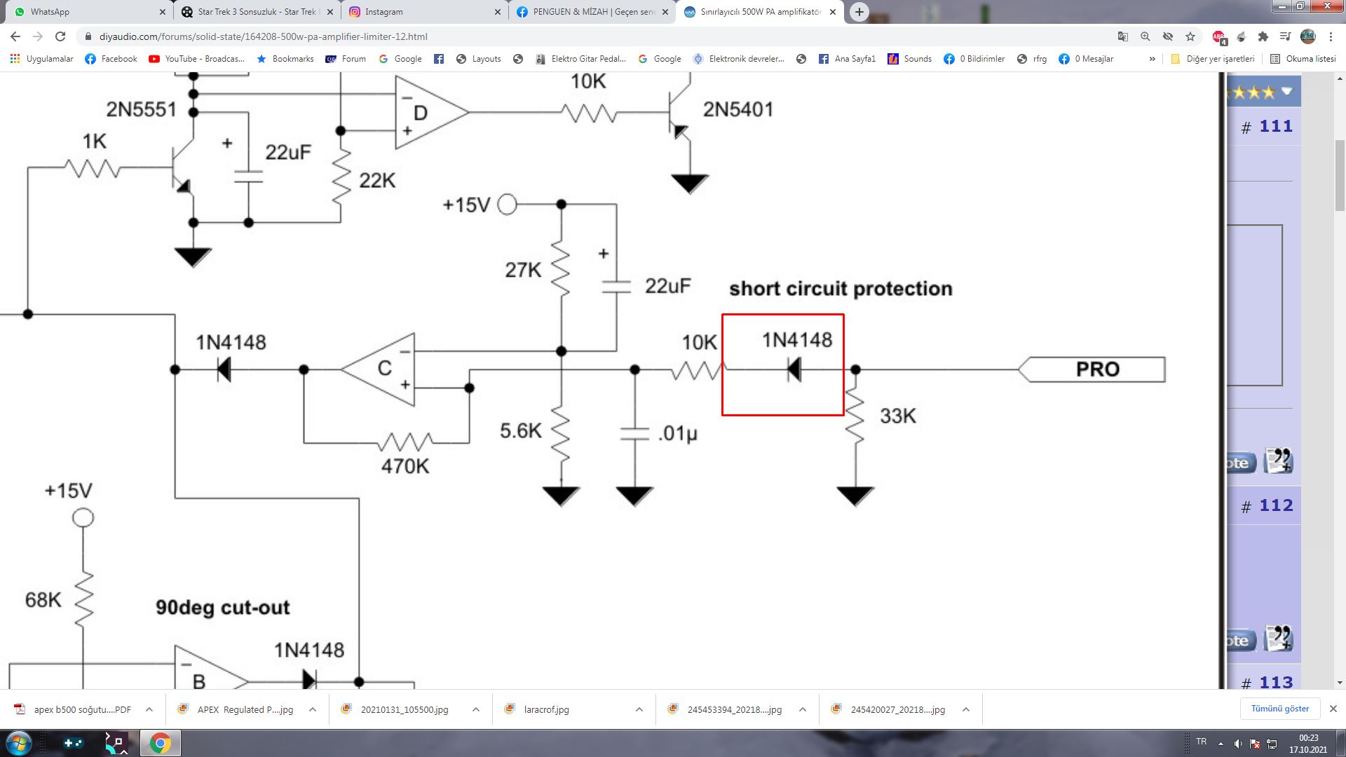

Is the diode direction in this sign correct?
The terms in this diode schematic are like 3 volts dc for testing, the led is on, pointing, I plug it as in the pc, the voltage never ends. I guess protection. Is the Apex h900 pnp transistor supposed to take the negative voltage? Which direction should this diode point?
correct on schematic. but i think it was wrong on layout
Sanırım Türk'sün sende.. Senin youtube deki b500 videosunu gördüm .. Bende linearray ve Aktif 18 inc için tasarlıyorum ama bu protect kısmı ters mi düzmü similasyon da bile çalışmadı negatif gerilim verirken. Acaba hangi türlü doğru ?
this forum only english my friend. yes am Turk too. i make it and its working but on the layout diode wrong polarity. "forum sadece ingilizceye izin veriyor layout resminde yönü yanlış ama şemada doğru çizilmiş. ben 2 adet b500 yapmıştım ikiside çalışıyor korumada çalışıyor takılırsan özelden mesaj at yardımcı olmaya çalışırım.

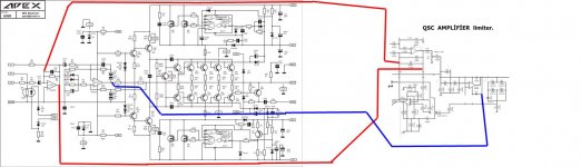

- 500W PA amplifier with Limiter
