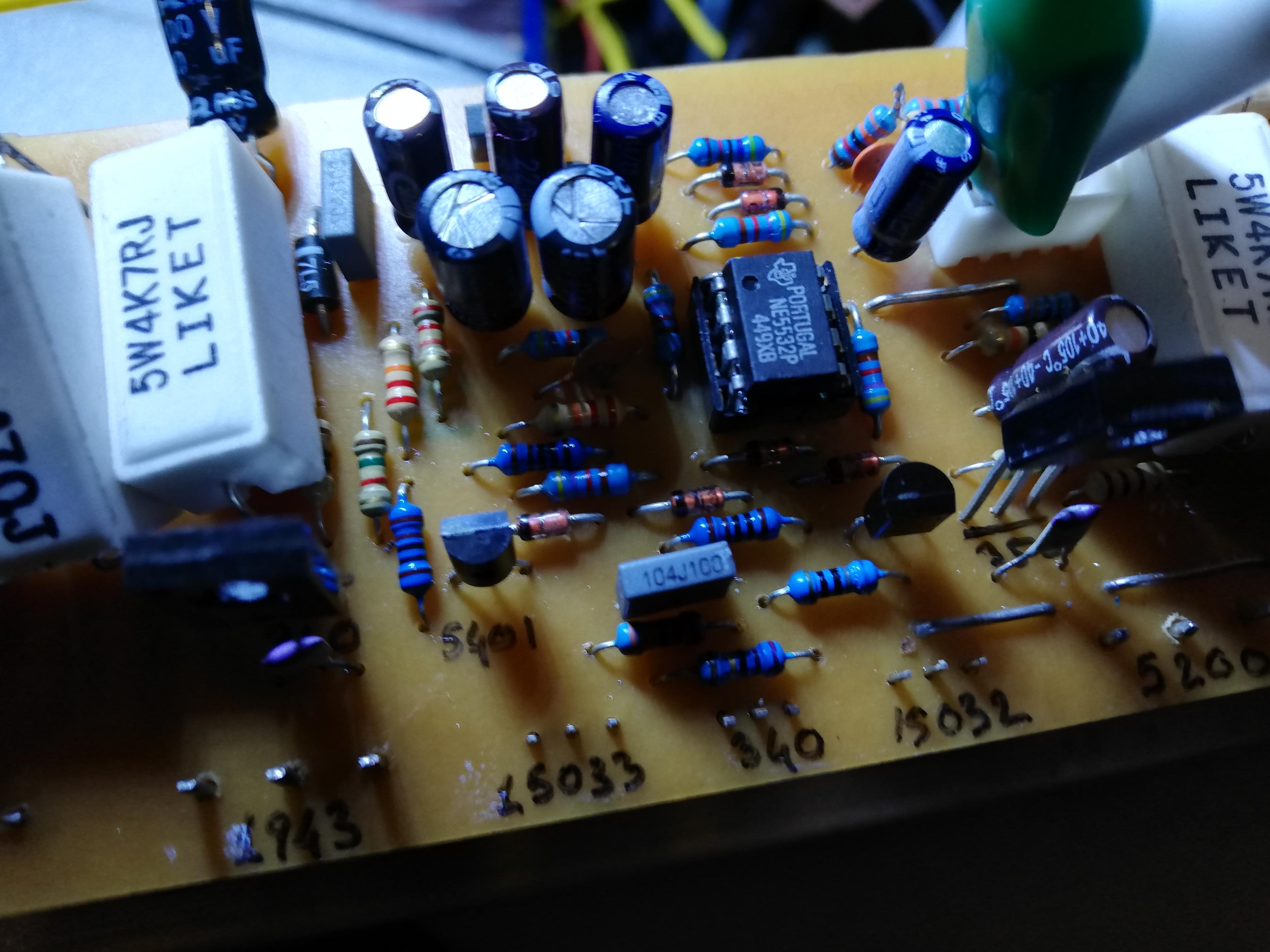

What are you using instead of 5551 and 5401?
2n5551 and 2n5401
2n5551 and 2n5401

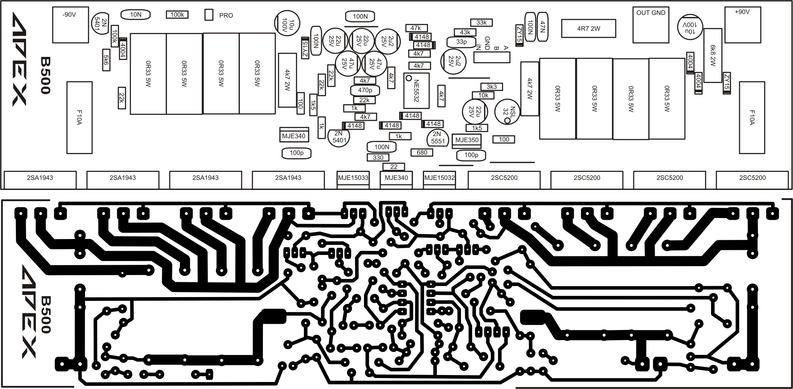

Make sure that you solder those in the right direction and you haven't mix them.

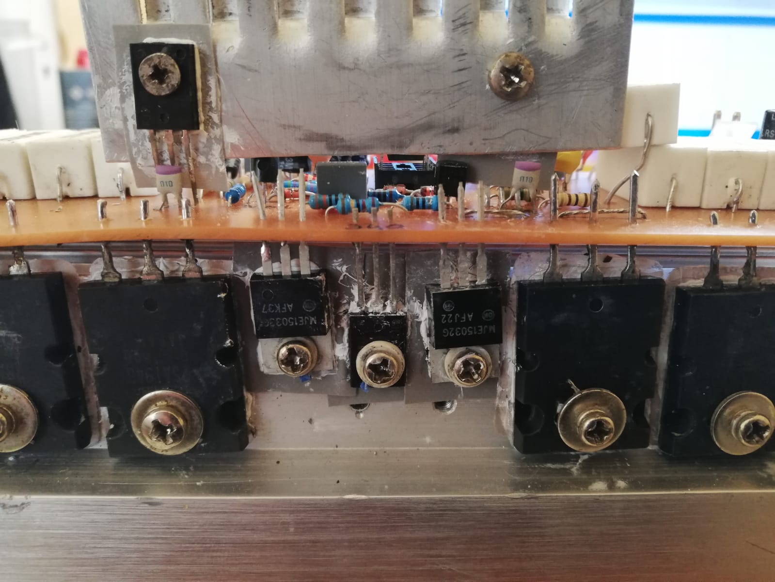

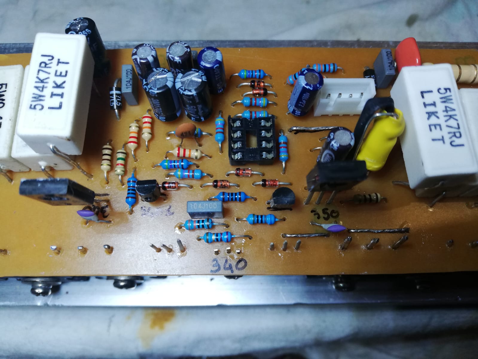

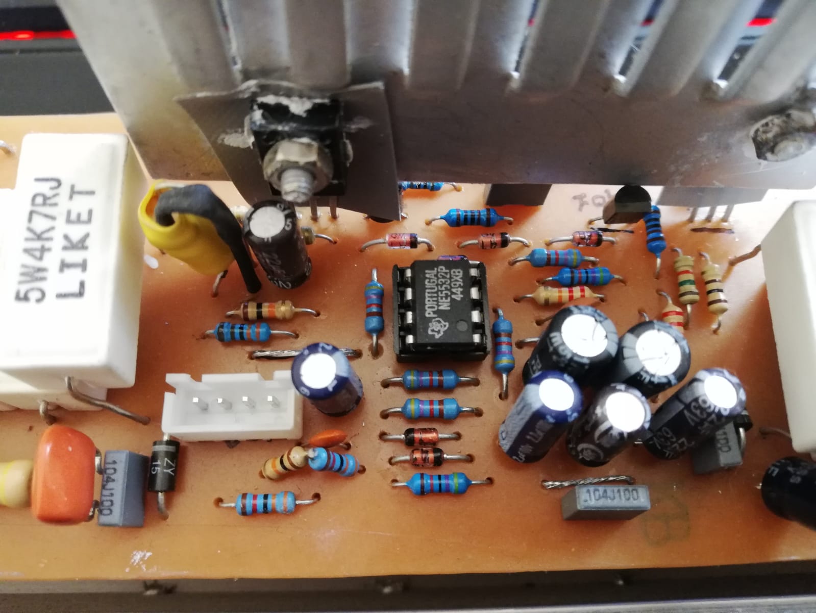

İ check all again and change the 5401 with new one. And save thhe resistor but now - 9v at audio out
i will rebuild it i dont know what is wrong taking out and put back making pcb lose roads i need start new one i think

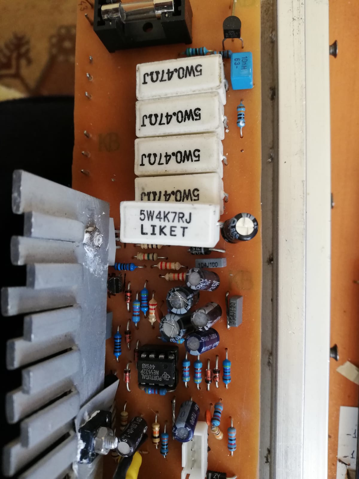

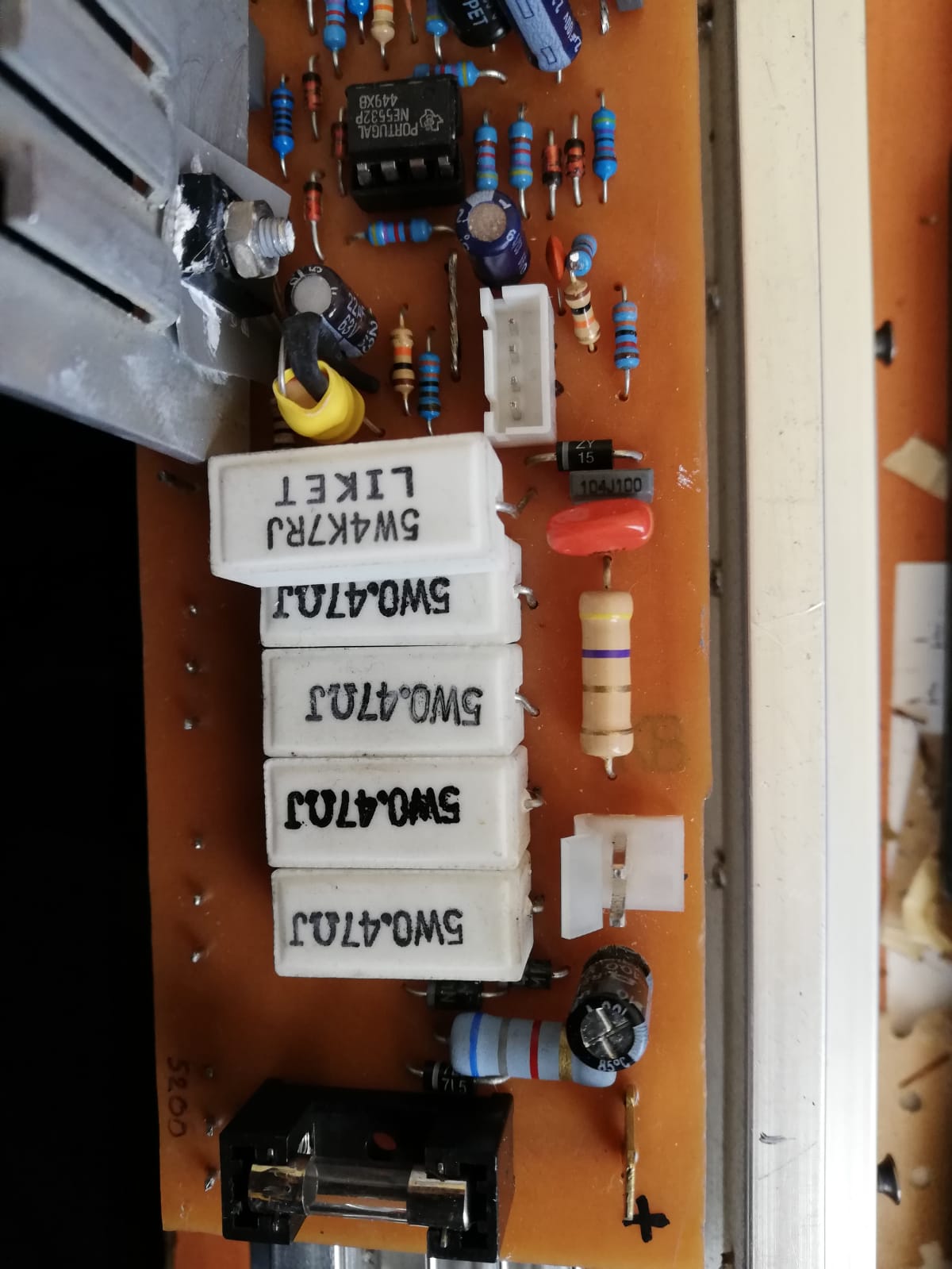

I can't see any 0R47 Ohm. resistor.
Resistors that i see IN YOUR PICTURE are 4K7, 4700 Ohm!

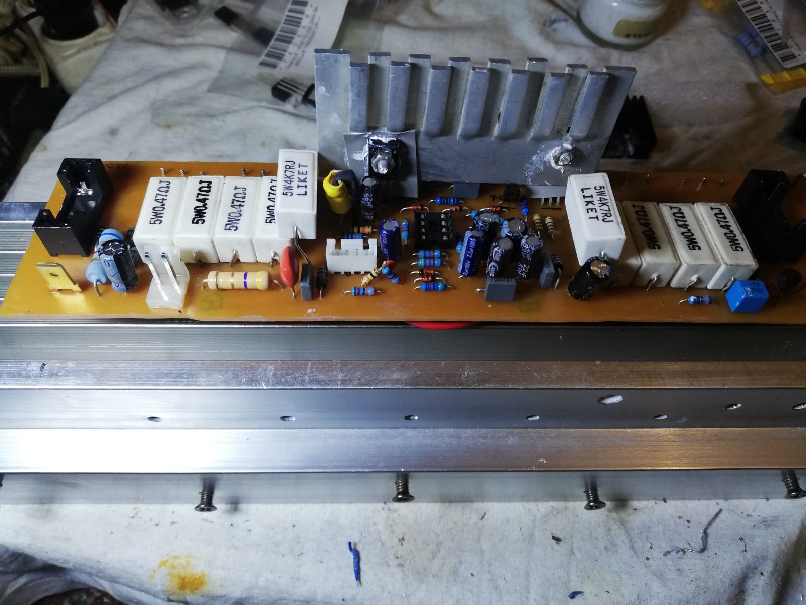

ty for helping thimios,
i make pictures

Measure voltage at 15v zeners.
Measure voltage across 0.47 Ohm.

on zeners 15.4v
on 0,47ohm 0v
which kind a bulb do i need to use on it i have 10a fuse on board its not saving the amp?
not: when i give ac power, audio output have 0V. when i cut ac voltage then on audio out getting dc voltage and raise slowly to -9V i just see that luckly

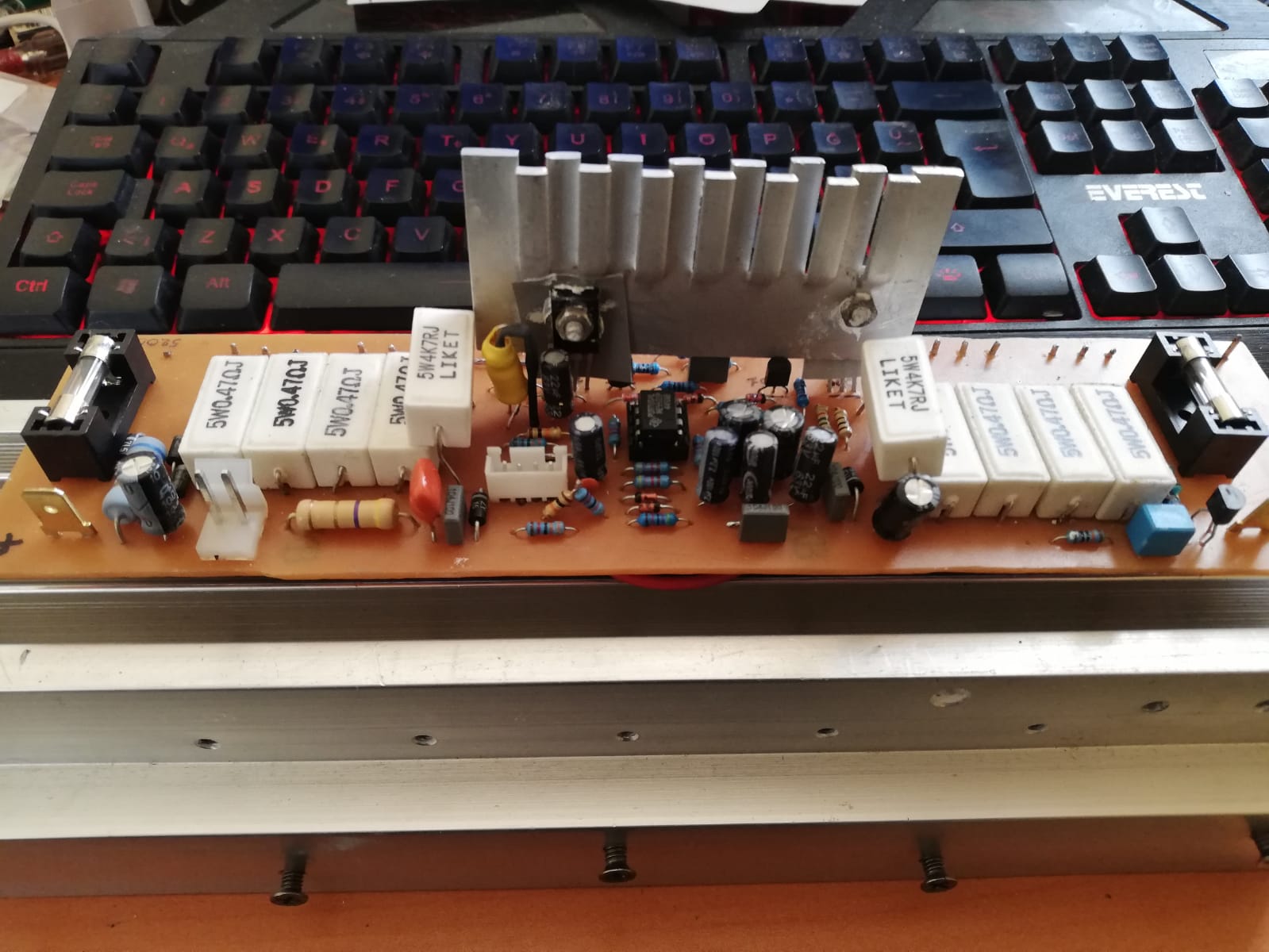

i did that my friend no signal coming out. this will be second channel. first one working but this is i cannot find what is the problem.tomorrow i will make new pcb and new components i will post here what will happen.
Play some music.

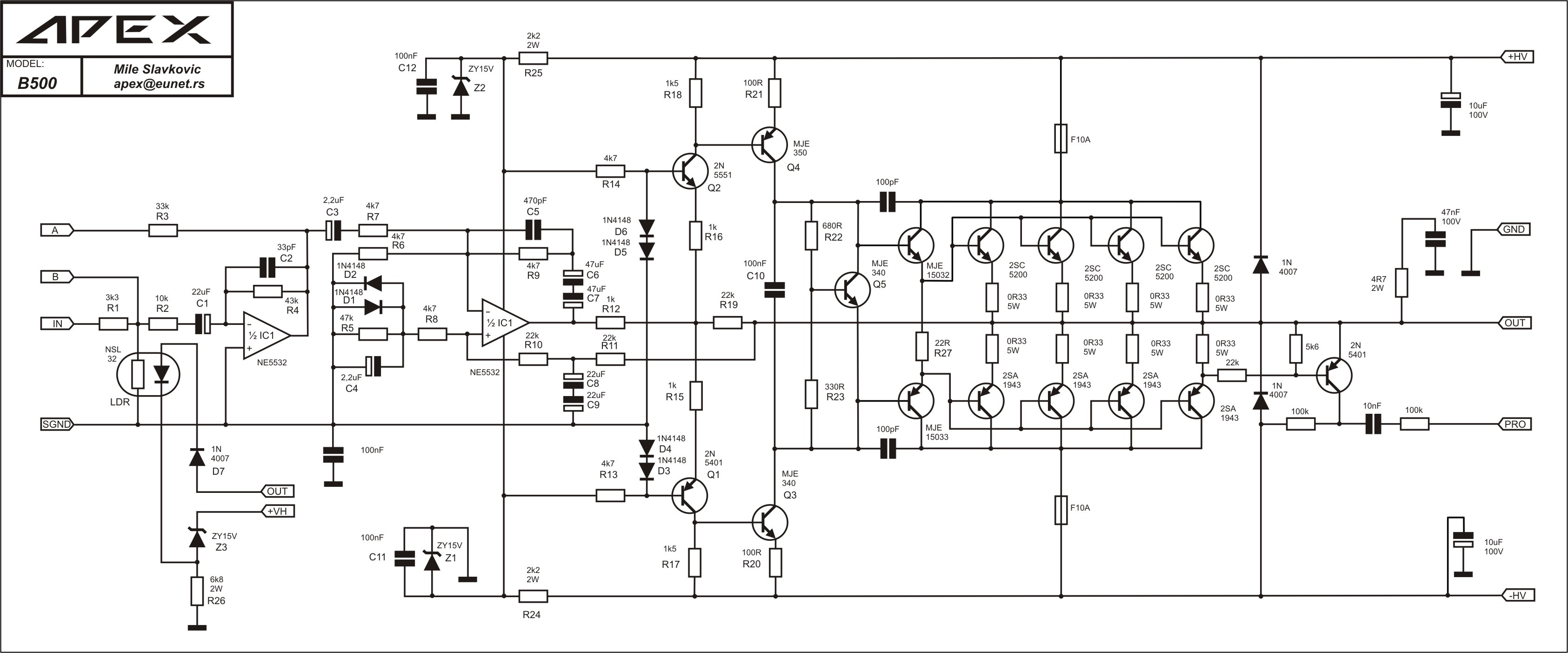

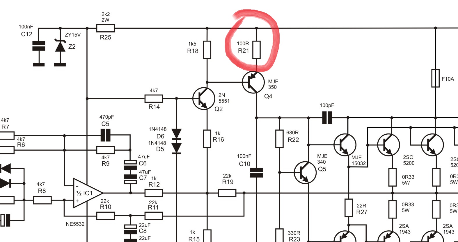

hi timos i did play music 🙂) 3 channel b500 burned. r21 (100R).
any one please help if you have time i need finish this amplifier killing me.
my 2 channels not work good but 1st one was working good but now 3 channel burn R21 100R same resistor.
and they burn 5200 transistors too 🙁((((((

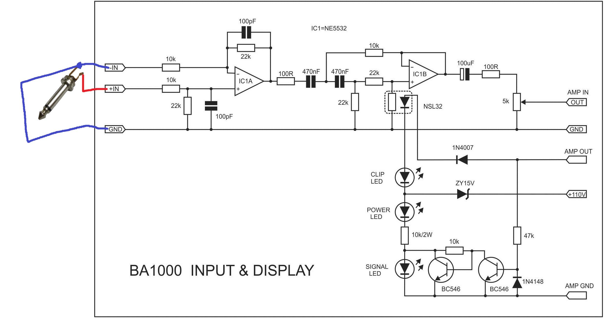

- 500W PA amplifier with Limiter
