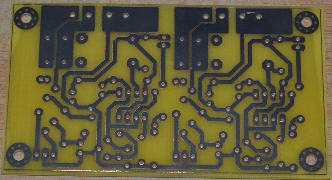

would you show the bottom of the layout, pleaasseee...:)

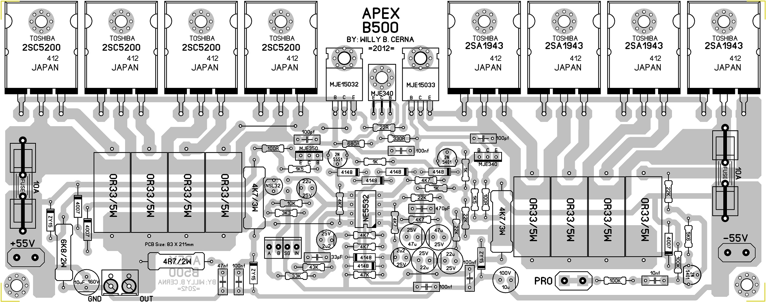

Layout and pcb.
Ver. wit 6 pair of outputs require A3 format of printwork.
No changes from original, only 1 or 2 pairs of tr. more.

with 4 pair 5pair 6pair same power, for five or six pairs stress for drivers.
That gives advantages if you use six pairs.
1.-power increases.
2.-votaje to the PLS is the same.
3. - We need to increase the font ampreraje.
4.-As to amending bias amperage.
5.-If aumeto the eight or more pairs to get some advantage.

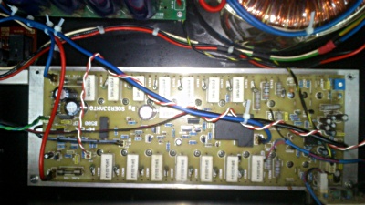

B500 tef,
thanks for Mr Mile for B500
For example this is the eight pairs.
A loose question, or who has performed the ten pairs.:eek::eek::eek:

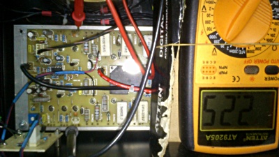

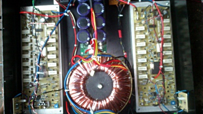

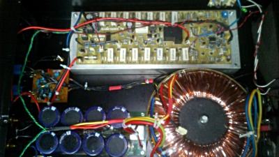

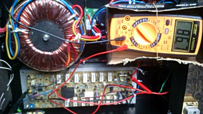

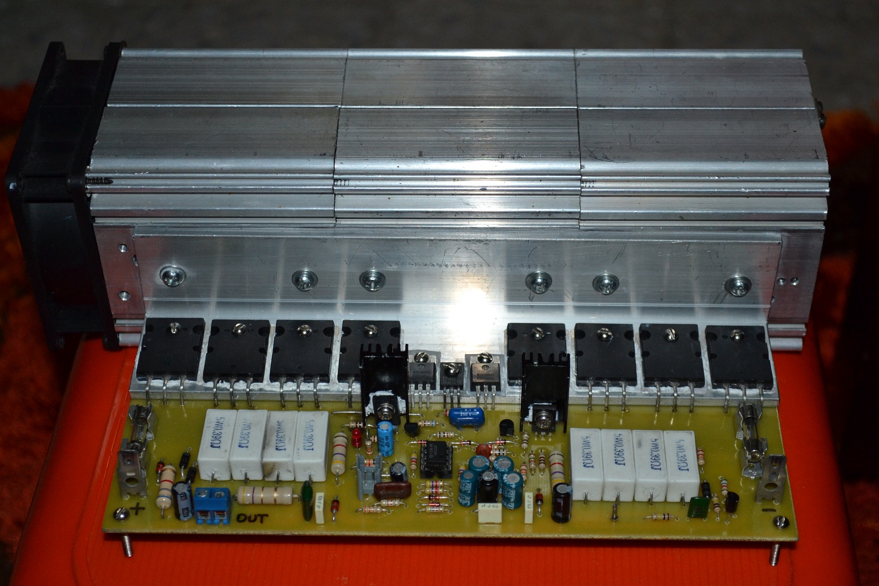

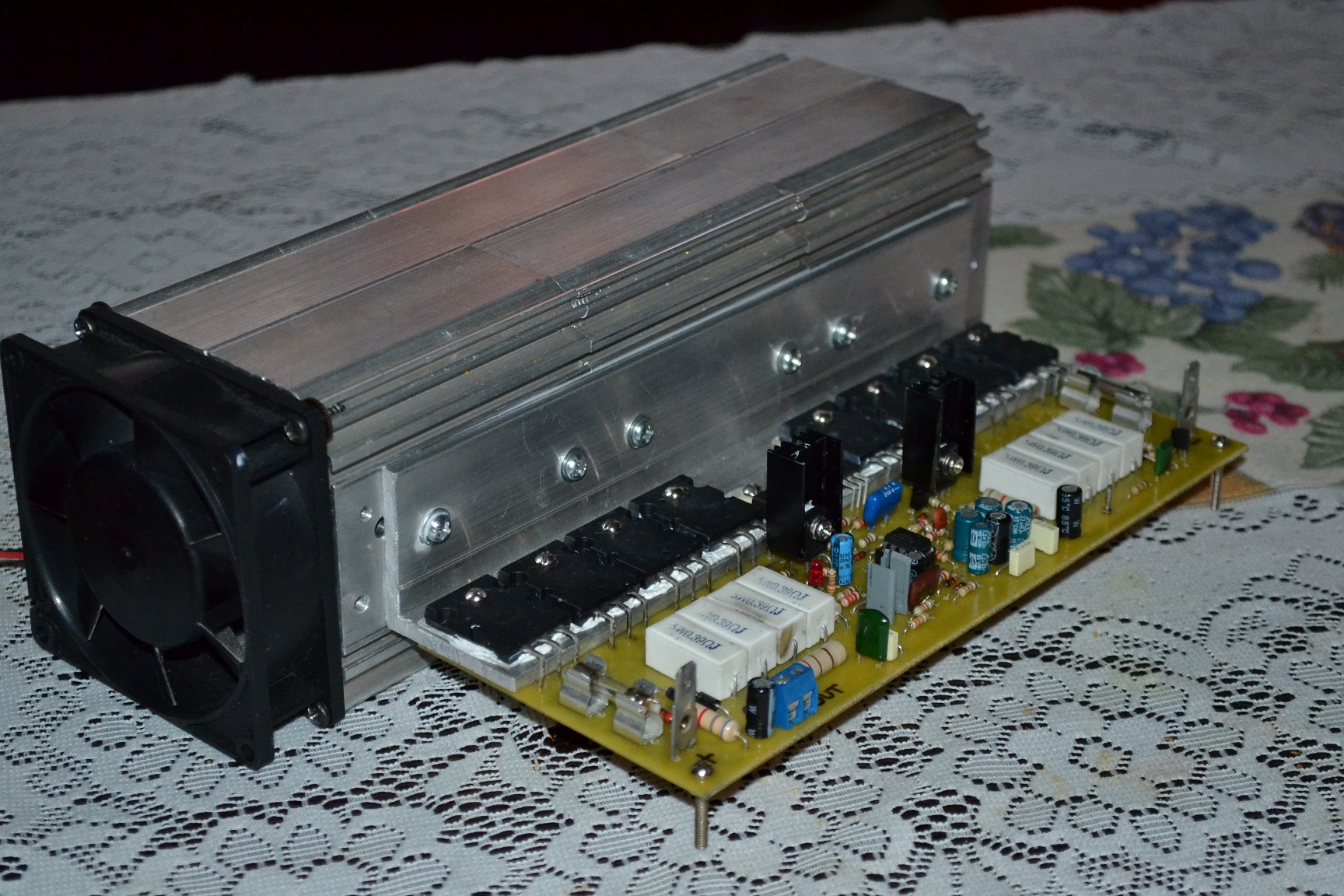

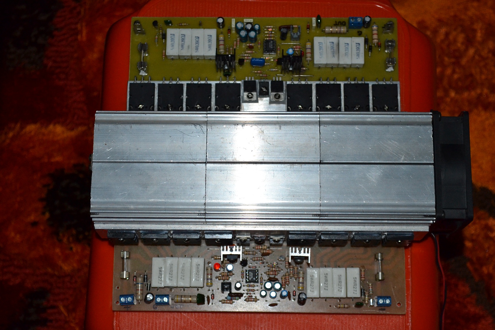

Just for fun!!! My APEX B500 in Vertical & Horizontal

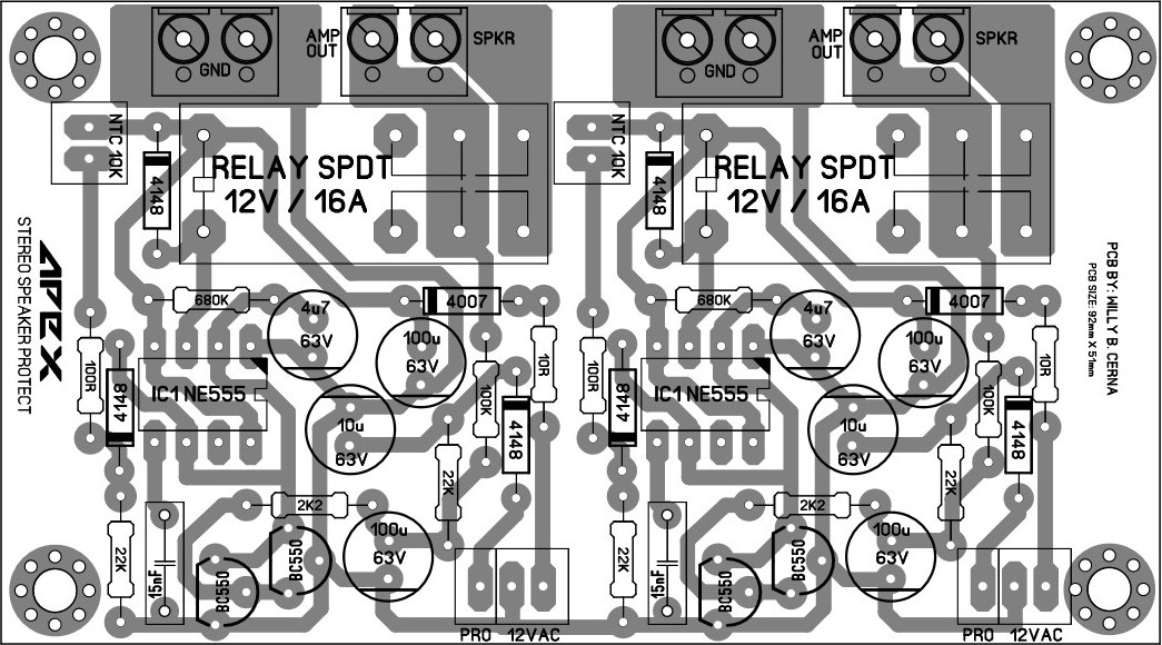

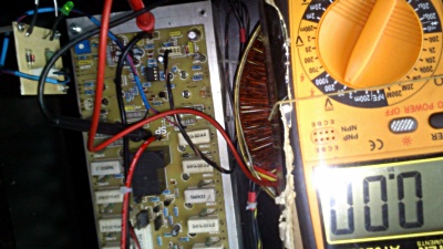

My new APEX B500 in Horizontal position (tested and working) with APEX protect using NE555 IC in progress.
Many thanks to APEX....
