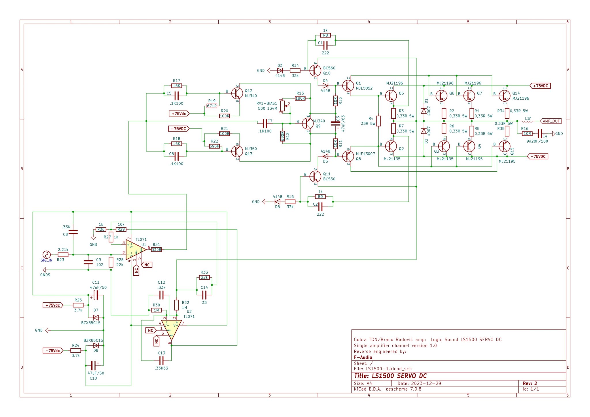

This is actually very old/classic Servo DC idea, and it can actually be reliable like nothing else for driving subwoofers in hard conditions(festivals, idiot owners(night clubs), rave party...). It is crude design and not best amp choice for hi/mids. This amp type must have DC protection in case servo fails.
Sch below is same type amp, but made for professional use and reliable operation, and it does it for 20years min. It was originally derived from some crest amplifier models by reverse enginnering 30+years ago in communist Croatia/Yugoslavia because of import bans on electronics, so they were forced to make equipment by themselves and somehow smuggle motorola MJ transistors into country.

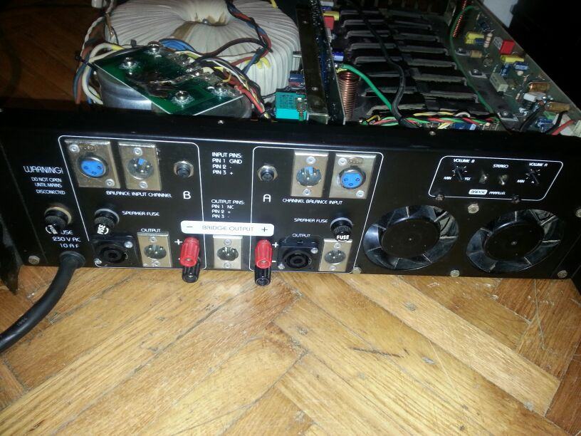

> LS1600 model/variant - internals

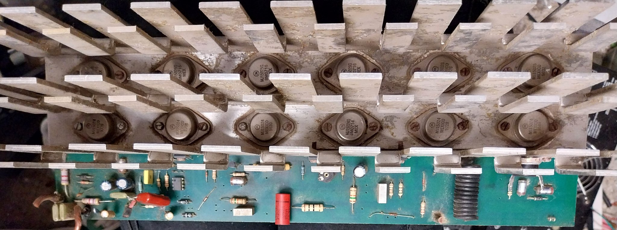

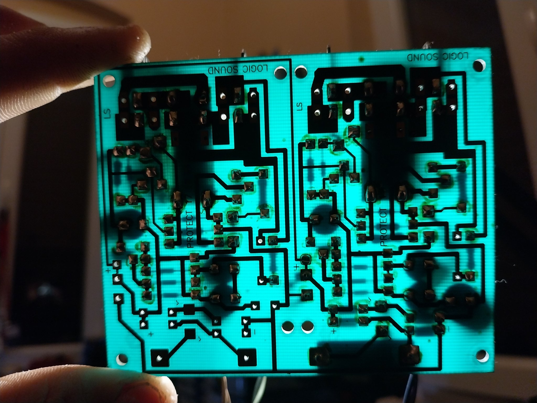

Rather than just try to copy the existing board, work from the schematic and design the PCB around whatever heat sink you might happen to HAVE. It is not all that complex a design, and could even be re-done around the flat pack (MJL) versions of the transistors to make it less of a nightmare to assemble. Add an extra pair of outputs if using flat packs.
Well, your idea is actually good because then I would make driver board which controls output transistors that are on separate pcb, so you can make pcb for TO-3 and another one for plastic packages and just customize it for heatsink you have. Also original board has many flaws like too weak relays in DC protect for this sized psu, no short protection on amp out, no voltage regulator on 24v auxiliary winding to make sure something wont be blown by overvoltage(i once meausered 30V on it!) and this amp doesnt contain single fuse, rail fuses are must have for me, speaker fuse can also save you something if calculated properly. Also this amp uses heatsinks to distribute pwr rails to output transistors and via transistor's screws to many places on board which is not very good solution because between two sinks is 150V DC!! There is no soft start circuit so you can't turn it on because it blows the automatic fuse most of the time. There are some parts on pcb that never had these parts soldered in, and since guy who designed it passed avay we will never know what is purpose and what parts go there so no point to draw these on new pcb.

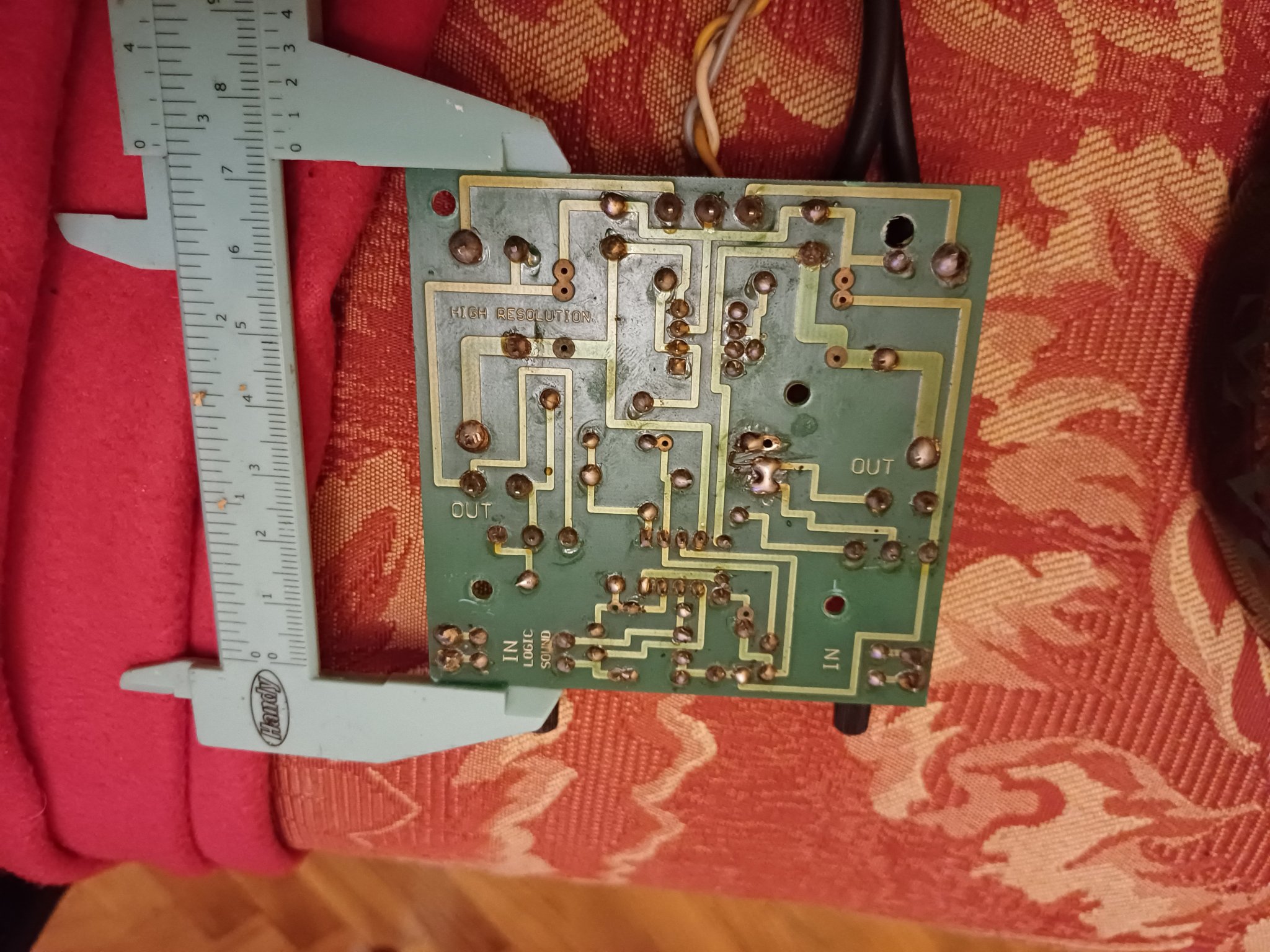

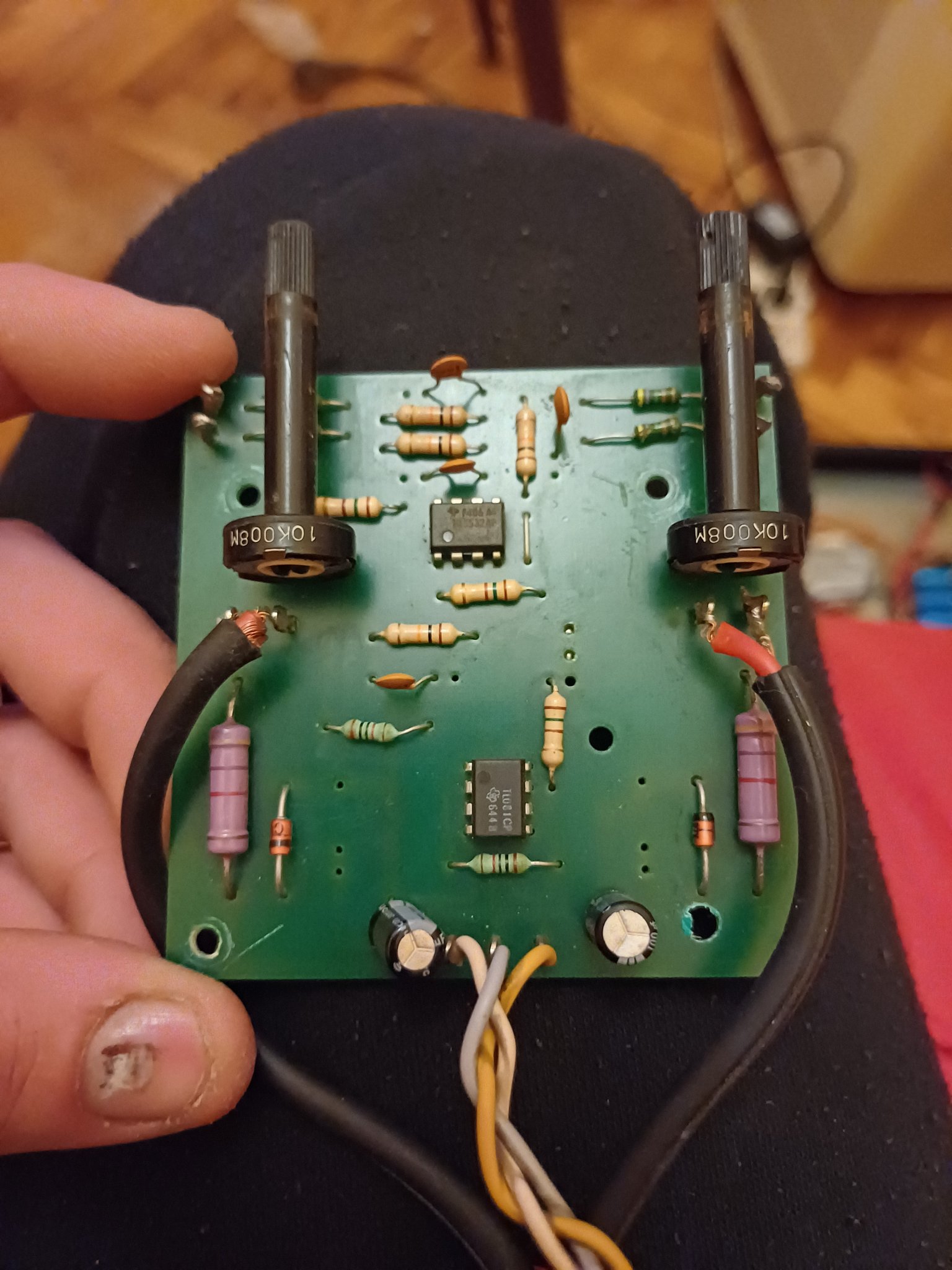

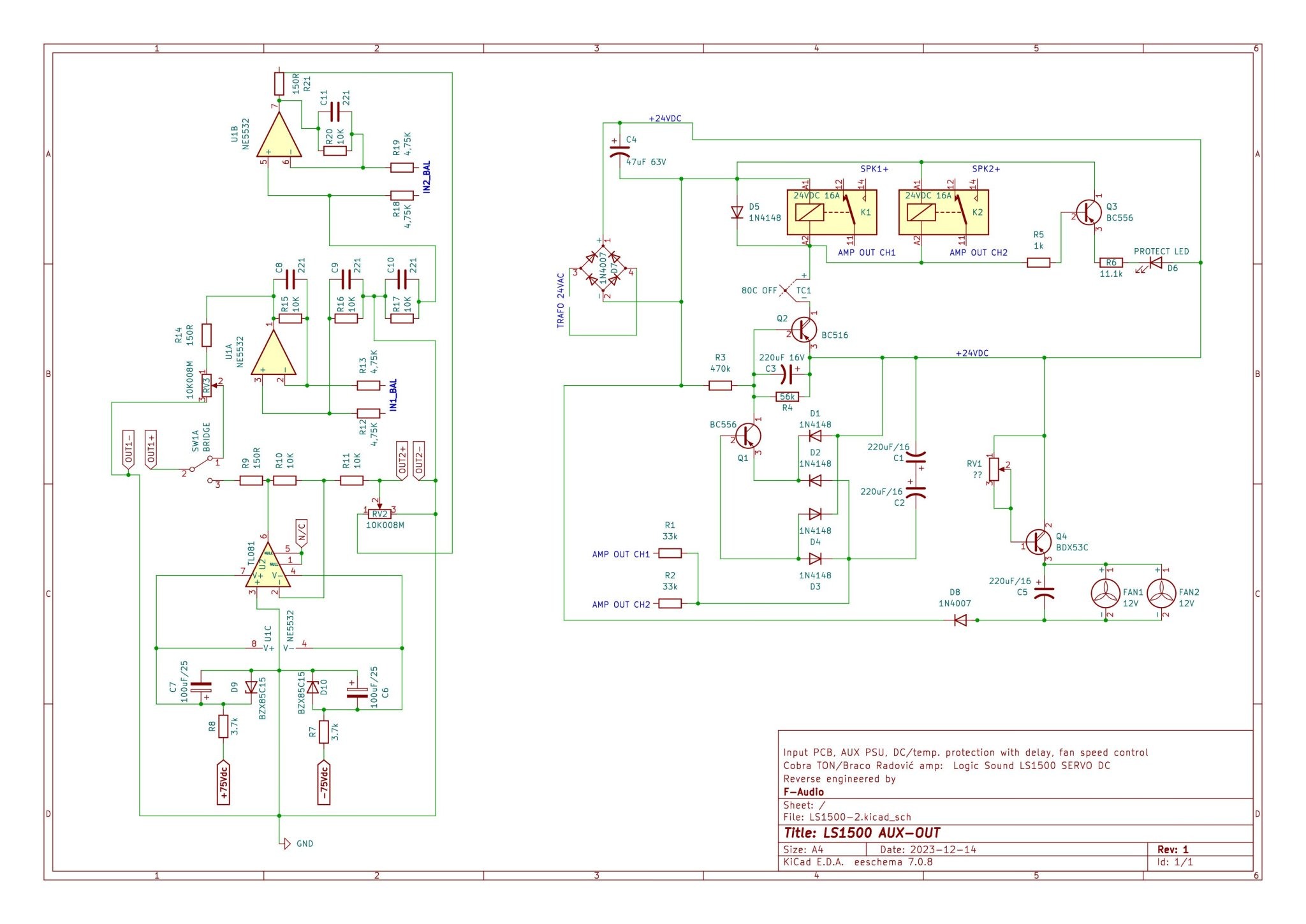

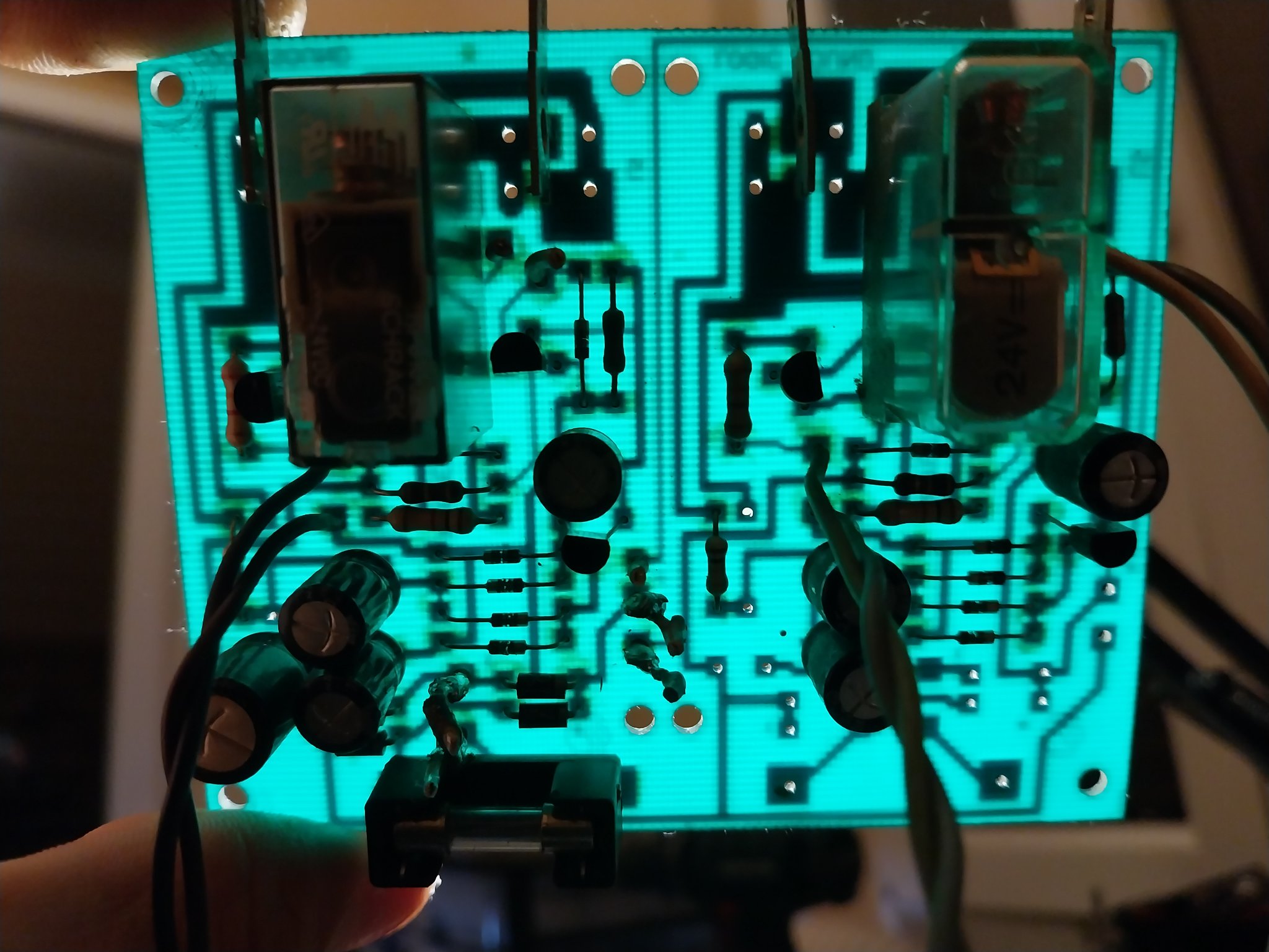

Here is SCH of DC protection, fan psu and input pcb which is used for bridging, volume adjusting and making balanced input sig. unbalanced. Photo of this pcb is below, it very simple and I can confirm that it actually works great(I cloned this board and use it in other projects).

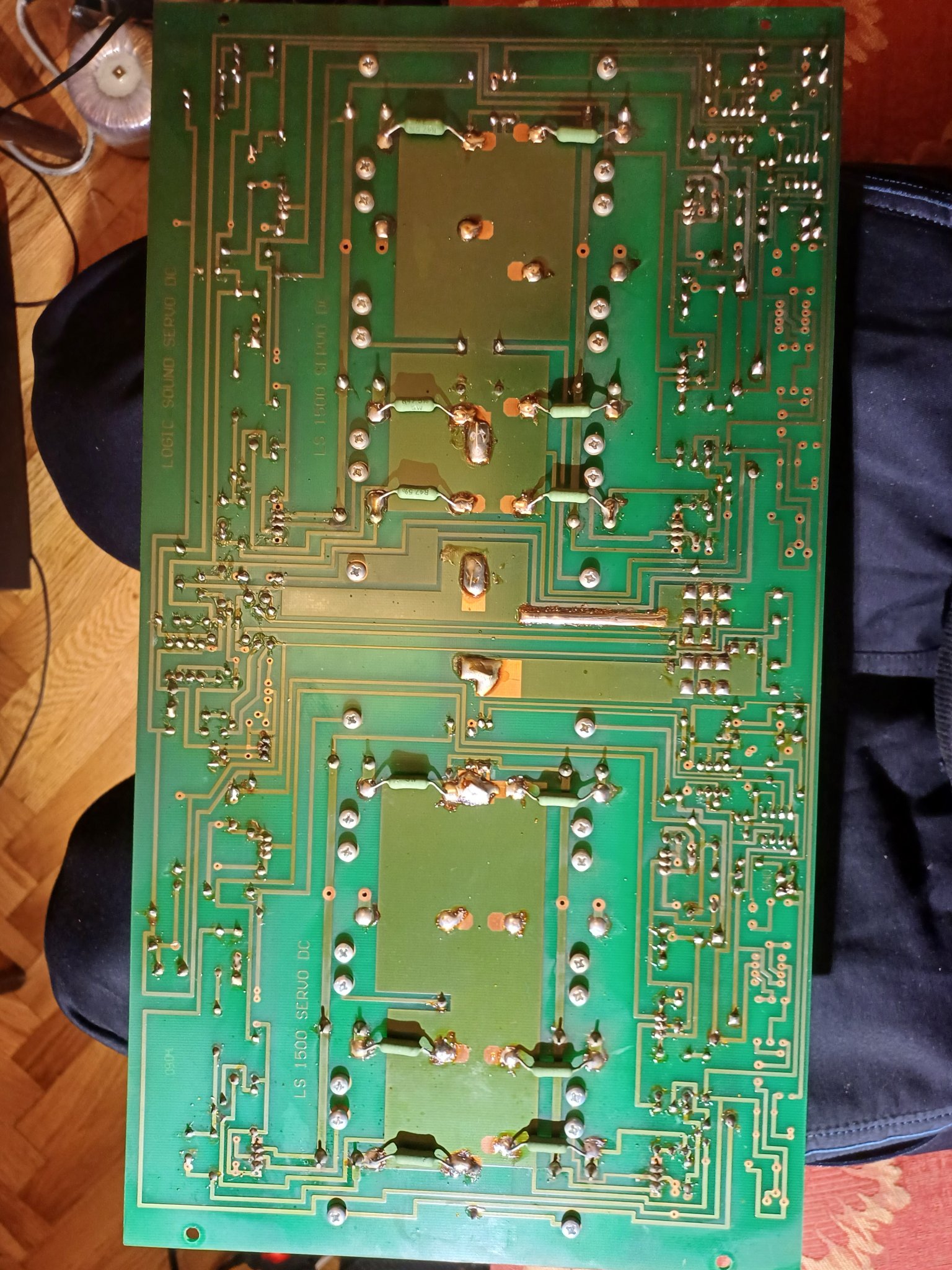

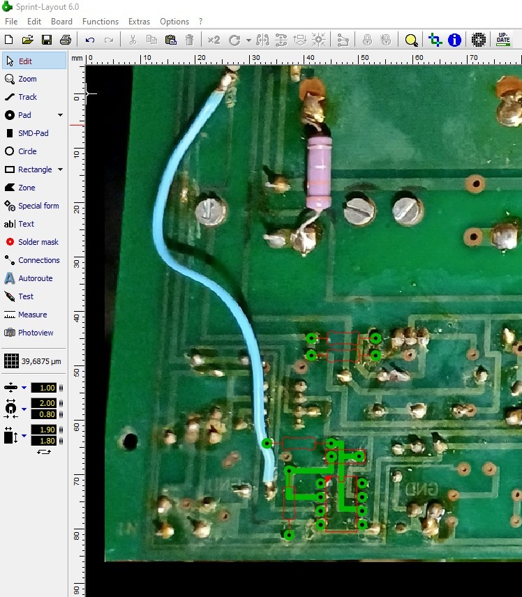

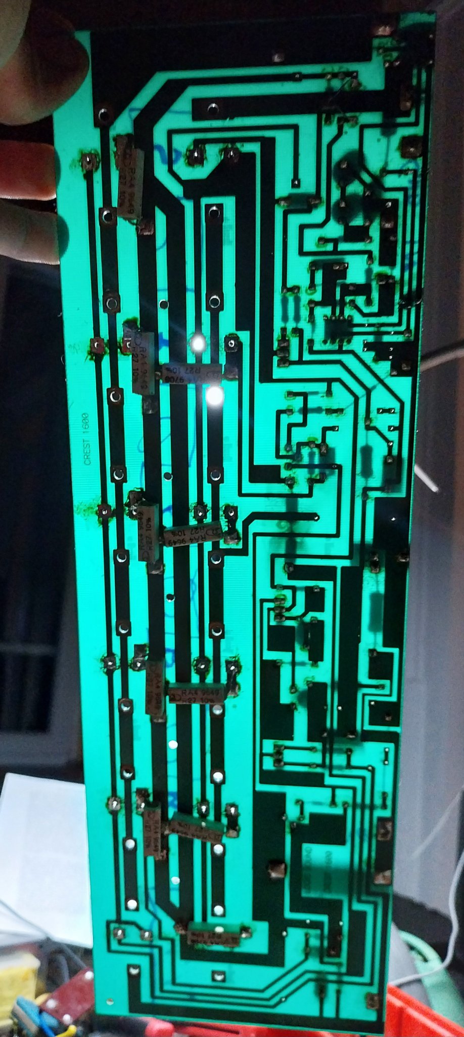

HQ photos of main pcb with no blue jumper wire that I installed because trace was broken.

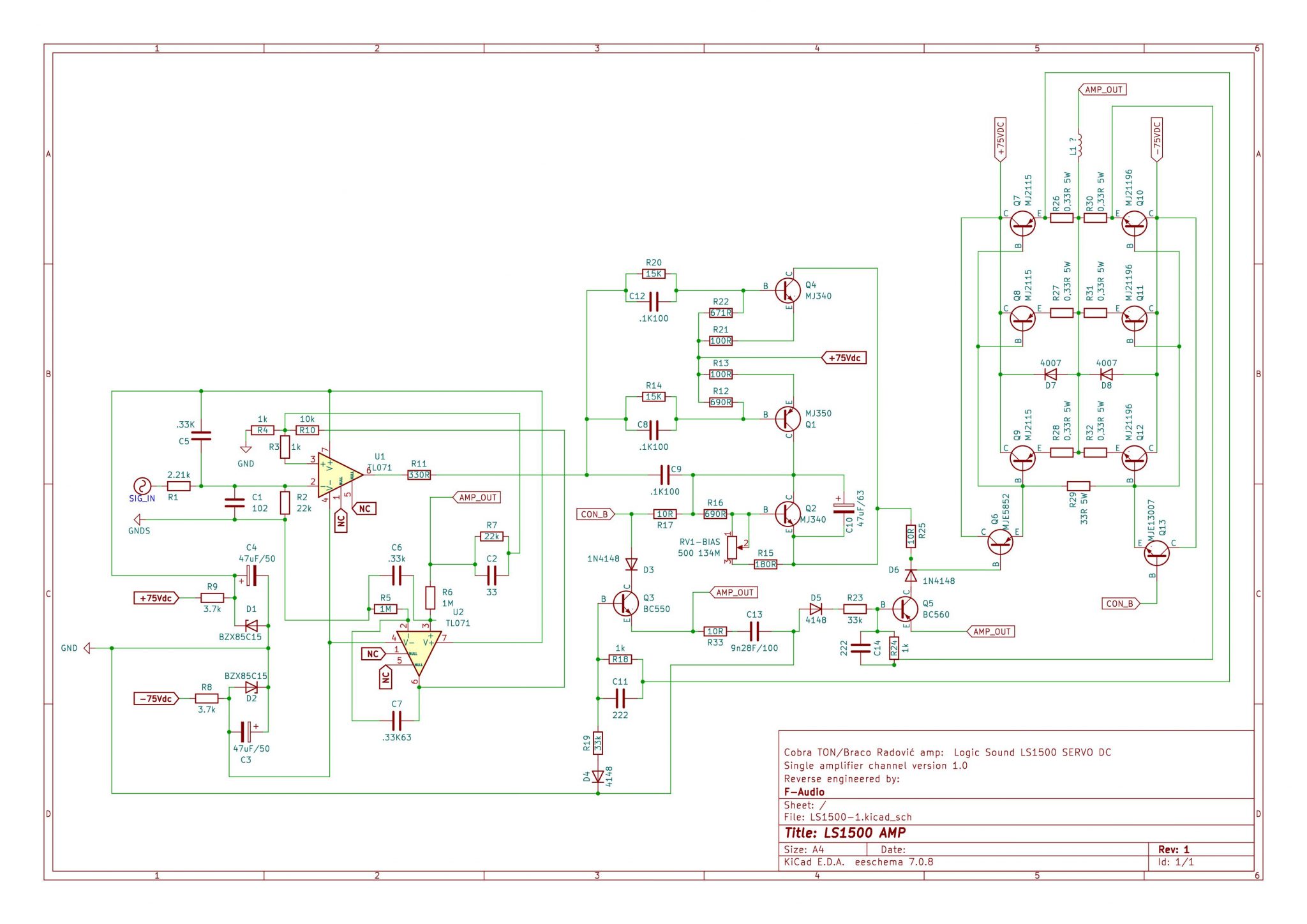

Output bjt's reversed, watch out, MJ21196 is an NPN device, the other suppose to be MJ21195 but number 9 was omitted, please check and correct your schematic.
Thanks for pointing out these errors and sorry for first sch, I have already redrawn this sch some time ago, and forgot I have posted here first version of it. Here is same schematic, but fixed:

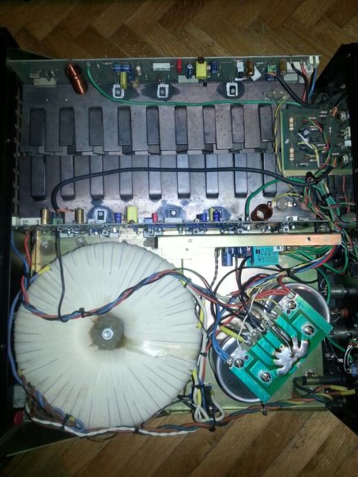

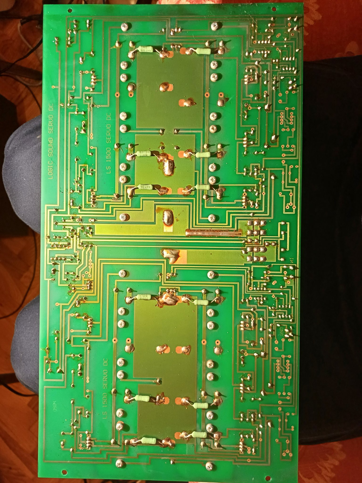

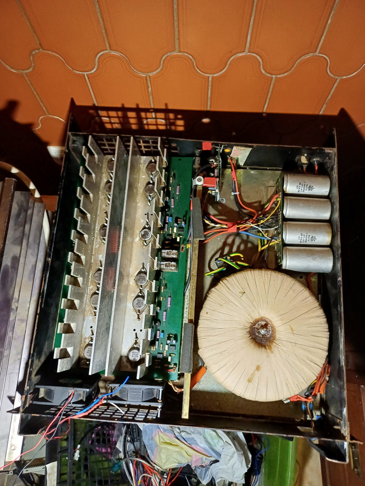

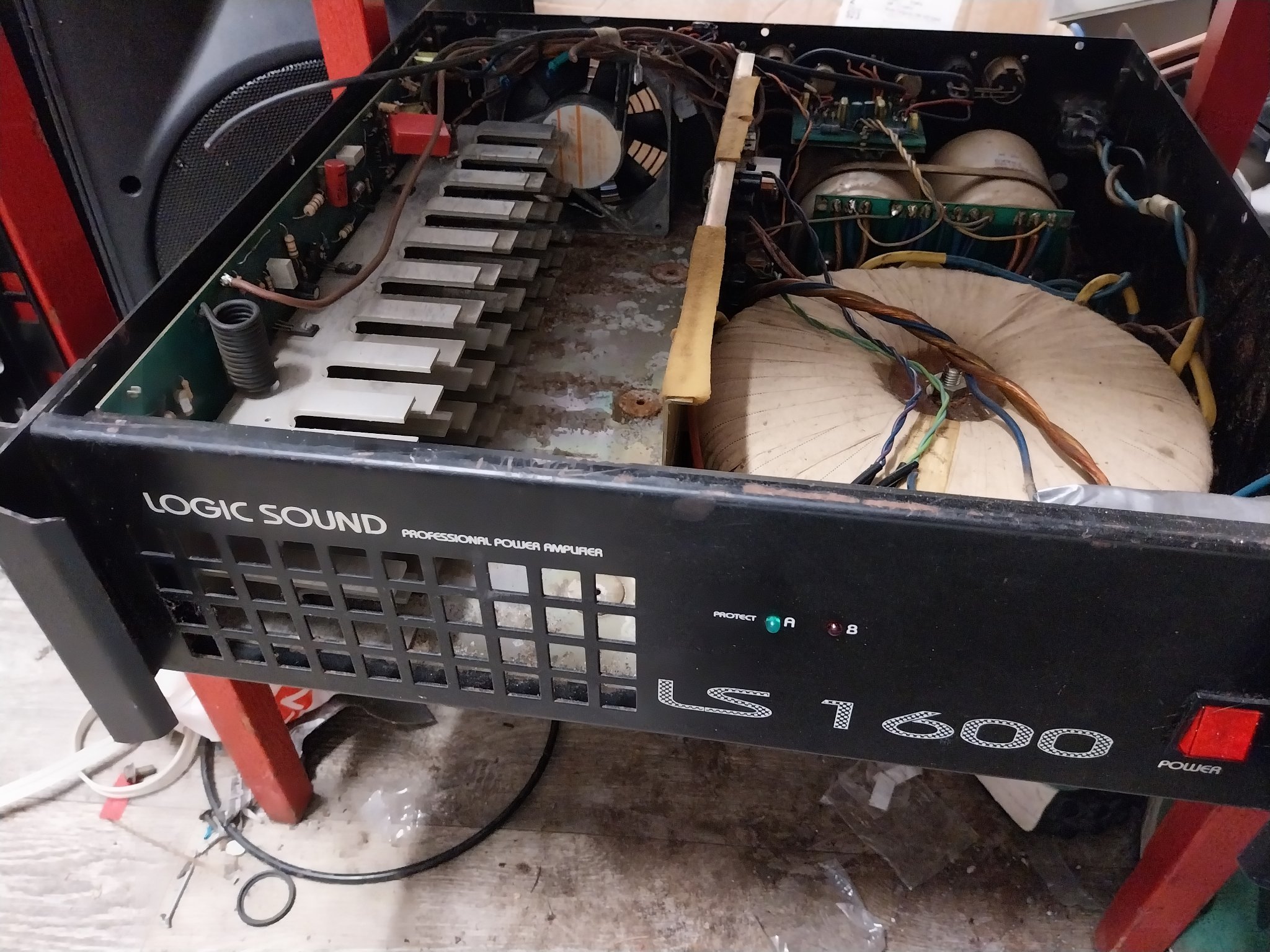

In the meantime, I also finally managed to get one LS1600, to see the differences between variants, and It looks like they changed some things(more simple with one IC and different output transistors driving). Also heatsinks are isolated from voltage and protection is on another board, input pcb seems little more complex, but amp itself sounds harsh especially in hi mid and hi, compared to the LS1000 variant. This one was for subs probably since it is real powerful. Here I give you some photos, if community is interested in this and similar amps I may open new thread for more detailed info. I have many of these old but gold forgotten amplifiers with no info about them on the internet.
