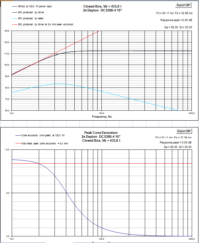

The box - appr. 470 liter closed, inner bracing. Yes, you can call that big, but I made 2x235L boxes
Drivers in serial connection
Q= 0,7
Xmax reached at 120W power at 20Hz
spl 103dB@20Hz or 112dB@50Hz according to Unibox
my project http://www.diyaudio.com/forums/subwoofers/223960-bench-style-cabinet-subwoofer-2x15-closed.html
My costs for the bench sub is roughly 1000€
In the attached graph there is a smaller box, but it measures the same as 470L

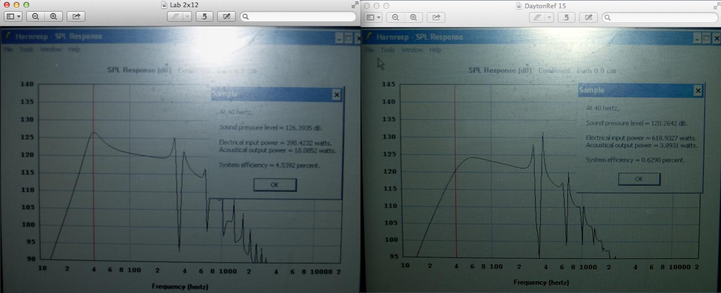

Turbodawg,Huh. When testing my personal 95 db/w/m/2pi Dayton 15" HO project with a high quality stereo receiver that does a bit over 100w into 4 ohms, I was easily able to hard clip the amp when running test tones.
The Dayton 15" HO is only 87 dB one watt one meter at around 100 Hz in half space, and with a 35 Hz tuning in a small box drops in level at lower frequencies from there.
Where are you getting the extra 8 dB sensitivity from?

The very agressively tuned port and the quoted parameters siming different than the quoted sensitivity.
I am quoting the sensitivity peak at 40-50hz, it's at about -3db @ 34hz and -4 db @ 100hz, off the top of my head.
Using the Dayton Reference 15 in a simulation of about 90L net (20x22x16 using 3/4") 2 volt with a 35 Hz Fb does show 95 dB at 60Hz, 91.96 at 40Hz, but only 89.34 at 35 Hz. At 30 Hz it shows 85 dB.The very agressively tuned port and the quoted parameters siming different than the quoted sensitivity.

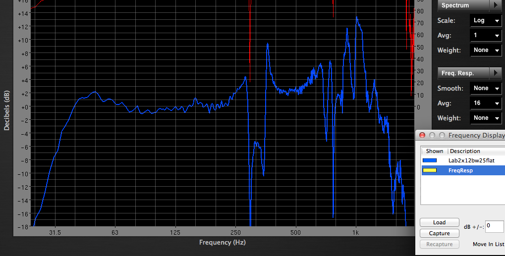

Hornresp is very useful, but it often shows peaks larger than reality, and drooping upper response (or more LF response) than real measurements.
Comparing the real measurement of my Lab 2x12" to the sim, the sim shows the response at 40 Hz to be some 10 dB higher than 500 Hz, while it is actually 2 dB less.
I built the Lab 2x12" before using Hornresp, that peaky port "boom" Hornresp predicts would have scared me off.
If the same holds true for your Dayton Reference 15 in a 20x22x16 35Fb box, it may be closer to 87 dB than 95 dB sensitivity.
Without actual measurement, we won't know what the reality is, but having done the sims myself I know why you think your cabinet may be 95 dB one watt one meter.

All I'm doing is stating my horn resp sim figures, as many other people have done for other projects, as a point of comparison. I have also simmed in WinISD and response is much less peaky. But the peak is right where you want it for a house curve and overall grunt.
I stand by my figures. In WinISD the peak is about 45hz with -3db @ 35hz and 100hz. Hornresp 95 db/2v/1m/2pi @ 40-50hz.
You can stand by your simulations, I'll stand by my measurements🙂.All I'm doing is stating my horn resp sim figures, as many other people have done for other projects, as a point of comparison. But the peak is right where you want it for a house curve and overall grunt.
There are plenty of designs on here that have been simmed but never formally measured. If I ever buy the proper equipment I'll be sure to do it.
Can you post a screen capture of the figures you used in HornResp to sim your design please?
If I get a chance, tonight.
See these two posts:
http://www.diyaudio.com/forums/subwoofers/228434-mth30-questions-complete-noob-7.html#post3345232
http://www.diyaudio.com/forums/subwoofers/228434-mth30-questions-complete-noob-6.html#post3343679
