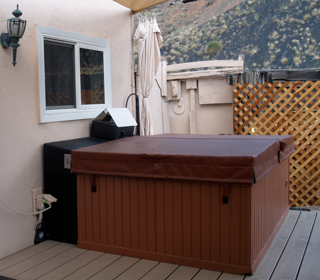

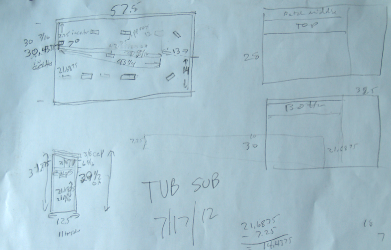

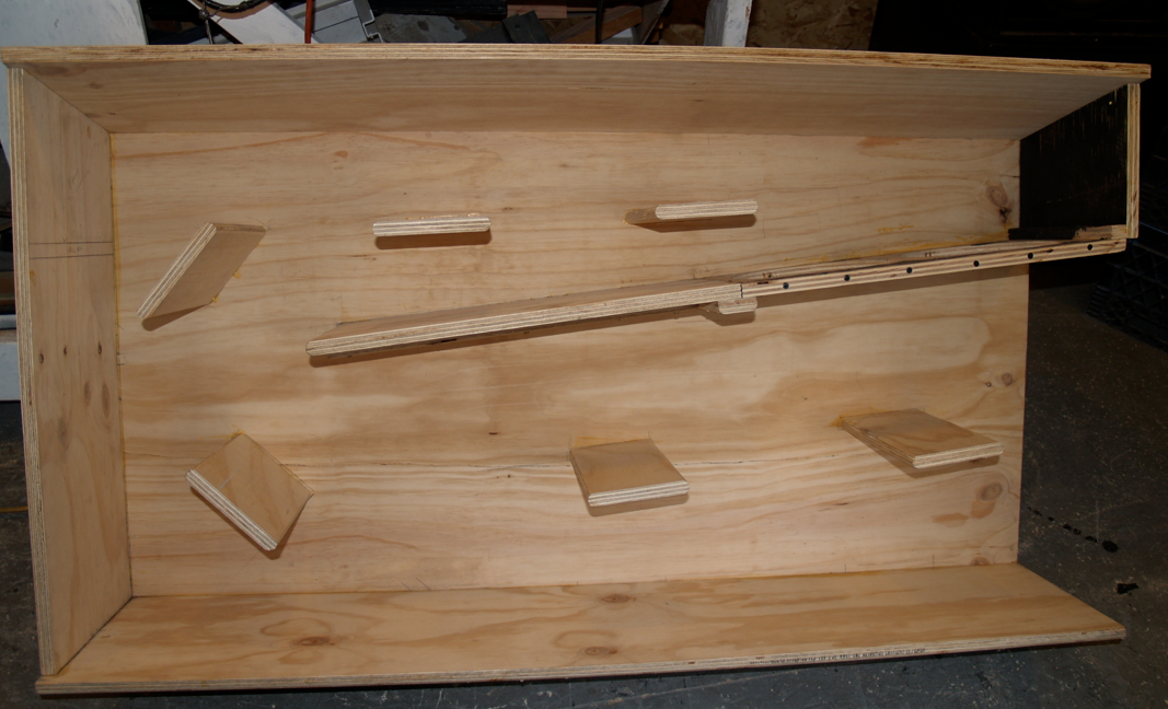

I built a very cheap, decent sounding, reasonably loud, very efficient sub for a lot less than $500. The efficiency opens up many low power (cheap) amplifier options.
The "Tub Sub" was designed to fit in the space that was available between a hot tub and the building wall. Two layers of grill cloth and Duratex paint make it weather proof. The shape would also lend itself to fitting behind a couch or under a bed.

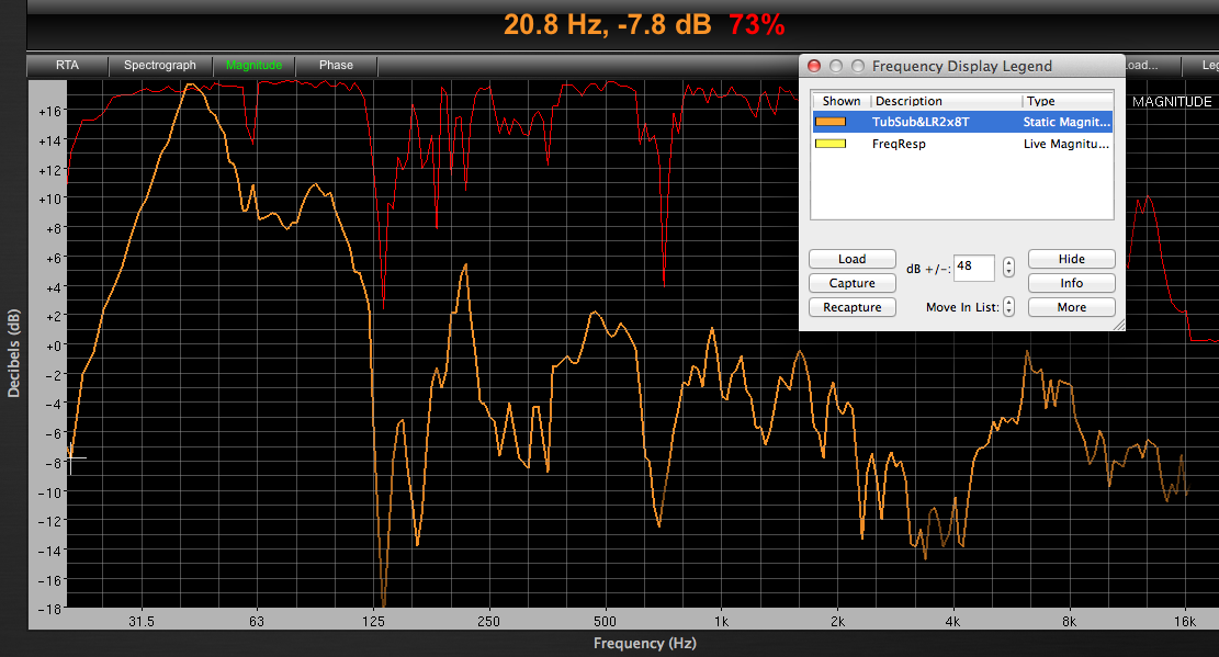

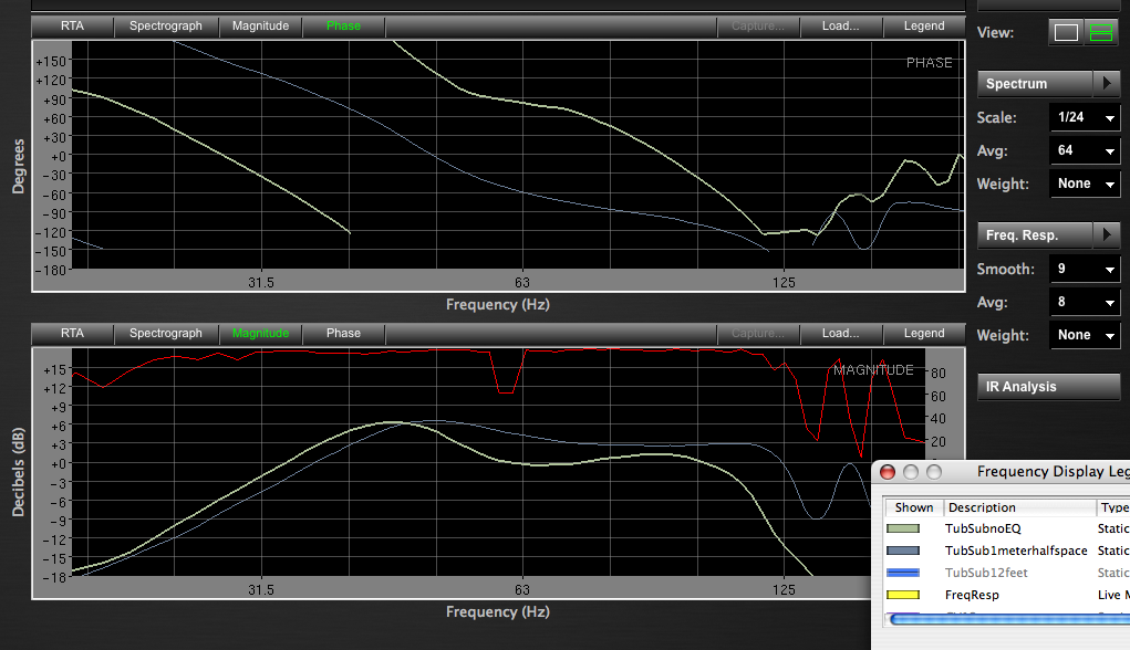

The tapped horn Tub Sub uses two $5 buyout Sammi 10" speakers.

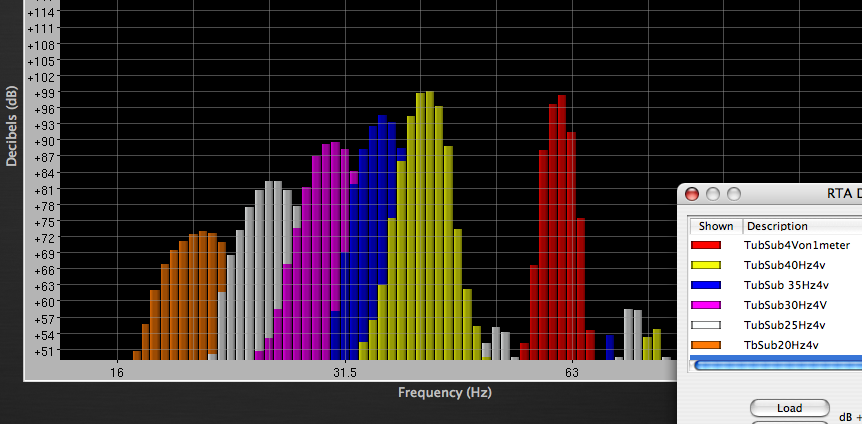

It's sensitivity is 99 dB one watt one meter in half space at 60 Hz (open field) but located against the wall behind the hot tub, 24 Hz is only 3 dB down from 60 Hz, with a "loudness contour" peak at 40 Hz.
The cheapo 30 watt 8 ohm Sammi's are wired in series, 12 volts (about 10 watts into 16 ohms) will hit their 4mm Xmax, doing about 114 dB in half space at that level.
They are wired in series so that the receiver's sub output can also drive the home theater and kitchen sub at the same time without overheating.
The good thing about the speakers is when pushed hard (that would be around 60 watts for the pair), they do not have enough magnetic fource to make them clack or flap.
Although I would prefer to time align the subs, as you can see by the Tub Sub with left and right 2x8T speaker's FR charts, other than a dip around 130 Hz the integration is not terrible. A lot of the peaks and dips are due to the mic placement at ear level instead of ground plane.
IIRC, the top speakers built for the deck integrate a little better, but I lost the files.
If this sub used "real" speakers, it could do some serious damage.
As it is, with about 10 watts driving them I can clearly hear bass lines at my southern neighbor's property line about 800 feet distant from the deck location.
Not bad for $10 in drivers ;^).
