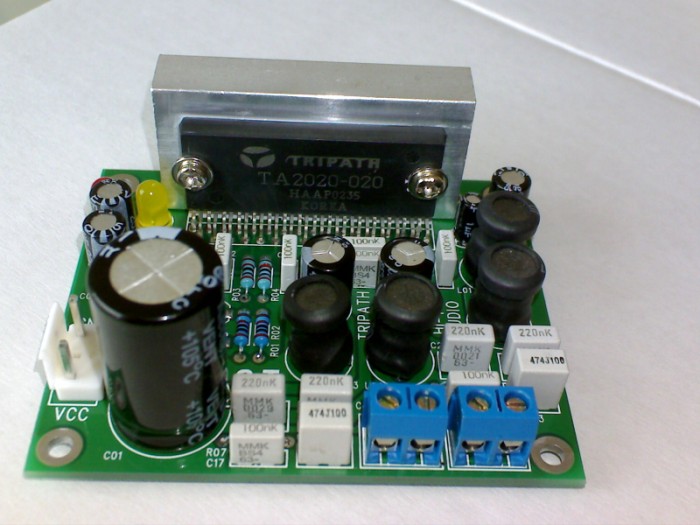

Also i have got the TA2020 board now! this board costs 20 Euro and has 25 Watts from a 12 volts supply, smps are also available. ( 12 volts 6,4 A )

since you guy's asked what kind of amp would be best for on a bike, ive been searching around to see what a efficient small and high power amp could be best suited... ive looked at car amps, but there so hungry you also need a car battery, ive looked at TDA8920 and TA2022 but they need 25+25 volts... not so conveniant ive also looked at classical TDA solutions as the TDA3020 but they lack power and eficancy.
The TA2020 i have in stock here i think can do the job, if you use 4 Ohms speakers. ive got 10 Ohms speakers in my house, and they rock! with this little 12 volts amp it really go's loud! im sure that if you can get high efficent speakers, 25 watt's can be enough for a booming ride.
I can supply these PCB's for 20 euro each, they are stereo and compleatly finished, and have build in protection, weigh a mere 80 grams!! and are of small size! on request i can also supply you with battery brackets for D cells and rechargable D cells
( those cost 5 USD each and are 1,2 V 8 A!!)
i think that is a good solution for a price that can't be beaten!

Just thought I'd comment that I have received 4 boards from Arjen. They arrived very quicly and were well packaged. Arjen (and his girlfriend) is a very helpful and friendly person to deal with too.
Boards are really amazing for the money. I really dont think better bang for buck exists than these. PCBs are surprisingly good quality and the amps sound good - they even come with film input caps (though they should probably be changed anyway).

Last week I was telling the boys at work about Arjen's amps and today they showed up. I received two 2024 boards along with mod kits. They were well packed, Thank you Arjen!
Can anyone point me to posts that show where to put the caps and resisters?
and one more question.... the input has 3 connectors, is the middle one common?
thanks for the help,
Mack
Using the TA2024
Hi there Mack, glad everything is in a good state,
The Audio input is the White connector in the board, the middle is GND, so te common, as you call it and the left and right pins are for left and right input.
The filter capacitors are the larger black tubes with a bubble on them ( there actually a film cap and a electrolytic cap biggy back )
These can be removed and replaced by other input capacitors. ( the yellow ones saying 225 - 400V )
The Buffer caps, Best to remove the 2 caps on the PCB (470uF 25 volts ) so you can eazely solder the wires to the board.
If you can get a hold of some solder wick ( copper wire that sucks up the molten solder ) or a de-solder pump, then you can eazely remove the remaining solder from the PCB holes.
Best is to take some thicker wire, say 1 mm in thickness and solder those to the buffer capacitor if you carefully watch the polarity, nothing can go wrong.
Good luck!
Arjen Helder

Arjen, you reply as quickly to email as you ship goods. Two more questions if I may.
Where do the trim pots go, C9 and C10?
You included several resisters. I can't find a reference to them in the thread.
I forgot to ask you about power supplys. I think I've seen you use 12v 2a units. Are they big enough for these amps? Do you sell them?
Sorry for all the questions.
Mack

Hey there Mack, no worries, here to help.
This is the Mod as described by ElFishi, one of the DIYaudio members from Germany:
Arjen's board:
for orientation put the board in front of you such that IN faces left and OUT faces right.
I use two 10k standing miniature trim pots
One goes right above the IN socket. Its left end is soldered to the ground rail, its right end is soldered to the left end of C17.
The center pin goes to the left end of R5 via a 1MOhm resistor.
The second pot sits right under the IN socket. The left end is again soldered the the ground rail. The right end I connected to the right end of the first pot via an insulated wire.
Center pin goes to the left of R6, again via a 1MOhm resistor.
You can find this information on Page 21 of the sure boards thread
Powersupplies are available, i have now got 12 volts 2 A and 12 volts 3 A the 2 A is 10 euro and the 3 A is 12 euro.
With the 10.000uF buffer caps, not to worry, plenty of juice to go round! if you want to test for that, use a oscilloscope on the power pins, and play loud music with the PCB. if you can see large voltage drops, power is insuffiecent.
If you like it loud, i do suggest some kind of heat sink to the top of the IC. ive used 2 component glue for that before, to a small piece of aliminium. works like a charm.

Tilroh Wrote: Where do the trim pots go, C9 and C10?
Did you check the DC offset on your boards.?? You may allready have a low DC offset & not need to install the trimmers.
You can easily check the DC content of each channel output with a multimeter. You should do this with no input & measure at full volume.
Typically my 4 boards were all in the 12 > 25 mV range & I considered these not worth modifying in this area.
Tripath specify a DC offset as typically 50mV, maximum 150mV in their data sheet. Personally, in my opinion 150mV is far too high & I would only modify them if over 50 mV.
As everyone has stated, these boards of Arjen's perform very nice with minimal modifications.
