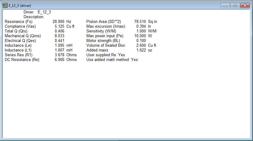

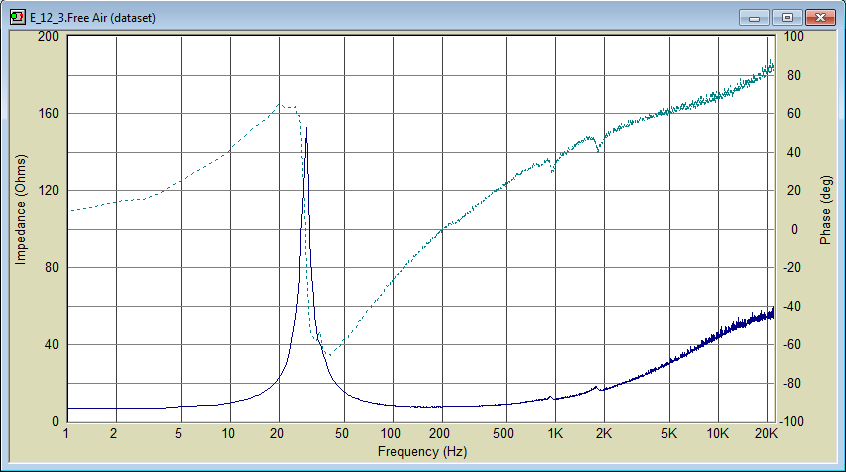

They are all fairly well broken in now and are measuring within 10% of each other. The drop in Qms with the loosening of the suspension is welcome, making for a smaller box design.

Vb=108 liters
port tuned to 33Hz (2 3" dia ports 6.5" long)
Basing my sims on the raw numbers from post #1, I thought I would go with an isobaric alignment, to reduce the box size to a realistic figure. Now that I have better numbers to work with, I have more options to explore.
One idea that is ticking around inside my addled head is using 2 drivers, both in sealed compartments with the lower unit EQed with a Linkwitz transform - a kind of a 3.5 system...possibly. I'll need to do more scheming.
I'm keen on using 2 per box though - I want a pair of hulking big monsters like the Wilson Audio X2 in Ferrari yellow...
DROP in Qms?
Yes, I didn't word that very clearly. I meant drop from the original number, in post #1.
