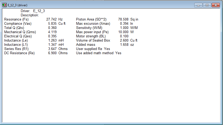

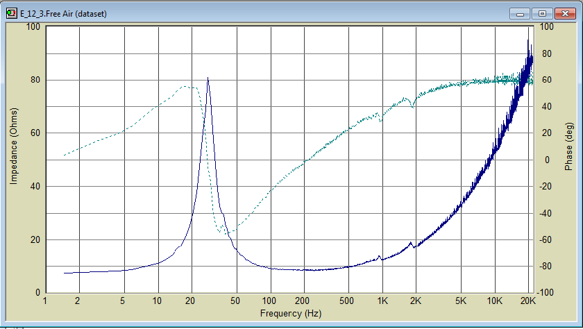

I did some measurements. All 4 out of the box measured fairly close to the specs supplied by Eminence. After running a break in (18hz @5 watts) all night on one of the drivers, I get the following results:
I used added mass (47 grams) VAS calculations and I also used sealed box VAS calculations for consistency.
Free air resonance:
I anticipate all of the drivers will have similar specs when broken in, I just tested another after 2 hours of break in and it's close to the above.
