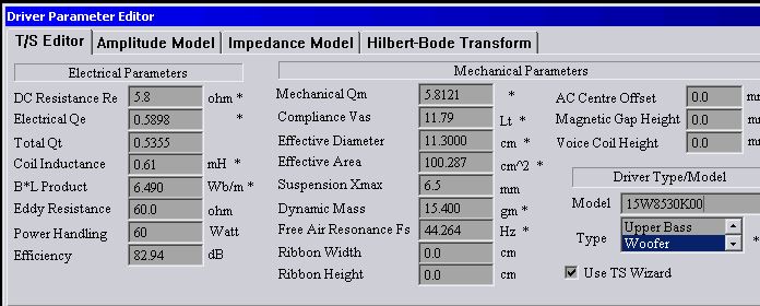

I am completely new to WinISD
Try Googling "WinISD tutorial". There's a good one on the midwestaudioclub site and a few youtube videos plus other sites. There are a couple versions of WinISD, I'm using WinISD 07.0.950.
Note: When entering the driver values into WinISD enter the Fs and Vas pair or the Mms and BL pair, but not both pairs. When you enter one pair of values WinISD will automatically calculate the other pair. If you enter both pairs WinISD will complain when you try to use the driver because your entered values don't exactly match its calculated values.
I could not see the T/S parameters for the W15/8530K00 on Zaphaudio, so I used the manufacturers figures instead.
I always have trusted Zaph's measurements more than the manufacturers. It's listed under the 5.5" Driver comparison section: LINK. I attached his measured values.

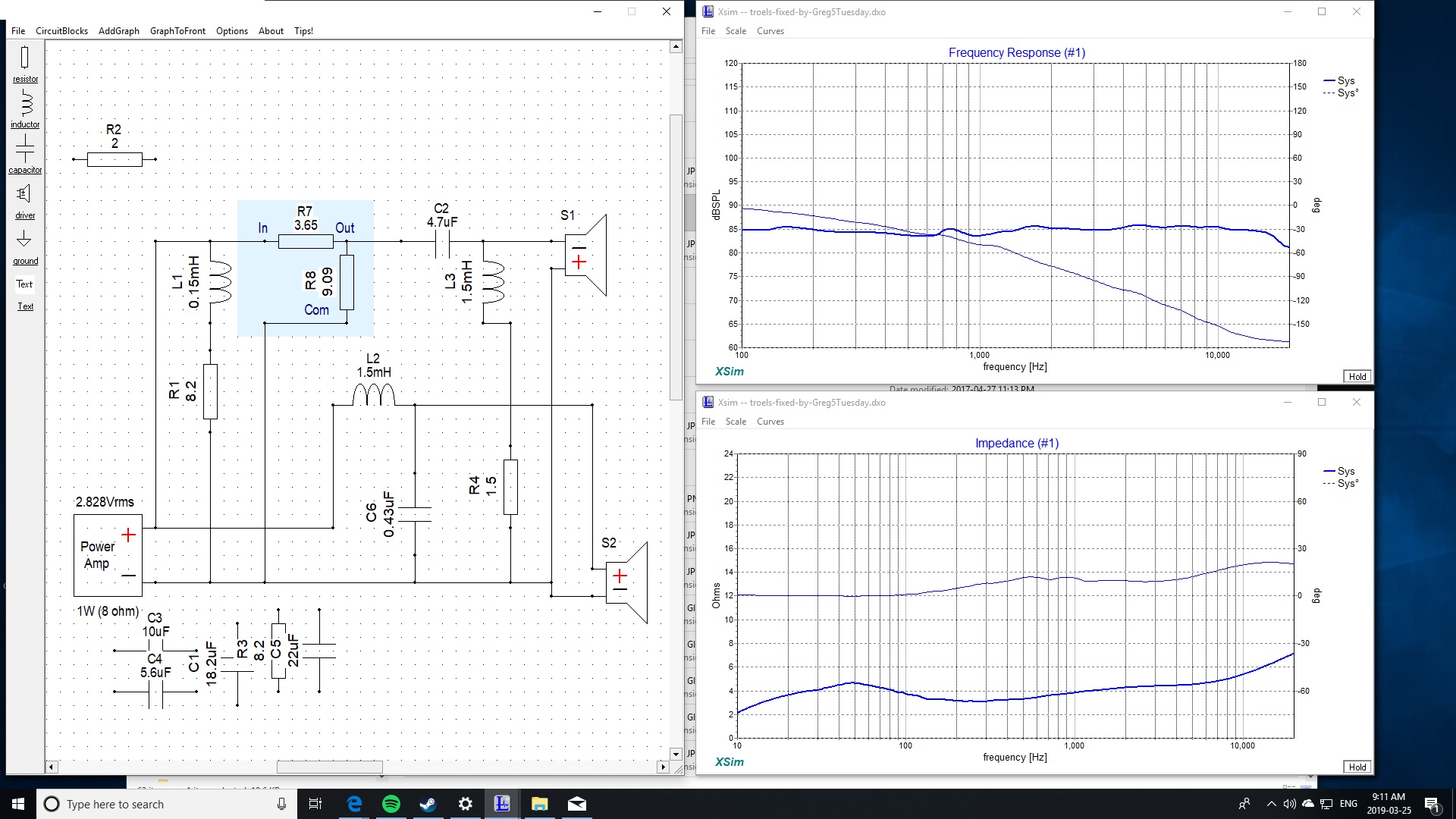

As you have a different tweeter my crossover won’t help you. Just a coil on the woofer anyway. The tweeter had a few more components.
X-Sim is not that hard to figure out. It is a free download.
Some say the driver FR and ZR curves should be measured in the box you intend to use. I’d like to be set up for that. I have tried to see what kind of final system response I get using the components Zaph uses for the drivers I have and also another guy who uses the same drivers. Their component choices don’t give good FR or ZR curves using the driver curves I traced from the Scanspeak spec sheets. But my speakers sound fantastic.... to me.

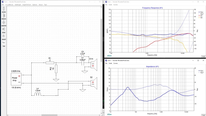

Sorry I’ve not posted my crossover yet. The one I initially simulated had a very slight lift through all the frequencies above the crossover point of 2.5khz. I was convinced that it was what I liked but it sounded too hot, bright and edgy to my buddies. I love horn/brass music that shreds your ears. Or I thought I did until I bought some Sonus Faber Venere 3.0 as a reference speaker to compare my DIY stuff to. Even this Sonus Faber which is brighter than their more expensive classic lines was way more ‘polite’ than my DIY Scanspeak speakers. So I hit the X-sim again and made the response pretty much flat. What is amazing is how flat the impedance curve is too. My Arcam AVR-350 simply cannot drive the Sonus Fabers in a controlled manner but the Scanspeaks love it.
And yes I love the Scanspeak sound. It is much warmer than the Sonus Fabers that were a lot of money... even as a pre-owned purchase.

I see, so these graphs are the outputs from x-Sim, not the curves you have traced? I am yet to try x-Sim, so hopefully it will become clearer when I do.
Have you any tips about tracing the manufacturers curves? What software do you use?
Thanks again in advance. Verona
