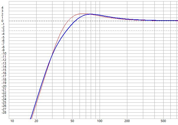

What is your baffle width? Paul's design uses an 8" W X 14" H baffle. If your width is close to 8" it should be OK.
Going from 0.5 ft3 to 0.38 ft3 doesn't make a lot of difference if you can handle a longer port. I used the 15W8530K00 T/S parameters from zaphaudio and used WinISD for modeling. I first modeled the 0.5 ft3 cab (red trace) which matched Paul's results (43 Hz tuning, 2" X 7" port) almost exactly. I then modeled a 0.38 ft3 cab (blue trace) with the same tuning of 43 Hz. The only real drawback is the port length increases to 10.5" which may be hard to fit in the cabinet.
One possible option is to use a 1.75" diameter port which reduces the port length from 10.5" to 8". This will increase the port velocity which may cause audible "chuffing". For a 100 dB output WinISD gives a max port speed of 27 m/sec for the 0.5 ft3 cab using a 2" port. For the 0.38 ft3 cab it gives a max speed of 23 m/sec for a 2" port and 30 m/sec for a 1.75" port. These are all pretty high values, but so is the 100 dB output.

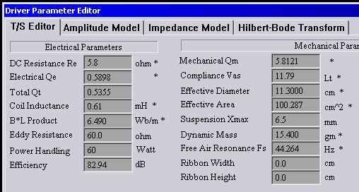

I would guess you're using the Thiele/Small parameters published by Scan Speak and not the parameters from Zaph Audio. I've always had better results using his measured parameters than the manufacturer specs. And using Zaph's parameters matches the tuning frequency and port length from Paul's website.
Unless you already have the cabinets built I would recommend sticking with Paul's cabinet dimensions and volume. I have heard the Carreras and I would deviate as little as possible to keep that marvelous sound. YMMV.
