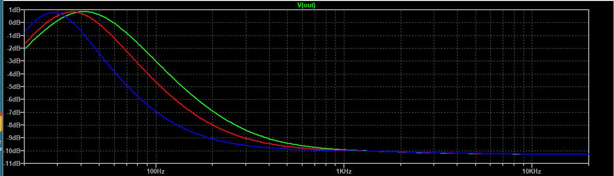

I would recommend modelling these rather simple circuits in LTSpice and you will get a clear (graphical) overview how the unit behaves when regulator(s) are in limit positions. Also "fooling around" with component values is easy in a computer compared to testing them on breadboard.I don't know much about how tone controllers work but I want to DIY one for my amp.

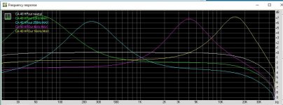

Regarding the initial idea to have 5-band equalizer - the frequency response will be quite "bumpy".
If that is not a problem, then it will be fun to play and learn with.
Something like this - only the central 1kHz band notch is missing - the band was defective when taking measurements.
