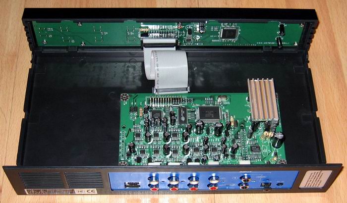

I was doing some searching for dts decoding, and i ran across a product utilizing that chip, and in the review of the product they stated which chip it uses, etc ... so that's how i got the link
The chip type you mentioned is right, BUT:
Nevertheless, You will have to download application code into the chip to do the decompression. And I doubt that application code for windows will work in this chip.
Another problem I see is that you won't get these chips as samples, or even, you can't buy them without having a dolby/DTS/whatever license. I tried it a few months ago and got this answer from Cirrus...
Life isn't simple, ain't it?!?
Greetings from Germany
KMT
KMT
