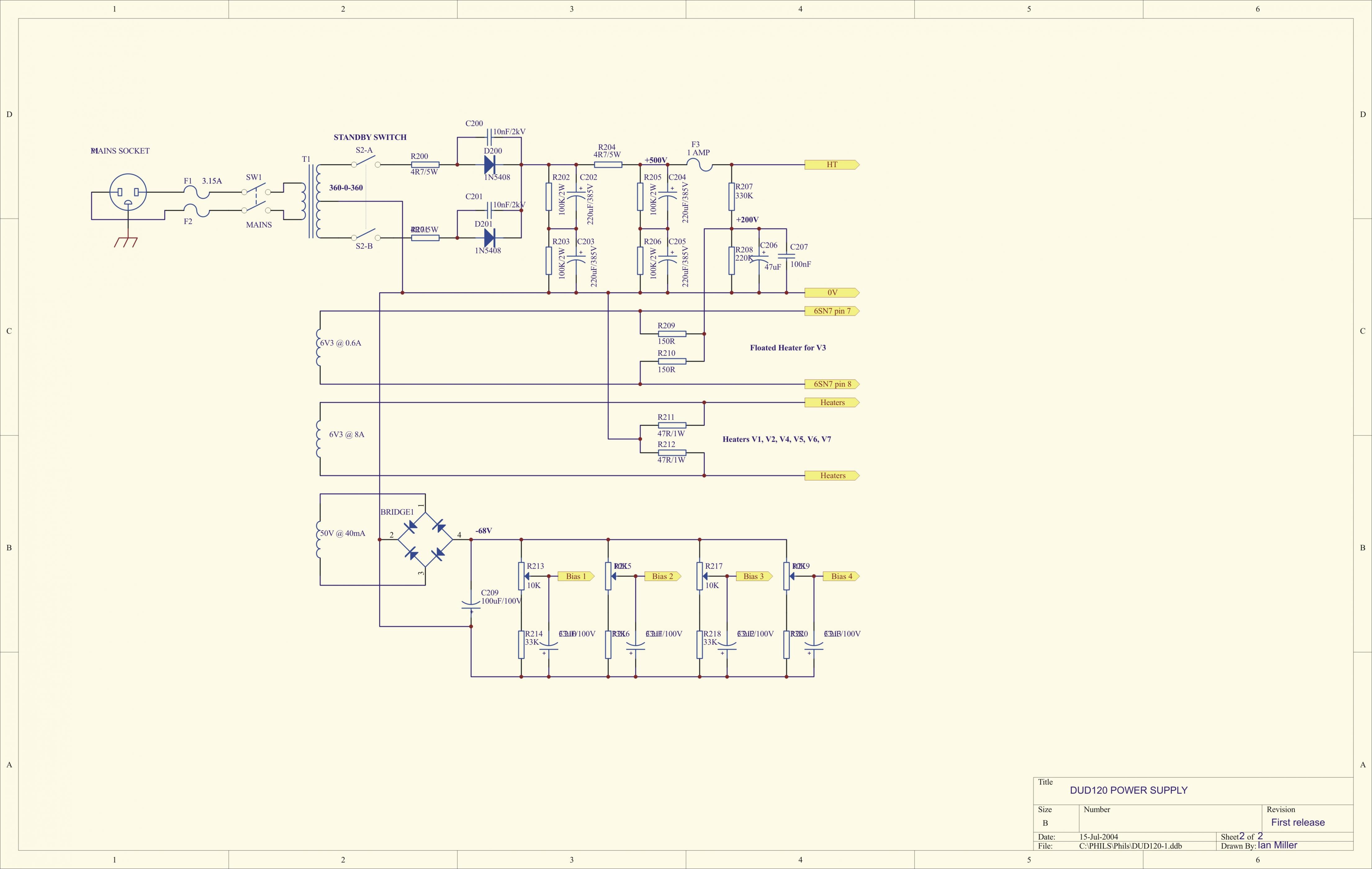

4xKT88 into Hammond 1650T, what am I missing?
These are from something I did 10years ago (or more).
I would probably do things a little different today.
The document is some notes on the design and some test results.
The pdf is teh amp schematic.
The jpg is the power supply schematic.
"DUD" is a bit of poking fun at myself - stands for "Down Under Designs".
Ian

my power amps are just based on more traditional GEC multipair 400watts,
whit valves power supply for Hi-Fi, sound beautyfull.
only the power supply its different from Woodville schematics.
450/0/450VAC supply 4X 5C3S (5U3C)
the main choke its 5H 500mA for +B 530V a rest and 480V a full power,
it was too small for choke filter so i need to put 47uF/900V (conbination =// of 4X 47uF-450V) on head before and two siemens 390uF/450V // (195uF-900V) for +B , followed by 20H 100mA for 450V +B2 splitter and 10H50mA for 250V +B3 class A input tube .
for -B G1 silicon bridge and BC 200uF/200V and Roderstein 470uF/100V.

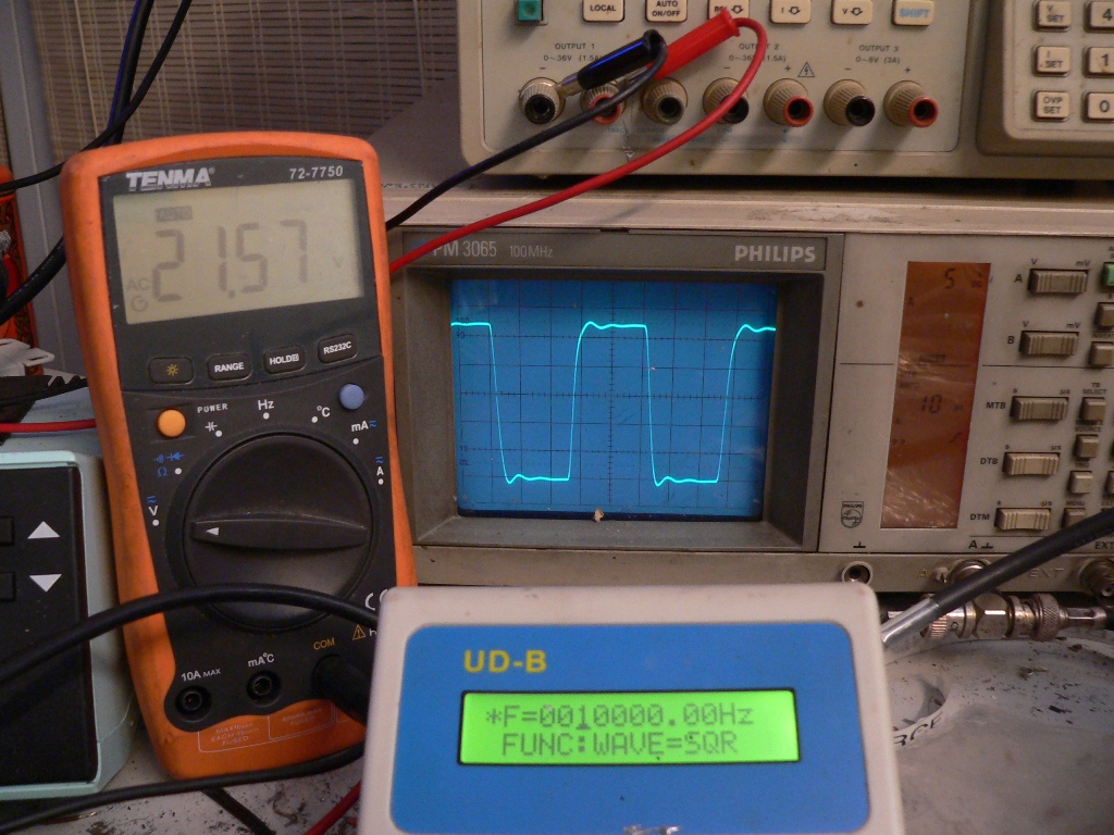

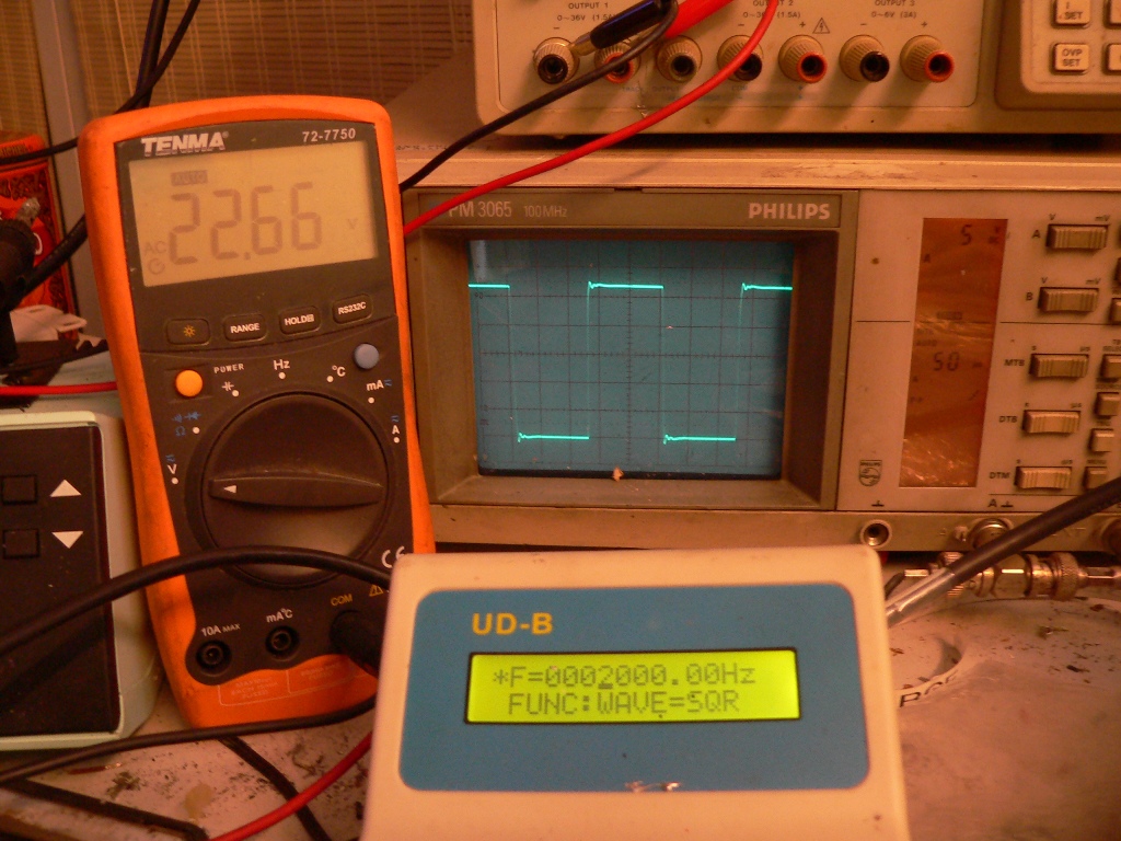

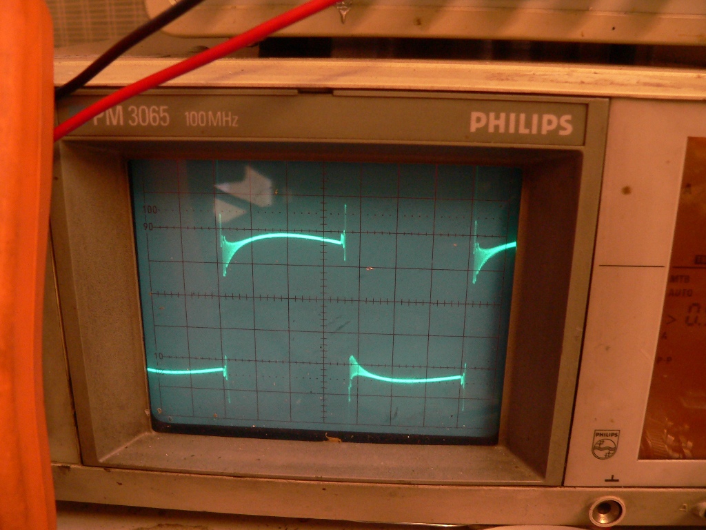

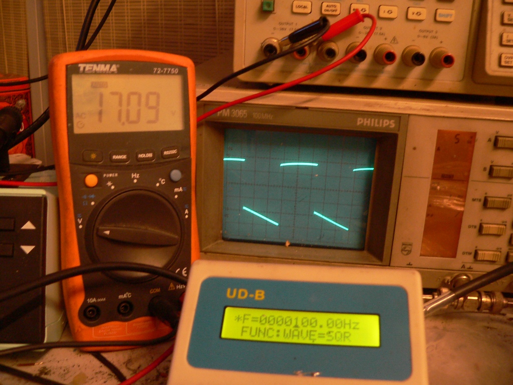

i like very much the splitter for yours amp, can you develop please, any measurement photo a low frequency below 100 Hz???
my next amp will have different splitter, the GEC cathodyne its a little poor!
That ringing on the 100Hz squarewave...is a sign of trouble and requires a bit more circuit examination, esp the schematic. Even the 30Hz on the tips is suspect.
this RINGING come from FLASH CARD RECORDER not from the amp, just for
the last two photos are from balanced line bypassing input and splitter,
my signal generator only unbalanced output.
difference from unbalanced and balanced 100 Hz its evident
the sinus 30Hz a 50% power supply its much better in balanced mode,
the cathodyne splitter its not perfect at very low frequency
