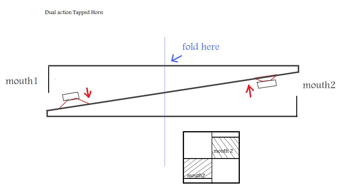

4x15 tapped horn ?

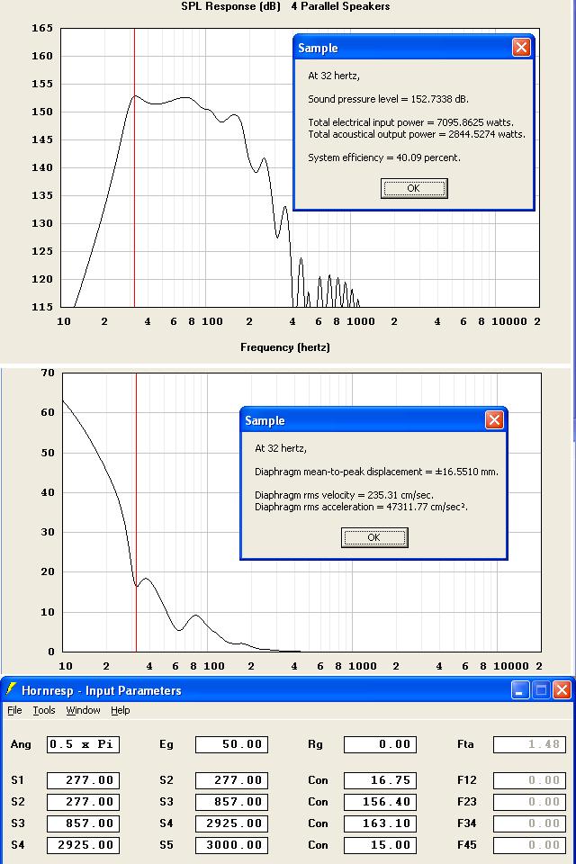

here's a slightly bigger TH. Good for those D-n-B 32hz notes....
Okay so xmax is wayy higher then 16mm and sensitivity is not 89db 1w/1m. but it is still a beast of a sub. I hope you don't plan on moving these around much....with all the bracing necessary for this subwoofer it is going to weigh a TON!! I would use double 3/4" Baltic Birch for whatever horn you decide to build, with very heavy duty bracing.
Also, without cabin gain don't expect these things to do anywhere near 180db....

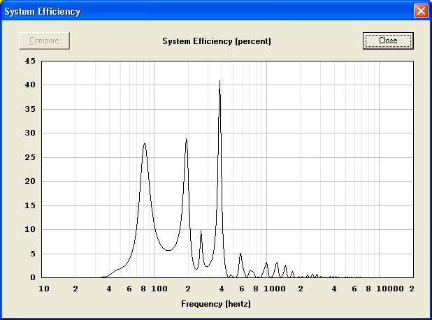

How does this work, jbell?
Hi Bart,
I'm not jbell, but perhaps this might help...
In general terms, the sound radiation efficiency of a direct radiator loudspeaker system is usually only a few percent, whereas the sound radiation efficiency of a horn loudspeaker system is typically between 10 and 50 percent, due to the higher air loading on the driver diaphragm.
The attached screenprint shows the efficiency of the Hornresp default horn loudspeaker system - the maximum efficiency in this case is about 48 percent.
Kind regards,
David
Hi Bart,
Does this translate into a huge reduction in power demands?
It can result in a significant reduction, yes.
If the driver took 1W to produce 88dB, how much power would it take for 88dB in a 40% efficient TH?
Try experimenting in Hornresp to answer your own question - it is the best way to learn about such things 🙂.

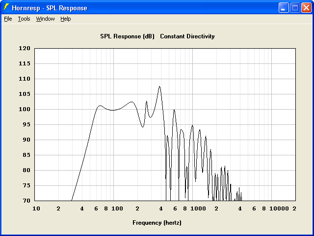

One point to note is that the sound radiation efficiency of a tapped horn loudspeaker system can vary greatly across the passband. The first attached screenprint shows the efficiency of a typical tapped horn loudspeaker. The second screenprint shows the SPL response of the same loudspeaker.
Kind regards,
David
Thank you very much for that, since I didn't learn how to use Hornresp. 😱
I didn't expect such a drastic reduction.
I do find it strange that with an efficiency jumping up and down in the frequency band, that the spl output is quite flat.
